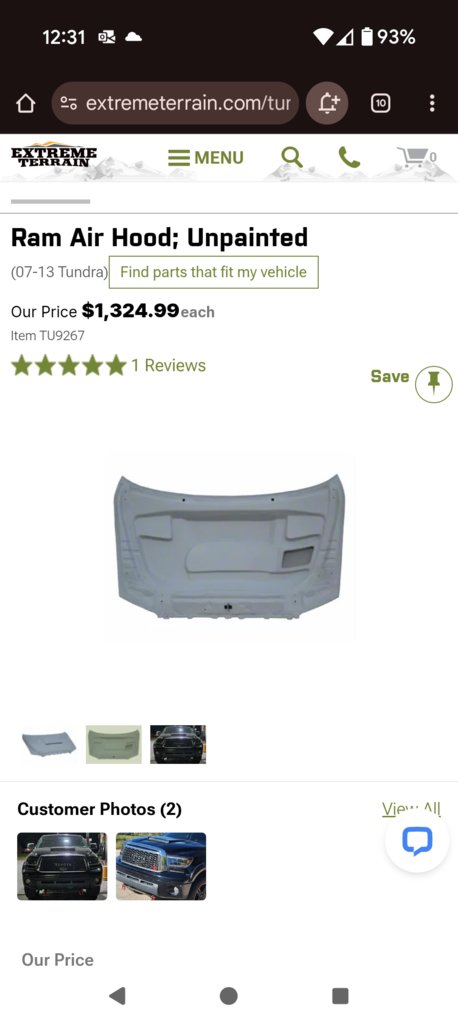

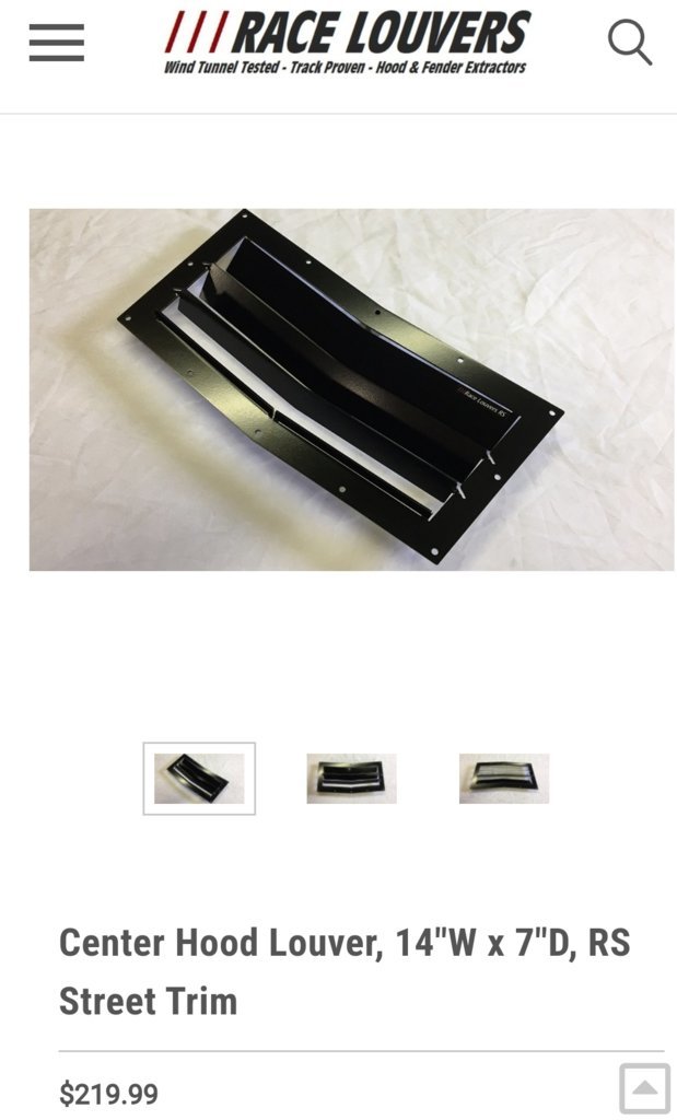

    I was going to do a flush mount underneath. I bought some stainless perforated mesh it's about 16 gauge. Or was looking at race louvers. Funny you mentioned the washer trick to get a cheap cowl hood. My brother mentioned it to me when he was up visiting.
    I may go with the race louver.
    Either 2 4x10 mesh or one centered louver. Still thinking. Just trying to save $$ for other stuff.

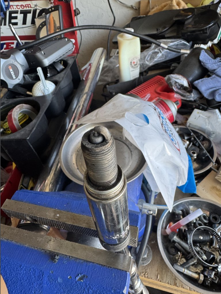

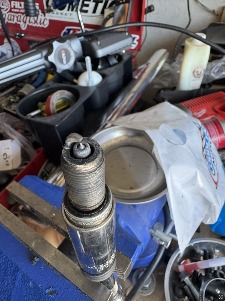

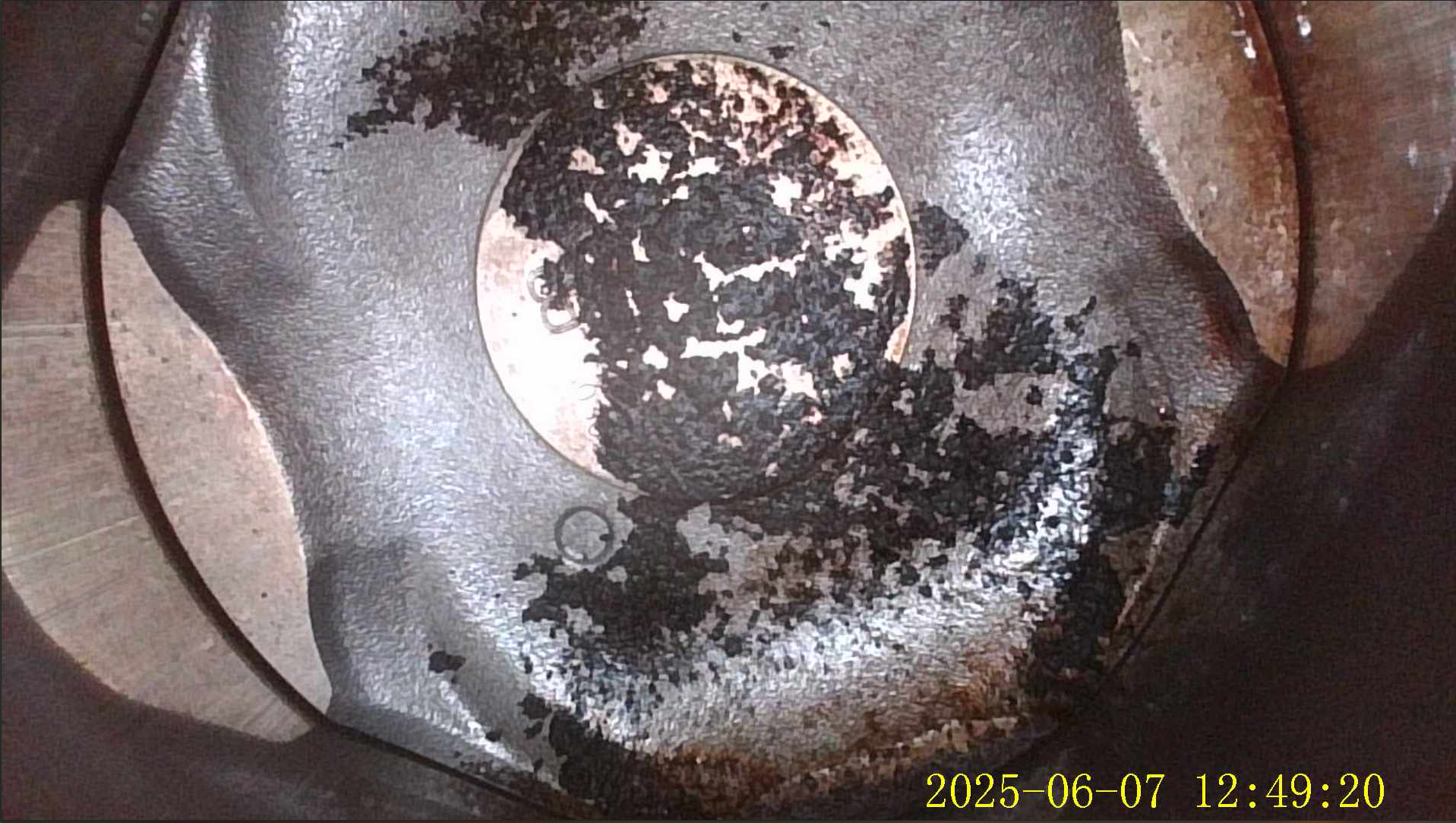

    Can the SC leak its coolant into the pistons? I am having misfires on 7&8. This is 7. Looks like coolant in there, I am not losing engine coolant, I may be losing SC coolant.

  9. Jun 7, 2025 at 1:30 PM
    armyoffoo
    armyoffoo Member
    Jun 4, 2018
    #15876
    1,366
    Cypress, TX
    2018 Black TRD Sport CrewMax
    Supercharged with all the trimmings
    If the intercooler cracked, or one of the orings between the SC cover and intercooler is torn it could be.
  10. Jun 7, 2025 at 1:35 PM
    e30cabrio
    Oct 20, 2017
    #10410
    6,202
    West Valley, Phoenix, Az.
    Boosted 2013 Sequoia TRD FAUX
    Intercooler is ok, so open the top cover & look? That's much easier than my fear I needed to pull the SC.

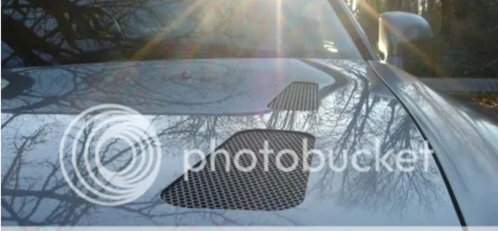

    I have seen some DIY projects that also make these vents/mesh waterproof using waterproof and dustproof hydrophobic prefilter mesh. It can be found at Amazon very cheap.
    I found a company that use the same approach to make Jeeps factory vents functional and waterproof.
    https://www.ironrockoffroad.com/product/jl/jt-hood-vents.html
    I am not there yet, but I am planning to do something similar when I finish the Turbo kit install.

    Yep, pop the cover off and you should see the condition of the o-rings and also be able to see if there is any cracks in the intercooler inside the SC.

    Ordered from JonB, I don't have anything that will pressurize the SC coolant reservoir, it's an oddball opening.

    I've pulled the I/C brick 4 or 5 times, used the same o-rings/seals. I pressure tested it with a cut up inner tube Schrader valve clamped to inlet/outlet pumped to 7-8 psi and used some soapy water to look for leaks. Kinda primitive and shady tree... ya gotta do what you can with what ya got.
    I used a bike hand pump as I didn't want to blow it up.

    Does it make sense I'm only having misfires on 7&8 that it's leaking into the intake?
    Also, would increased IATs be a symptom of leaks? I have also seen higher temps than normal.
    Do I need to drain the coolant? Having a hard time finding any documentation on this.

    You can clamp inlet/outlet hoses take them off and try to pump out remaing coolant in brick before pulling lid so levelbis below the seal. Pull it easy so no coolant can drip out into rotor housing.

    If the o rings are the issue, they are at the rear above 7 and 8 . Also, if the coolant is leaking it would not be doing as well to transfer heat and would lead to higher iats. Is the coolant level lower than 1" below the top of the reservoir? This would indicate a leak in the system.

    The level has been going down but because my lid is not vented it was creating a vacuum so Viktor drilled a hole & it was losing coolant there.
    It seems to be losing it much quicker & that looks like some coolant in the cylinder to me. It's 107 right now, I'll take it apart in the morning.

    See, that throws a red flag for me. The system is closed, and the cap should be a pressure release for when the coolant expands due to temp, it should never be under vacuum. Unless there is a leak and vacuum from the engine is sucking in coolant. Where did Viktor drill a hole in his cap, I don't recall seeing that, but might have missed it.

    The reservoir is similar to yours but older, it has a 3 prong unvented cap. Viktor gave it to me for the cost of shipping.
    It has a tiny hole to the right of the cap in the top of the tank. It never created a vacuum in my truck, he told me that is why he drilled the hole.
