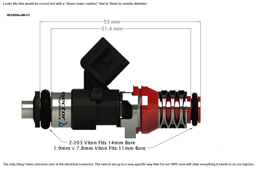

    T1 Race Development (support for injector dynamics) is going to send me a mock up injector so I can verify fitment.

    Hey, I got them... y'all telling me that aren't true 1000cc injectors?

    They are if you believe most of the stuff Prospeed says :rofl:

    Spec sheet has them at 932cc at 43.5psi and 1056cc at 58 psi.

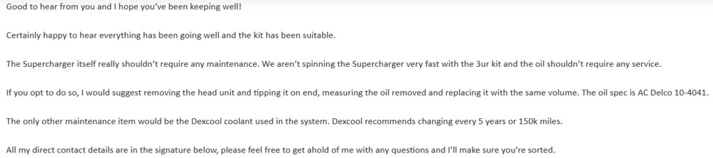

    I sent a nice note to Harrop concerning my unit effortlessly crossing 100k miles of use.
    and received this back:

    Harrop support is amazing...they inspected my head unit, replaced the coupler and shipped it to SCOL on their dime, no billing for anything.

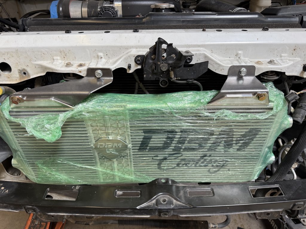

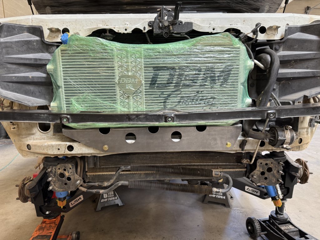

    DBM Coolers mounted up. Looks damn good. Trans and blower cooler

    When is your pops rig going to be completed?

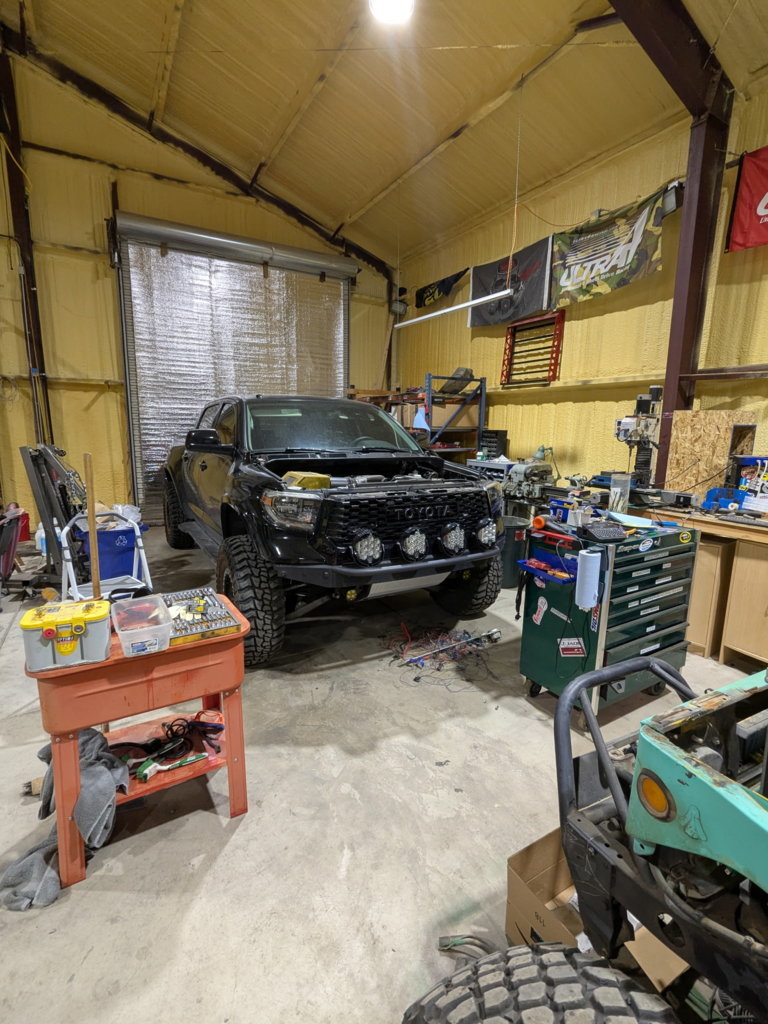

    And Darkstar is in the skunkworks lab! @snivilous
    nags, Silver17, e30cabrio and 12 others like this.

    Looks like it puked up some unnecessary wiring. :D
