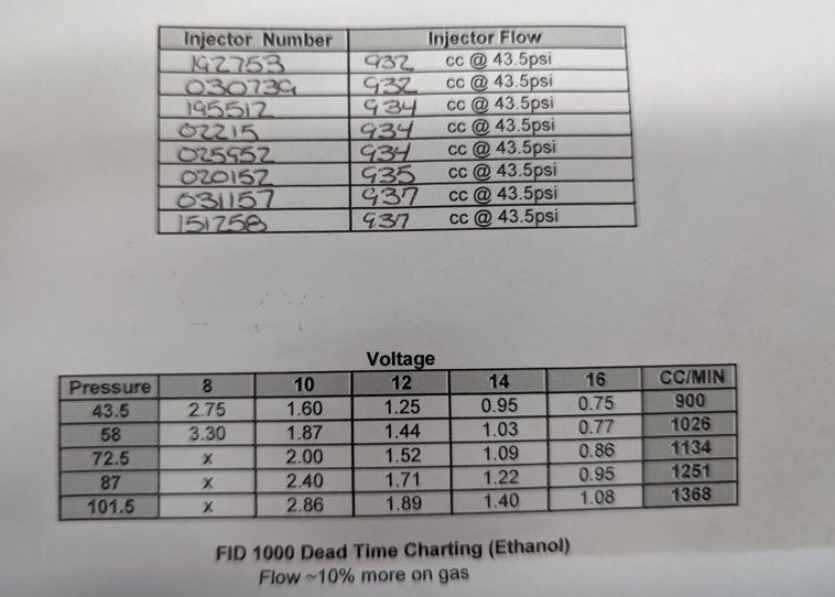

    Fastlane had the Prospeed "1000s", these were the flow numbers he sent. They're really 900s:
    There's one other guy I've tuned, his IG is "TrailCommand". I can't find where he said it, maybe it was texts long ago, but I thought he was running 1000cc GT500 injectors. Not sure how that worked or the specifics of them.

    Thanks for sharing this. I was debating going the 1000cc over Jesse's 880cc, but if between only these two, and after seeing these numbers, I'll stick with Jesse.

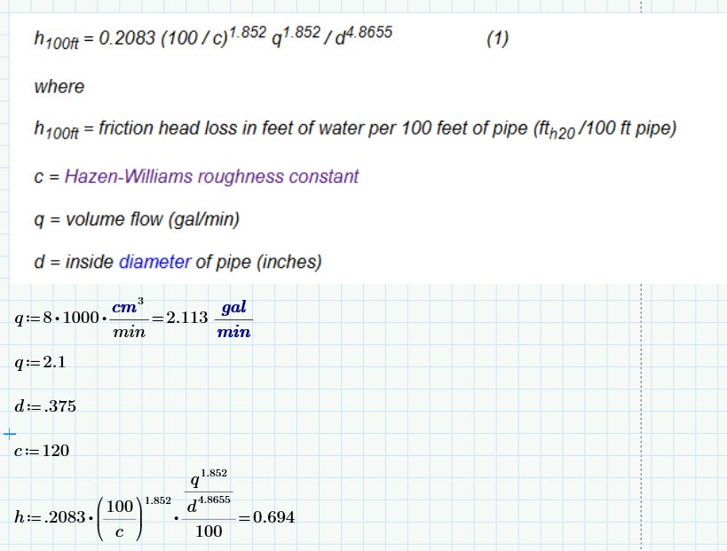

    Been awhile since I did any fluid dynamics, but there's a pressure loss calculator here: https://www.gates.com/us/en/knowledge-center/calculators/fluid-flow-pressure-calculator.html
    And it ball park lines up with some random ass equation I found :D (the end result is pressure loss per 1ft of line).
    It would seem like -6AN would be more than plenty. With that said all my fuel pressure regulators come with -10AN fittings so I run -10 for the feed :D Which no doubt is insane overkill, but if you're running the lines what's an extra few dollars to make it absolute overkill and never think about it again.

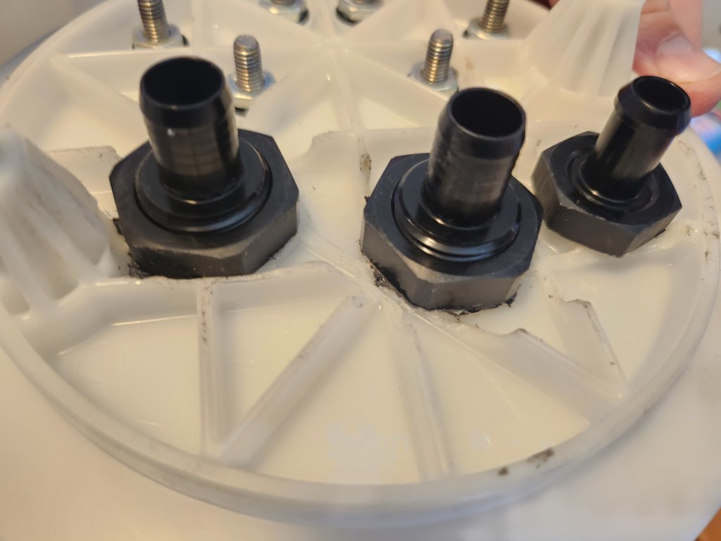

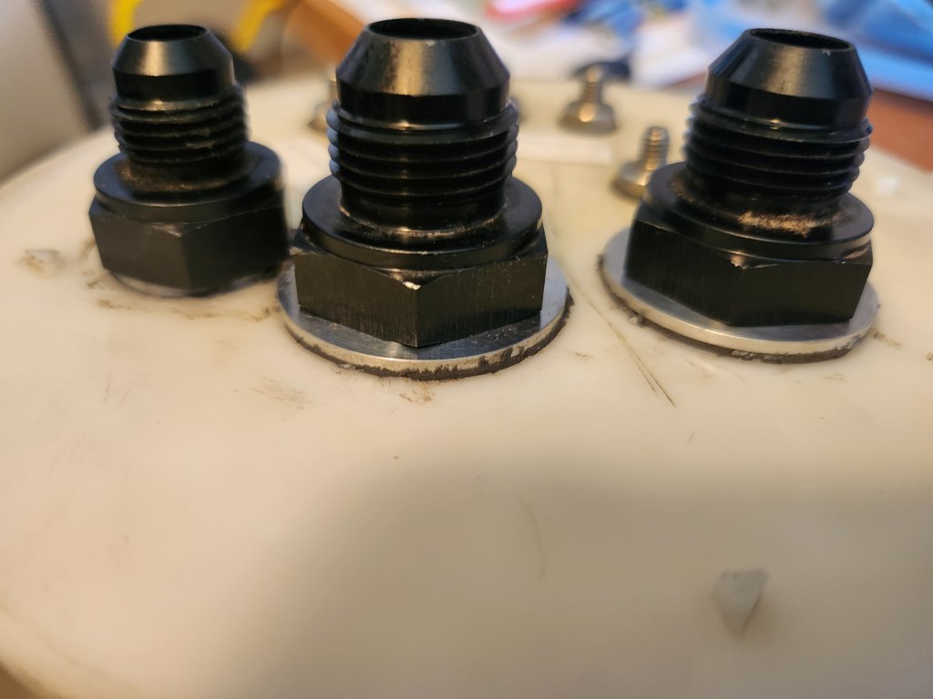

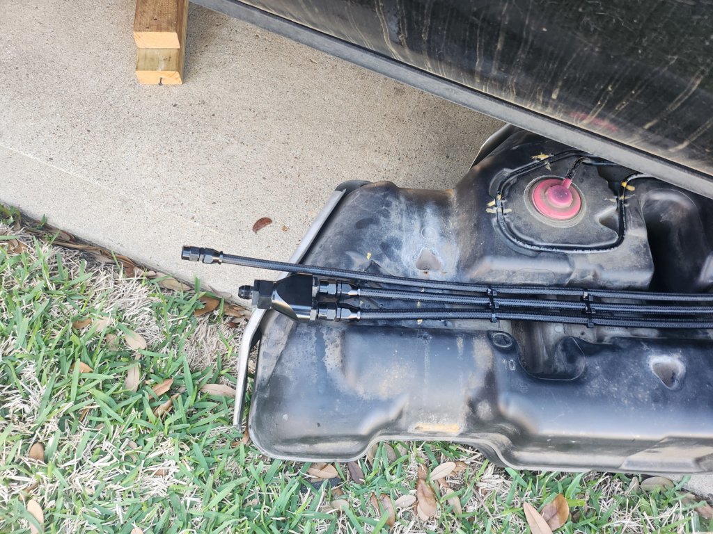

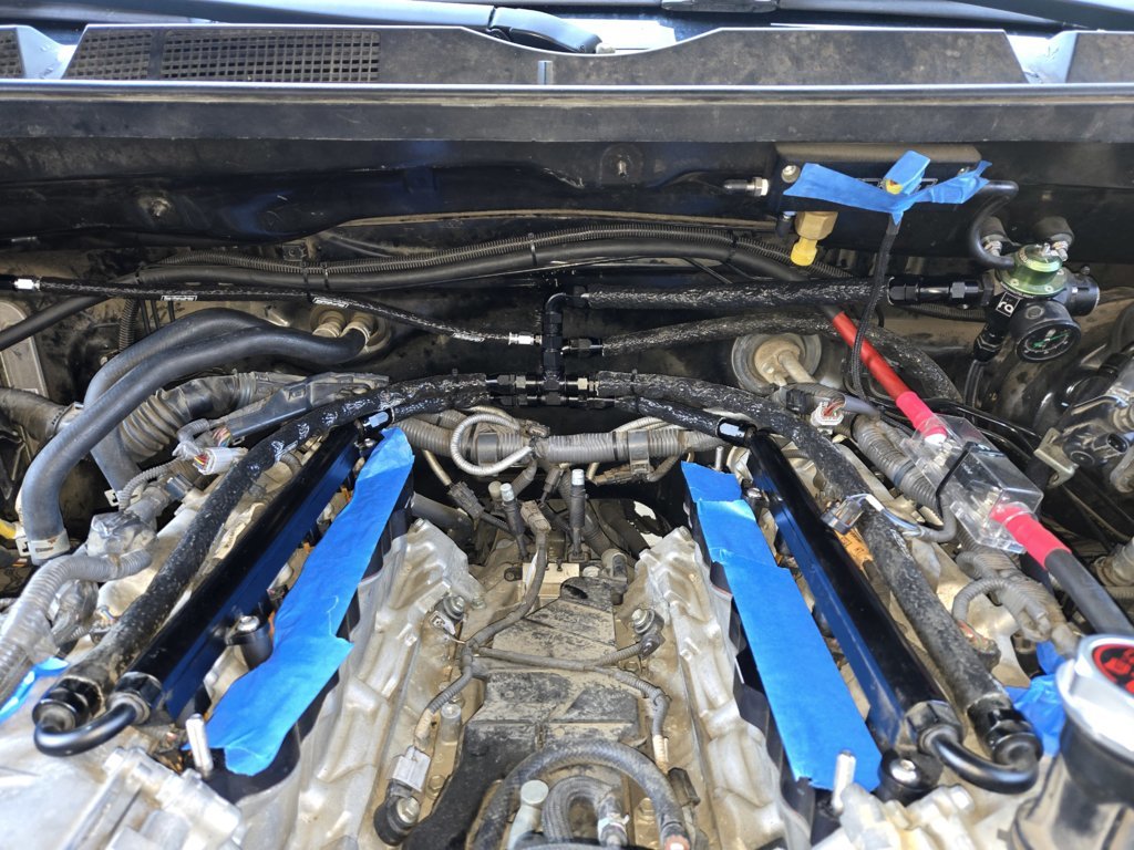

    I've also setup mine for overkill, I would prefer to have room to expand for future power levels. I have 2x450's feeding 8AN out of the basket to a single 8AN line to the rails, which splits to 8AN for each rail, then 8AN out of each rail to a single 8AN line back to the regulator, and a 6AN from the regulator back to the tank basket. Second 450 turns on at 3PSI via Hobbs switch. Both pumps have dedicate 10ga wiring bypassing the stock fuel wiring setup.
