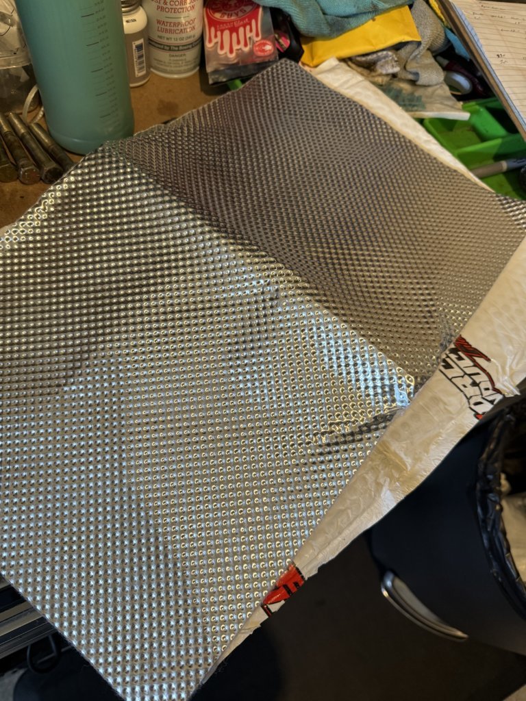

    Guess it’s fine not being gold

    No, send it back and tell em you want it gold or bust!

    I know that comes in gold because I looked at it for mine.

    I was about to say I'd just spray it with a gold cerakote and call it a day, worse case it just helps expand the lifespan of the blanket.

    Bruh, performance wise, you should be fine. :rofl:

    lol not like it’s its visible

    Ya, but you will know…

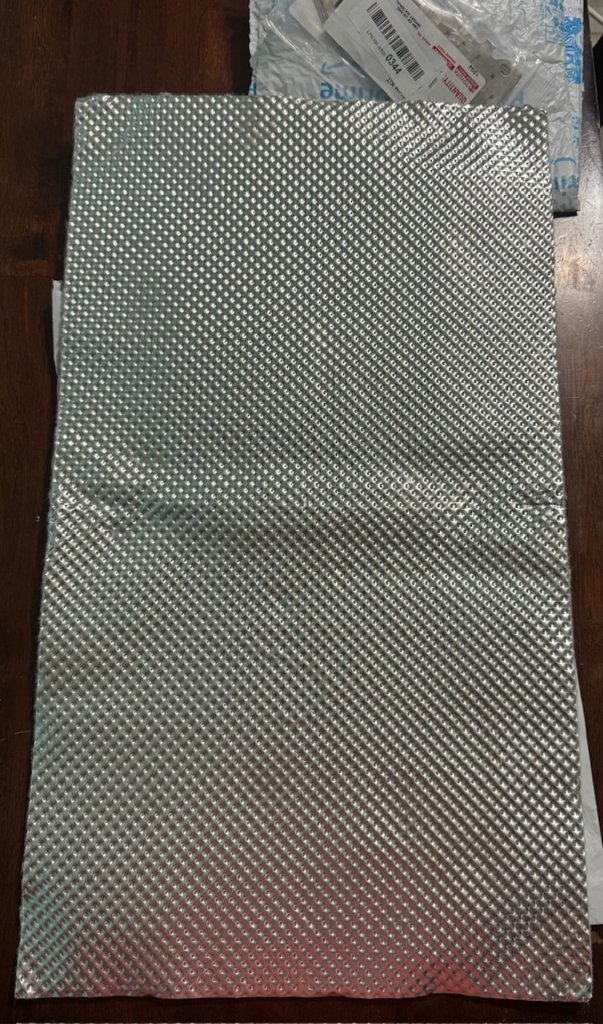

    FI heat blanket showed up today :woot:

    And...mines delayed two cities away since Monday. Maybe ups don't like thermal blankets.
