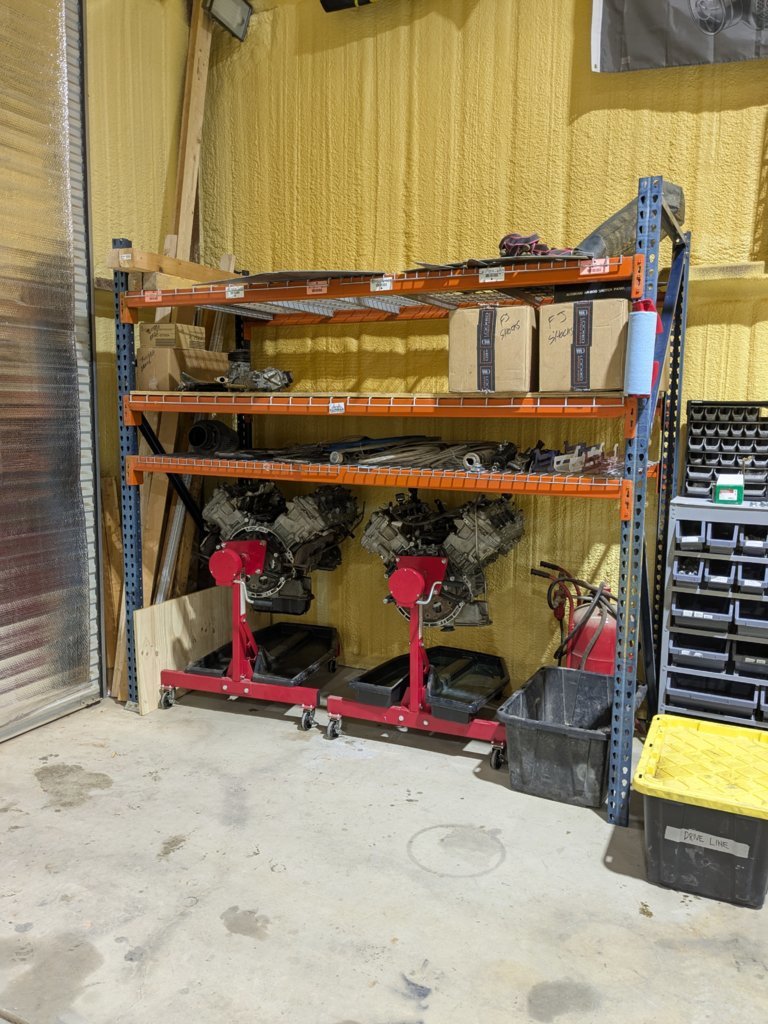

    300k+ Supercharged 2008

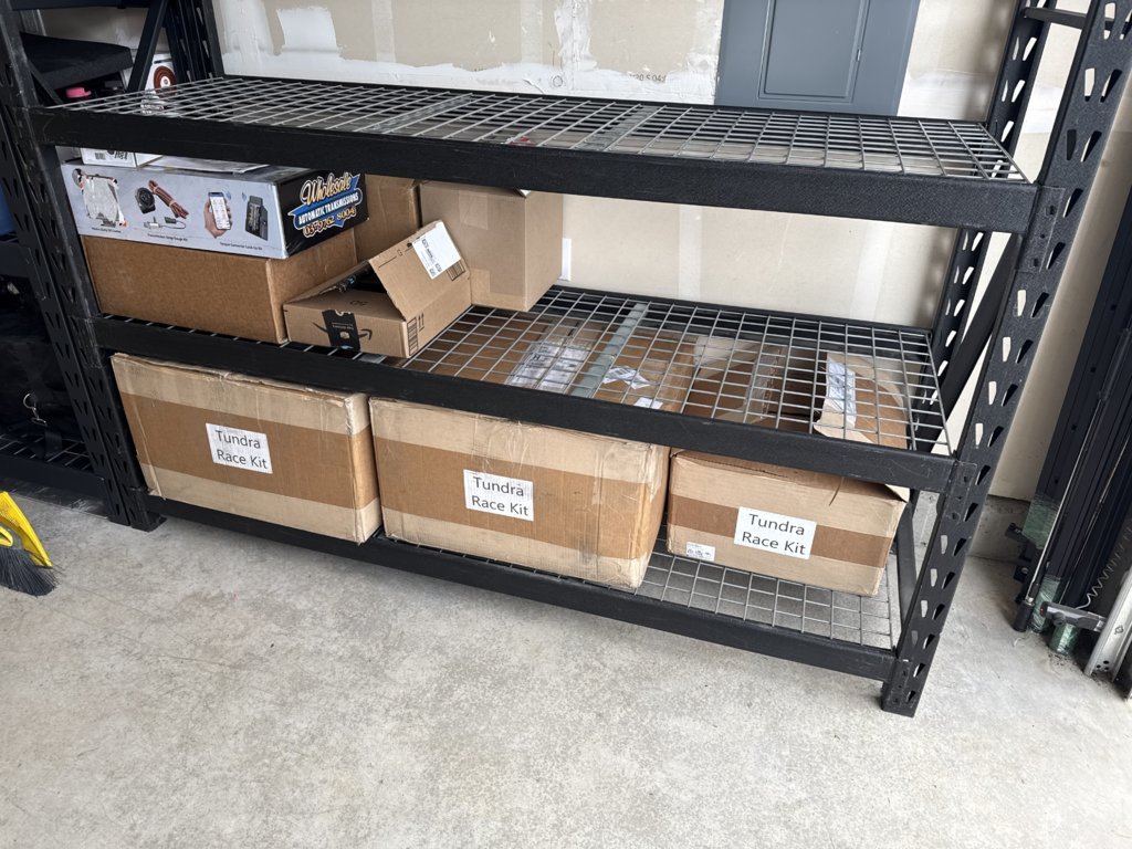

    Should be in the driveway. First have to finish putting more pallet racks in the shop so I have somewhere for all this shit :rofl:

    Haha so many parts coming

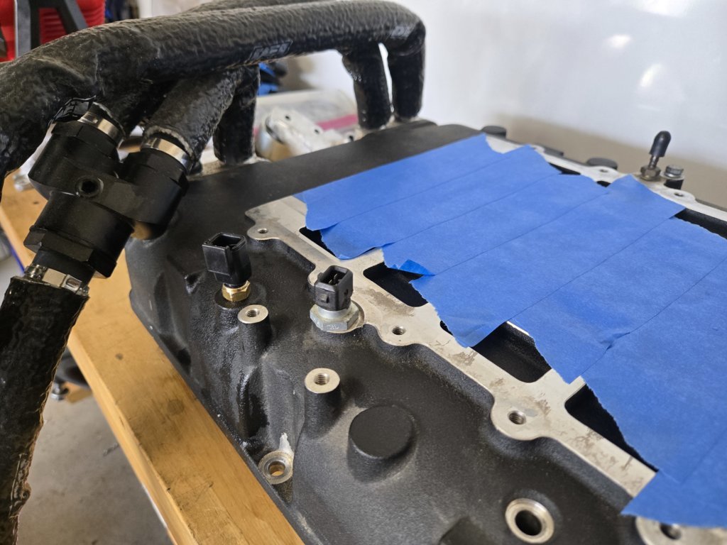

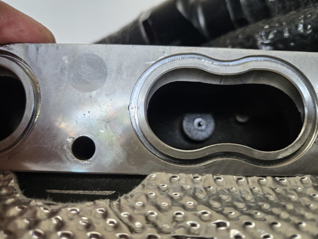

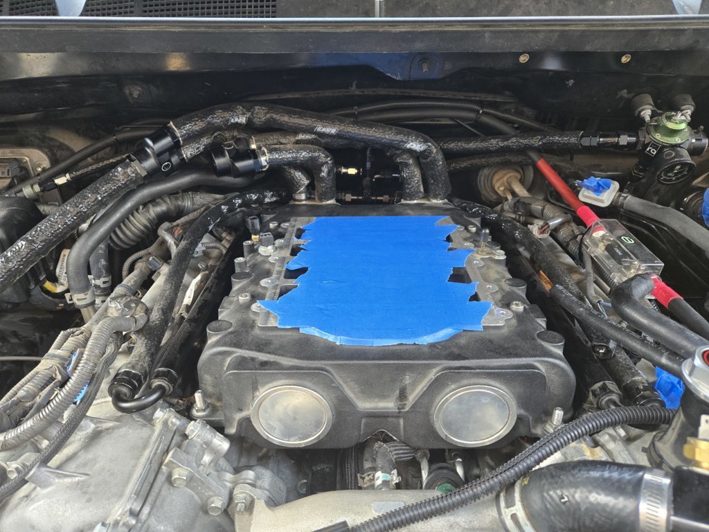

    Drilled and tapped a hole in my lower supercharger manifold for a Haltech air temp sensor next to the Harrop sensor's location. Also, swapped back to the GM snout and waiting for the sealant to setup I need to find a new location for my SC coolant pump, then I'll be rerouting coolant hoses for the interchiller and adjusting vacuum lines. I should be back up and running this evening, can't wait to have my power back.

    Awesome! So by cylinder 8 is a good spot for an IAT sensor? Yours is between 6-8. Will be adding one once I get all set to fix some items.

    Runner for Cyl 6, I figured it was since the Harrop sensor was in the same area. The manifold has bosses for machining additional injector bungs, so I could have picked any cylinder, probably would have been good on the opposite side to see if there are any differences between them. Picture is out of focus, but the hole on the left is the Haltech sensor and the one of the right is the Harrop sensor. This is also a good shot of where the spacers were contacting the lower manifold.

    @reywcms new 5.7 in the house, alongside a hurt 5.7 for me to experiment with!
