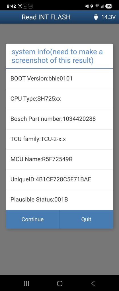

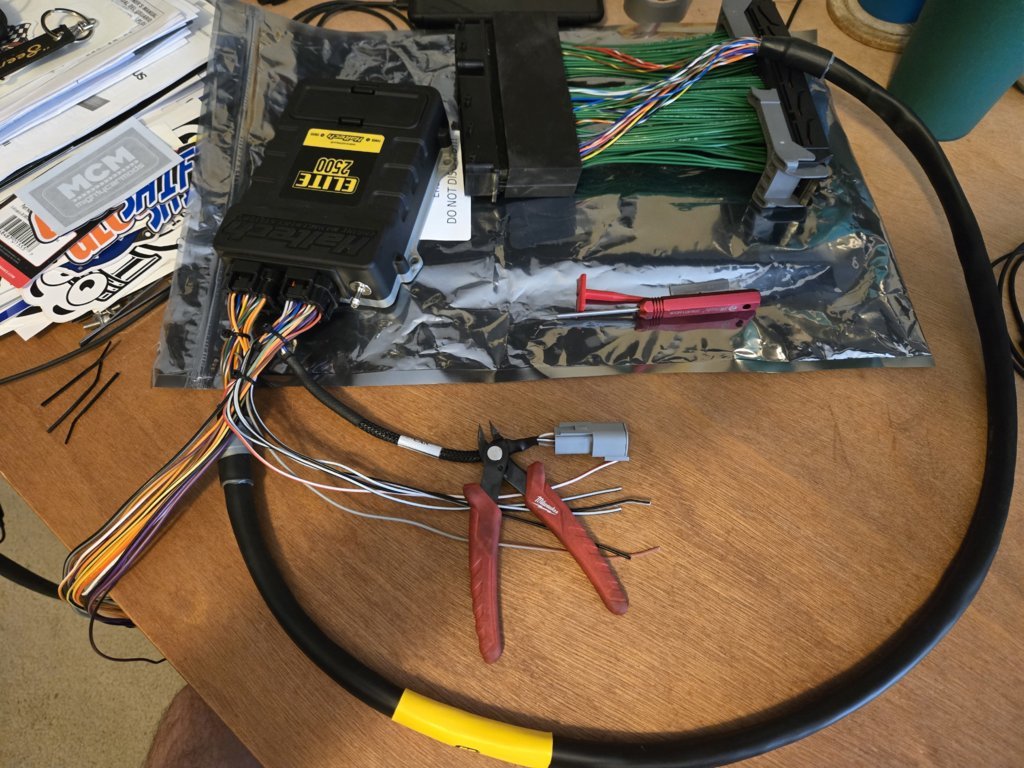

    Moved wires from my Haltech flying lead harness over to the Boomslang plug-and-play harness, added sensor inputs, sensor grounds, DPO outputs and CAN plug wiring. I still need to join the sensor grounds, join the 12v switched wires and extend those for termination in the truck. Once I get over my analysis paralysis and choose a mounting location I can get everything trimmed down, terminated and loomed.
    I also got my 8HP information over to CANformance, and they have sent me the appropriate firmware and eeprom to flash, Ill get that done today.

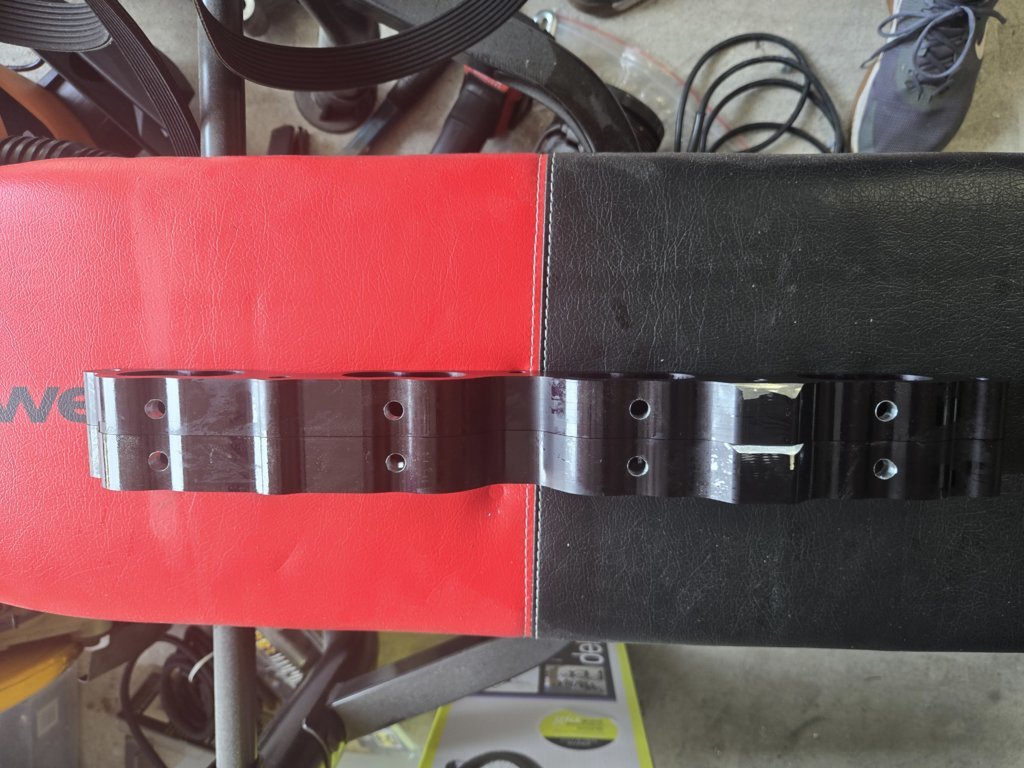

  5. May 31, 2025 at 9:53 AM
    Abell207
    Abell207 New Member
    Aug 24, 2020
    #51252
    238
    Anthony
    Maine
    2020 Army Green TRD PRO

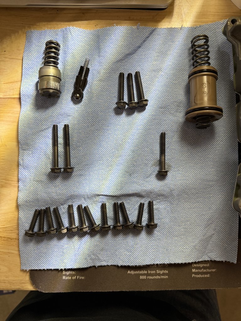

    IMG_2782.jpg So I only got to take the pan off yesterday but today I’m finishing it up. In the instructions it says 12 25mm, 4 36mm, 2 45mm and 2 50mm. I’m missing 1 of the 36mm and 1 of the 45mm. Just wondering if you guys were the same or I’m SOL because I’ve looked everywhere.
    Mdl likes this.
  6. May 31, 2025 at 10:27 AM
    blenton
    blenton New Member
    Jul 15, 2022
    #80740
    3,119
    Count them on the valve body.. But that top left piston looks pretty thrashed.

  7. May 31, 2025 at 10:50 AM
    Abell207
    Abell207 New Member
    Aug 24, 2020
    #51252
    238
    Anthony
    Maine
    Well I’m an idiot.. One of the bolts must’ve been in one of my rags and it was at the bottom of the trash, all good there. As for the scoring on the piston not much I can do about that right now. Anyone know where I can get another one?

  8. May 31, 2025 at 11:00 AM
    VWTim
    VWTim Mid-Travel Crew
    Mar 1, 2021
    #59814
    802
    Corvallis, OR

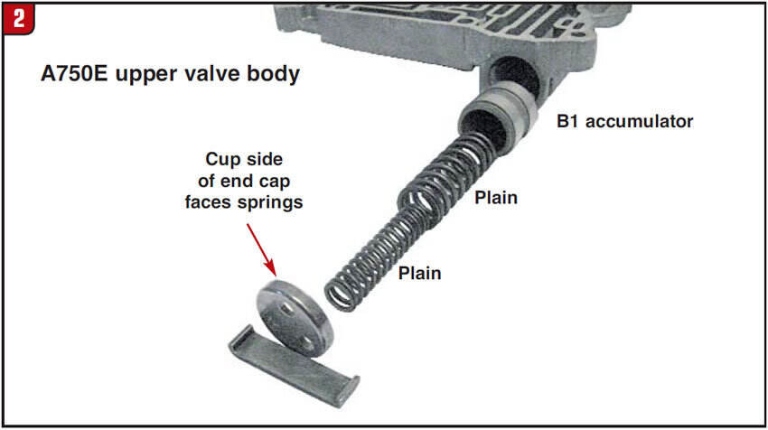

    Anyone know if that piston comes in a Sonax shift kit?
    HulkSmurf14 and Mdl like this.

  15. May 31, 2025 at 2:58 PM
    Mdl
    Mdl Hey there...
    Jun 14, 2023
    #98638
    3,399
    PNW, WA
    2007 TRD SC'd
    JBA Longtubes, Snivs 2.0 SC pulley, ASP crank overdrive pulley 6.71 in, DD Full 3inch dual exhaust, IPT valve body, Airbox mod, 4.5inch intake, Denso 750, 450 Walbro, W/M injection, GM 95mm TB, SABM, Camburg UCA, Icon shocks, Speedmaster LSD, Motive 5.29 Gears, Mickey Thompson Baja Legend EXP 35's, Solid Offroad engine and transmission mounts, DIY Traction Bars, Tuning by Snivspeedshop.com
    Looking good! Sure are making some progress. I'm waiting for my snout bearings to show up before I remove the SC. I'll try and open up the entrance a tad more and polish the inside. Waiting for the direct port kit to show up...
  16. May 31, 2025 at 3:37 PM
    Jowett
    Jowett New Member
    Mar 19, 2021
    #60646
    561
    Brian
    North Adams, MA
    2011 Regular cab long bed 5.7 Work Truck Package
    Many on the way.

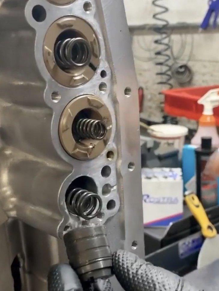

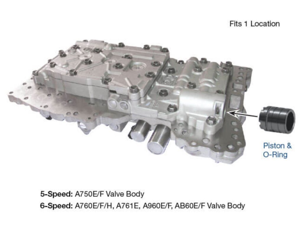

    A little digging and it looks like we may have a winner here. The individual Sonnax piston that comes in the shift kit is Piston Kit part # 57917E-19K. Normally utilized in the valve body of several different Aisin transmission models including the A750, A760, and our AB60. The parts in the upper valve body certainly look like the main body accumulator B1 # 35424-60030.
    Normal spot for Piston Kit part # 57917E-19K
    This guy on instagram is shown installing it on a 760 in the same position.
    Video on instagram
    https://www.instagram.com/p/CAf_dFhhQ-3/
    Probably worth a call to Sonnax on Monday.

  19. May 31, 2025 at 4:28 PM
    Abell207
    Abell207 New Member
    Aug 24, 2020
    #51252
    238
    Anthony
    Maine
    Nice find. I ordered a stock one but wonder if that sonnax one is better? I will call monday though, and keep that oem one on order just in case.
    Mdl likes this.

  21. May 31, 2025 at 4:34 PM
    Abell207
    Abell207 New Member
    Aug 24, 2020
    #51252
    238
    Anthony
    Maine
    So those pistons are the same that are in the valvebody and on the transmission side? The one I need is the transmission side.
  22. May 31, 2025 at 4:37 PM
    Jowett
    Jowett New Member
    Mar 19, 2021
    #60646
    561
    Brian
    North Adams, MA
    Many on the way.
    Yes, at this point, that appears to be the case. That video on Instagram shows a Sonnax valve body piston being installed on the transmission side. Sonnax should be able to verify this, though it’s funny they don’t offer it in their shift kit.
    e30cabrio and Abell207[QUOTED] like this.
  23. May 31, 2025 at 4:38 PM
    Abell207
    Abell207 New Member
    Aug 24, 2020
    #51252
    238
    Anthony
    Maine
    Yes I saw that, maybe I’ll cancel the oem one then as this seems to be a better solution.
  24. May 31, 2025 at 4:41 PM
    Jowett
    Jowett New Member
    Mar 19, 2021
    #60646
    561
    Brian
    North Adams, MA
    Many on the way.
    It’s looks like a good swap… BUT again… I’d like to hear some thoughts on this from Sonnax or TransGo before the swap.
    Abell207 likes this.
  25. May 31, 2025 at 5:04 PM
    Mdl
    Mdl Hey there...
    Jun 14, 2023
    #98638
    3,399
    PNW, WA
    2007 TRD SC'd
    Both Transgo and Sonnax have good customer service. Knowledgeable and will answer your questions. I spent 30 minutes on the phone inquiring about their kits.

  27. May 31, 2025 at 6:11 PM
    Abell207
    Abell207 New Member
    Aug 24, 2020
    #51252
    238
    Anthony
    Maine
    I just got done with the fill procedure, I dumped the old stuff into a container and got damn near 8qts of old stuff out with the swap. I then added another .5-.75qts after the check plug came to a trickle at around 108-115F. The test drive will happen tomorrow but I did notice when going back and forth between reverse and drive it seems reverse is pretty aggressive when it clicks in. Drive wasn’t nearly as aggressive.
    HulkSmurf14, Wynnded and Mdl like this.
