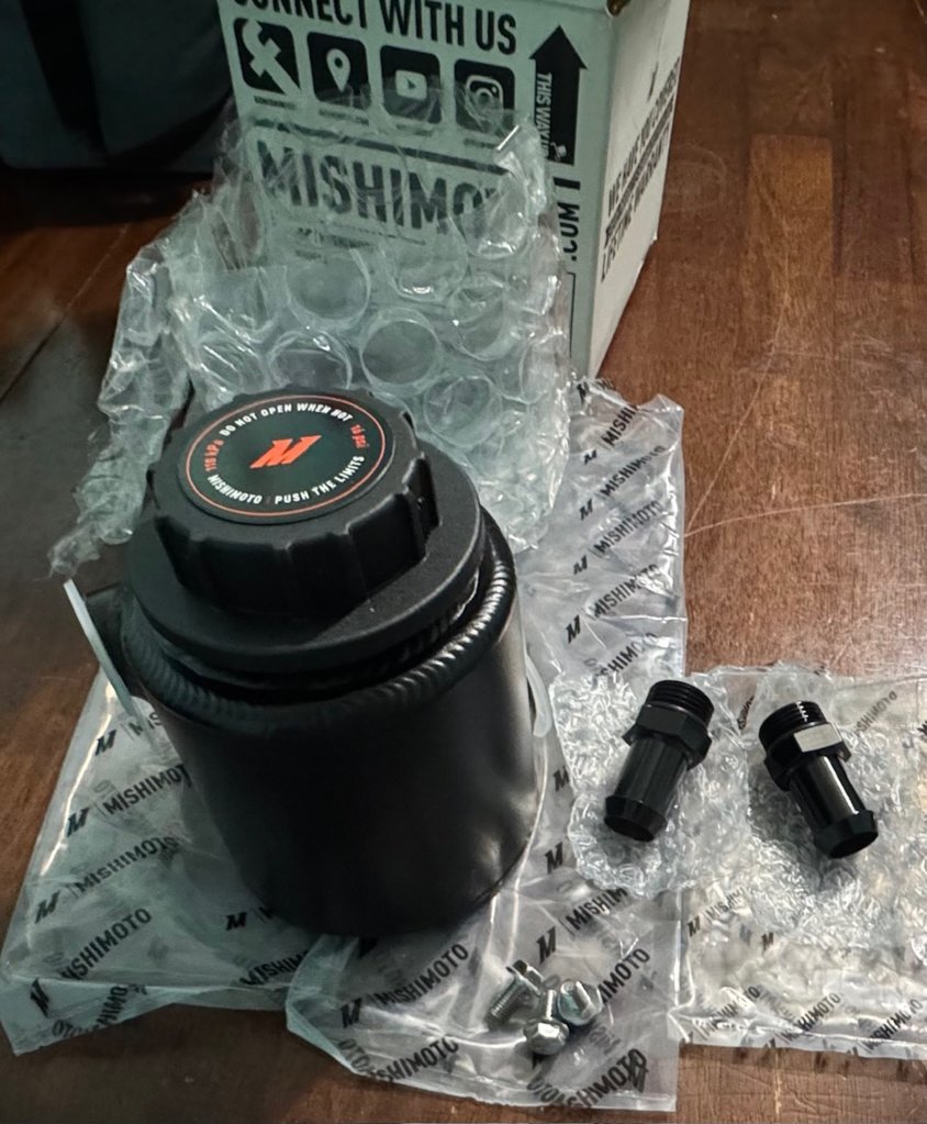

    Picked up a mishimoto coolant tank at a decent discount for the Magnuson. Never really liked the plastic tank that came stock.
    It’s pretty nice in my opinion

    Some folks have had issues with the stock tank leaking. Mine always had dry coolant crusted on the rim of the tank for some reason but never noticed any leaking from the barbs. The plastic tank also just felt kinda cheap to me lol.
    The cap on the mishimoto also clicks to avoid over tightening it.
    138+tax

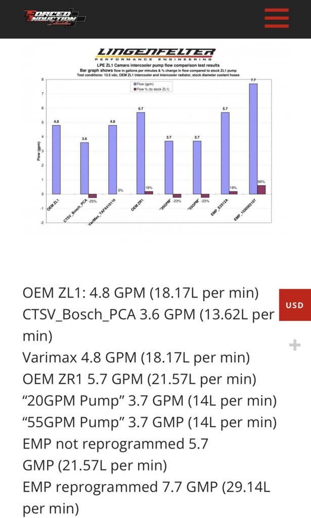

    I believe the basic Bosch pump puts out 3.94 gpm while the zzperformance puts out 9.24gpm. The greater volume/flow aids in cooling.

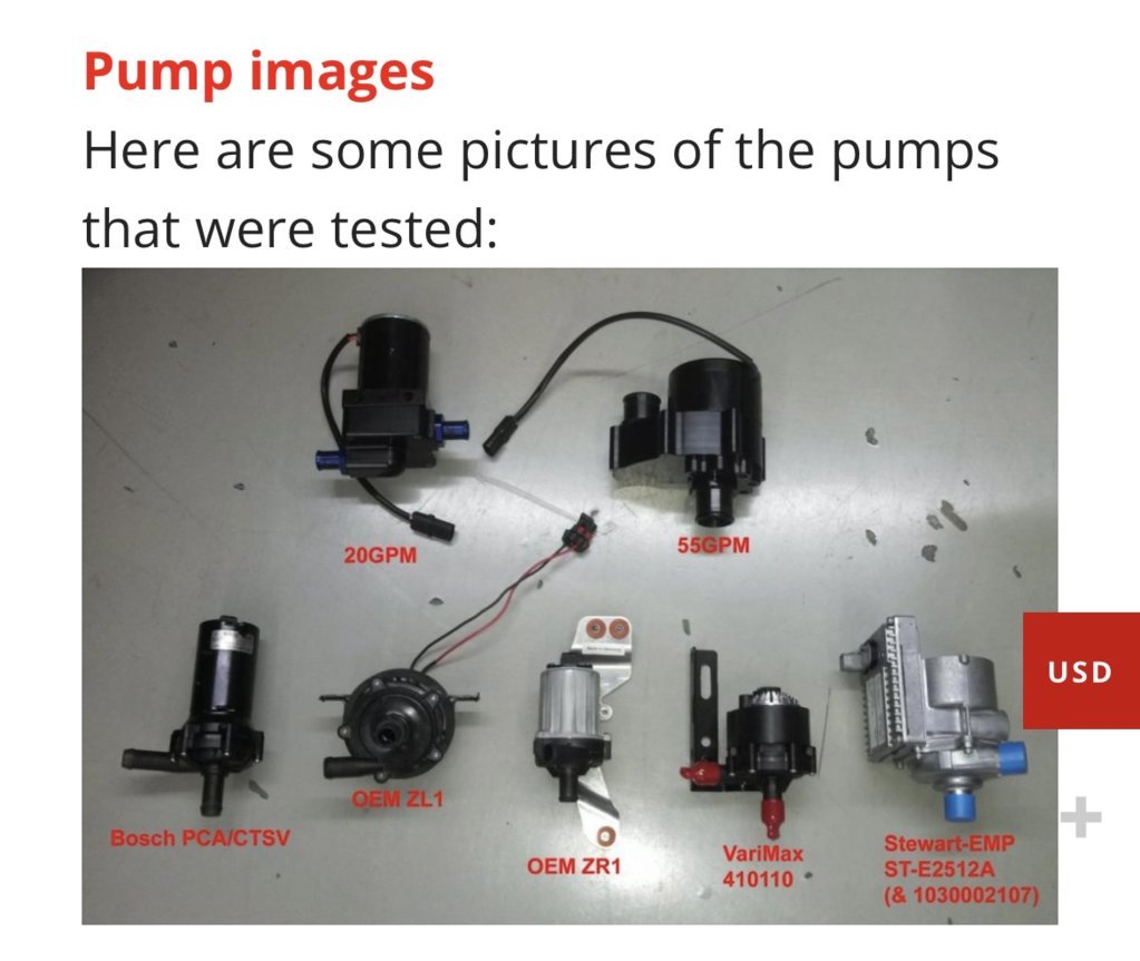

    That's pretty close to some info I ran across stating around 4 to 4.5gpm on the stock pump, so looks like I'll be ordering the zzperformance pump

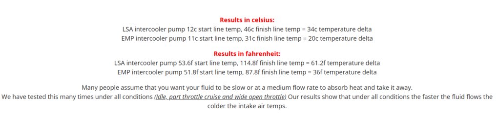

    This. The more the pump flows, the colder the temps, tested over and over again by several companies. If you google "intercooler pump flow testing" you will find well-documented examples from reputable companies.
    https://fiinterchillers.com/emp-intercooler-pump-vs-lsa-intercooler-pump/

    I was also under the impression that too much flow doesn’t allow the fluid to absorb it quickly enough to be any more efficient, and in some cases, less efficient.
    But it appears I may be incorrect in my assumptions..

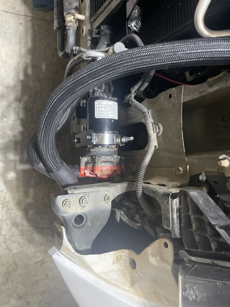

    In my case my Bosch pump was making noise and my tfd intercooler was starting to leak. So I replaced it with the zzpump and a larger front intercooler.
    If your stock setup has been working fine, like mine for over 10 years before it crapped out, then no need to change it.
    Installing the in/out temp gauge would be nice to see what's going on...
