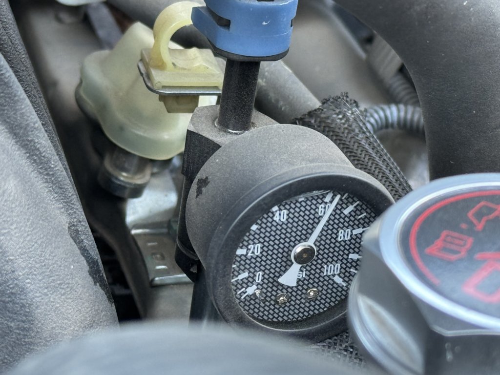

    I guess if I paid attention to your jumper wire post that I actually looked at the fuel psi gauge earlier...:rolleyes:

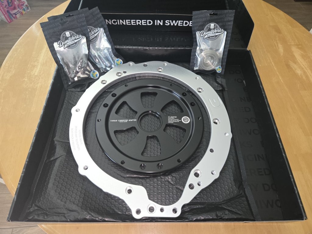

    Another piece of my puzzle has arrived, and it's beautiful
    ARES35, ZPhilip, Saltyhero13 and 9 others like this.

    That's some nice hardware! I'd be fine spending $500 on that :oops::D

    okay...not to sound like I'm a noob but what exactly am I looking at?

    Adapter kit for a Dodge Hellcat 8HP90 transmission to mount to the Tundra 5.7L engine

    Okay,that makes me feel better.
    I'd like to think I'm pretty well versed when it comes to engines but that threw me for a loop.
