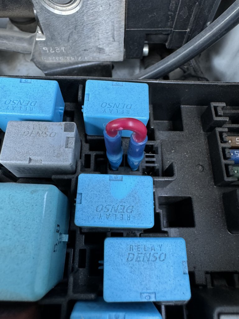

    Made a jumper wire in place of the removed vsv relay. Confirmed fuel pressure has been bumped and is now in high pressure mode. Will switch to being boost referenced also before getting the tune revision done on 6/4. I need to run and get some more hose and a fitting for the boost reference connections to be made tomorrow.
    Also, was able to confirm the whistle was coming from the trd accelerator and not the RCF throttle body.

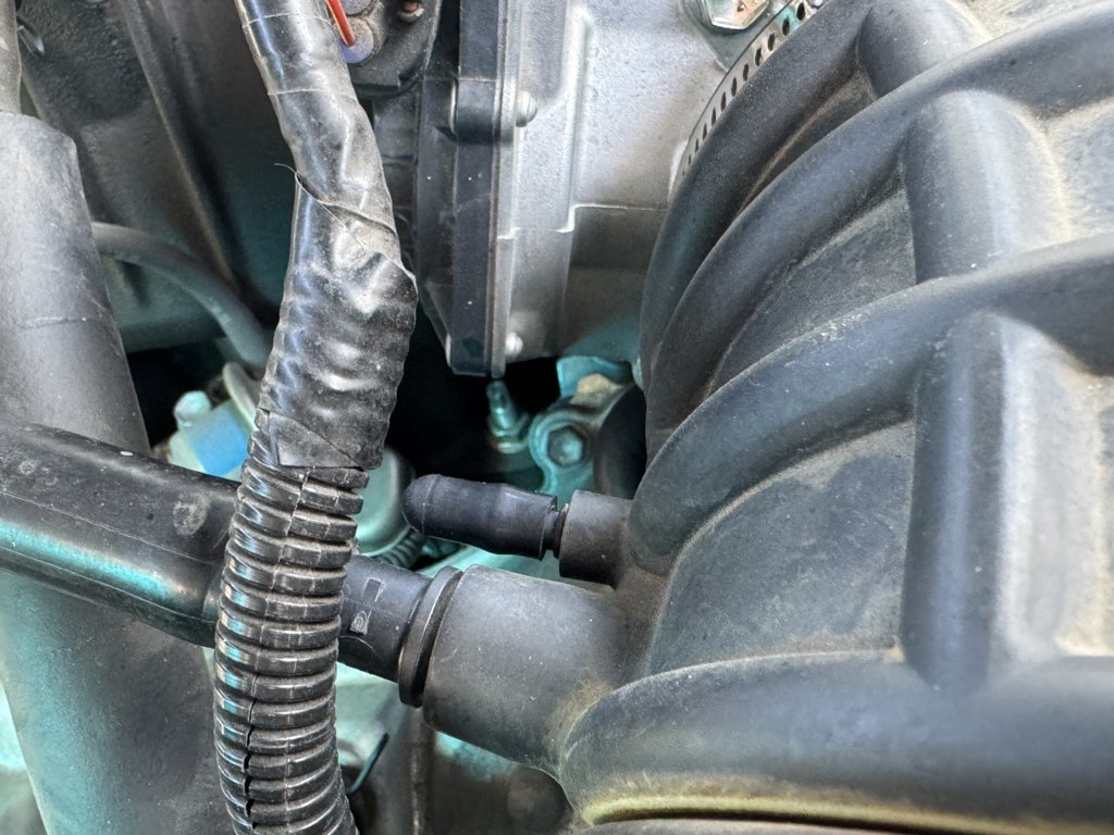

    Picked up some vacuum hose, coupler, and a t-fitting for boost referencing. Can someone confirm this is correct? I unplugged the vacuum line from the intake tube and capped it off. The line that was unplugged I used a coupler on and extended it into a t-fitting between the blower boost port and the MAP sensor. Pictures are not the best, but hopefully show what I did.
    HulkSmurf14 and Mdl like this.
  28. May 26, 2025 at 4:54 PM
    Mdl

    JBA Longtubes, Snivs 2.0 SC pulley, ASP crank overdrive pulley 6.71 in, DD Full 3inch dual exhaust, IPT valve body, Airbox mod, 4.5inch intake, Denso 750, 450 Walbro, W/M injection, GM 95mm TB, SABM, Camburg UCA, Icon shocks, Speedmaster LSD, Motive 5.29 Gears, Mickey Thompson Baja Legend EXP 35's, Solid Offroad engine and transmission mounts, DIY Traction Bars, Tuning by Snivspeedshop.com
    Looks good. I forgot if you also have a fuel psi gauge too?

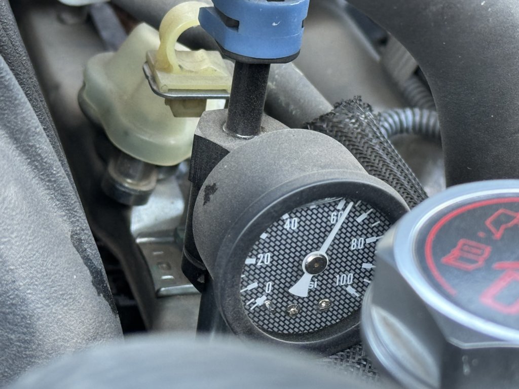

    Phoenix, AZ
    I have a fuel pressure gauge in the engine bay.
