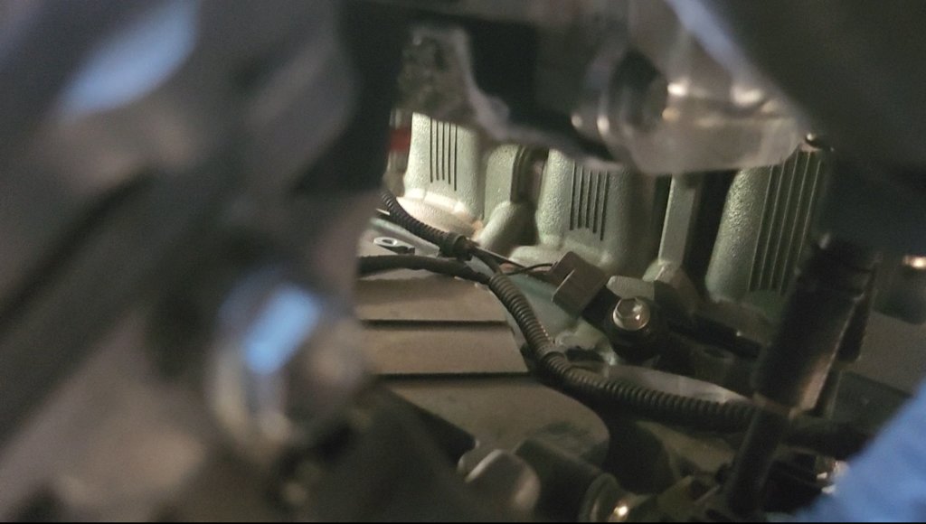

    Yeah, it was a waste of time, but piece of mind knowing the blower is in good shape. Thankfully, Harrop didn't charge me anything, not even shipping costs to SCOL and SCOL was just a diagnostics fee and shipping.
    I was planning on going with the Snow performance kit along with their hardline upgrade kit, there should be plenty of room underneath for the manifolds, lines and solenoids. Since I don't have the SAIS air pumps under there, I have a lot of room to work with. If I need to troubleshoot or remove anything, it's not too much work to get the head unit off and then pull the base. I think it's worth it for the even cylinder distribution that it will provide.

    Looks good! I like that snow kit and its less comex than the Aquamist.Yeah the solenoids can go where you air switching valves were. Lots of options...you got me thinking now!:thumbsup:

    As I was watering the garden I started thinking about the old school shift kit that I had and others back in 2012. It used billet accumulators in c2 b3 and c3 with rods that limited the opening. As I recall it limited the opening and held the clutches during shifts from 2-3 and 3-4. I believed it was a factor in saving my transmission for so long.
