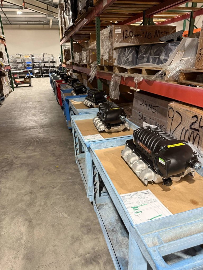

    Dude just posted this on FB. Soon.

    Going on a year of waiting. Hopefully they get it done. I was told the front drive shafts were not passing QC and they were re-making them and then going to test again.
