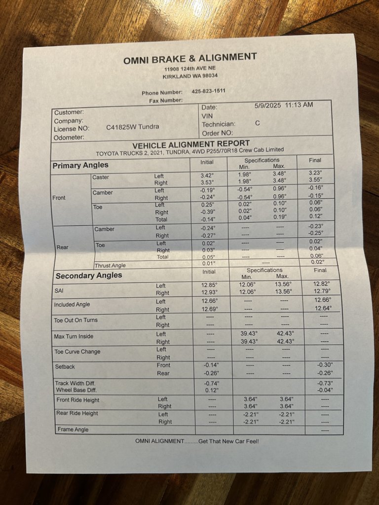

    Do share, curious what that looks like?
    I thought my rear was way out of whack but turns out it’s dead on (and has the SDHQ traction bars hopefully keeping it that way).
    The front (total chaos ucas) were definitely off though (toe).

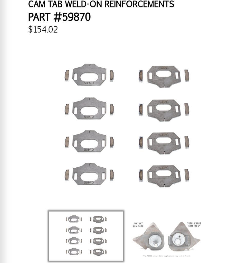

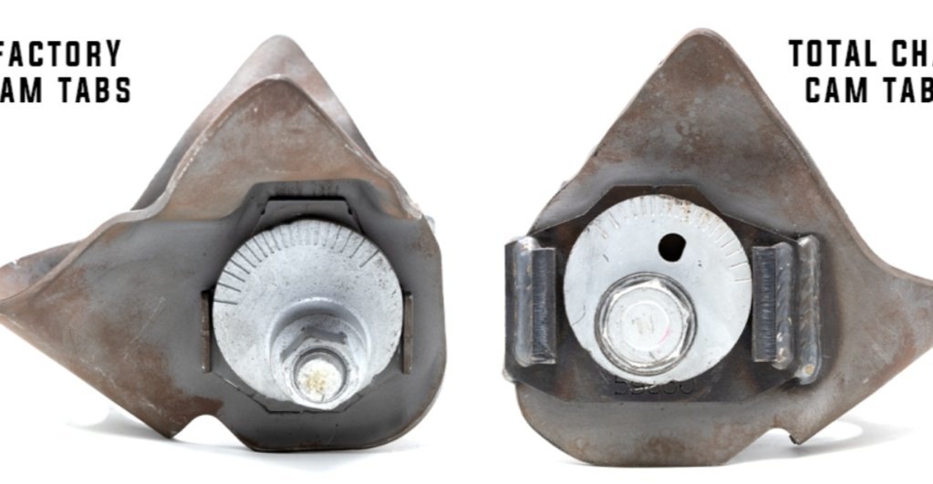

    The cam tabs are pretty thin stamped sheet metal. Sometimes the tabs break off. I noticed my drivers side caster was off when I rotated my tires. Brought it in and he couldn't get it set so had both caster set at 5.5 and I'd like it around 4 ish. You knock off the factory tabs off and weld in new thicker plate/tabs.
    https://www.tundras.com/threads/cam-tabs.56917/page-2
    https://www.chaosfab.com/product/2007-2021-Toyota-Tundra-Lower-Control-Arm-Cam-Tab-Gussets-59870

    I have the octogon style cam tabs

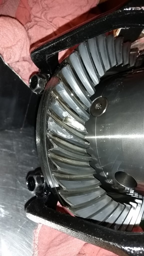

    Geez. That looks more like a horrible design than a clutch issue.

    I wasn’t too impressed. But to be fair, it was in there for over 100k miles. Though the last half of it was giving me fits. I don’t think it was designed to put up with towing and hauling, but it was the only thing available at the time. And better than open for my use.

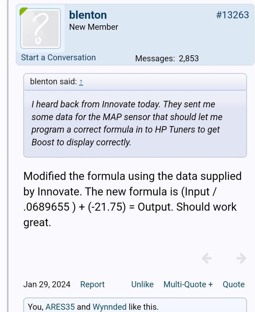

    You can pull boost from the white wire on the map sensor for the psb1. Then just remember what analog you have on the red and blue. I believe @TurboKits posted a good accurate transforming formula for hpt to read it. @blenton posted a formula too. It's in a past post somewhere.

    I have installed this kit on my truck, works flawless. (i totally did not f up the stock ones by trying to loosen the wrong side of the cam bolt with my 1/2" impact)

    The formula is buried here in the thread somewhere. I can pull it off of my windows machine this weekend and post it.

    Sounds like another "first page" adder! Thank you all for the help!

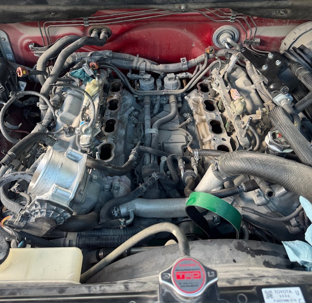

    And it’s out! Big thanks to @Mcbelen (MCBAutotech in Houston), dude came down to where I'm at and got this thing pulled really quick.
    Got everything plugged and taped off. Inspected the s/c, noticed some odd nicks on the rotor packs, no clue if that's normal but forgot to take pics lol. Got it packaged up and should be shipping it out tomorrow.
    Who do you guys normally use to ship these things? I'm thinking of just using UPS.
