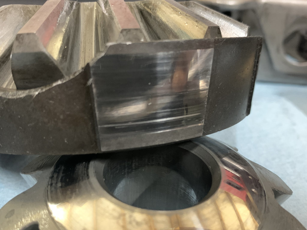

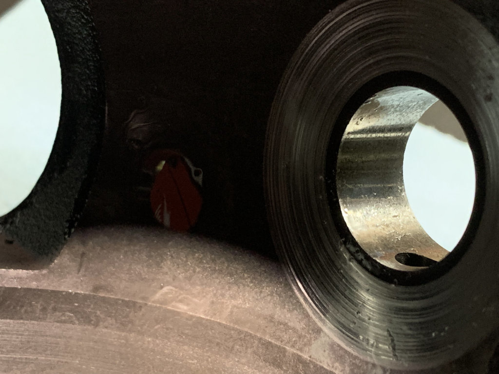

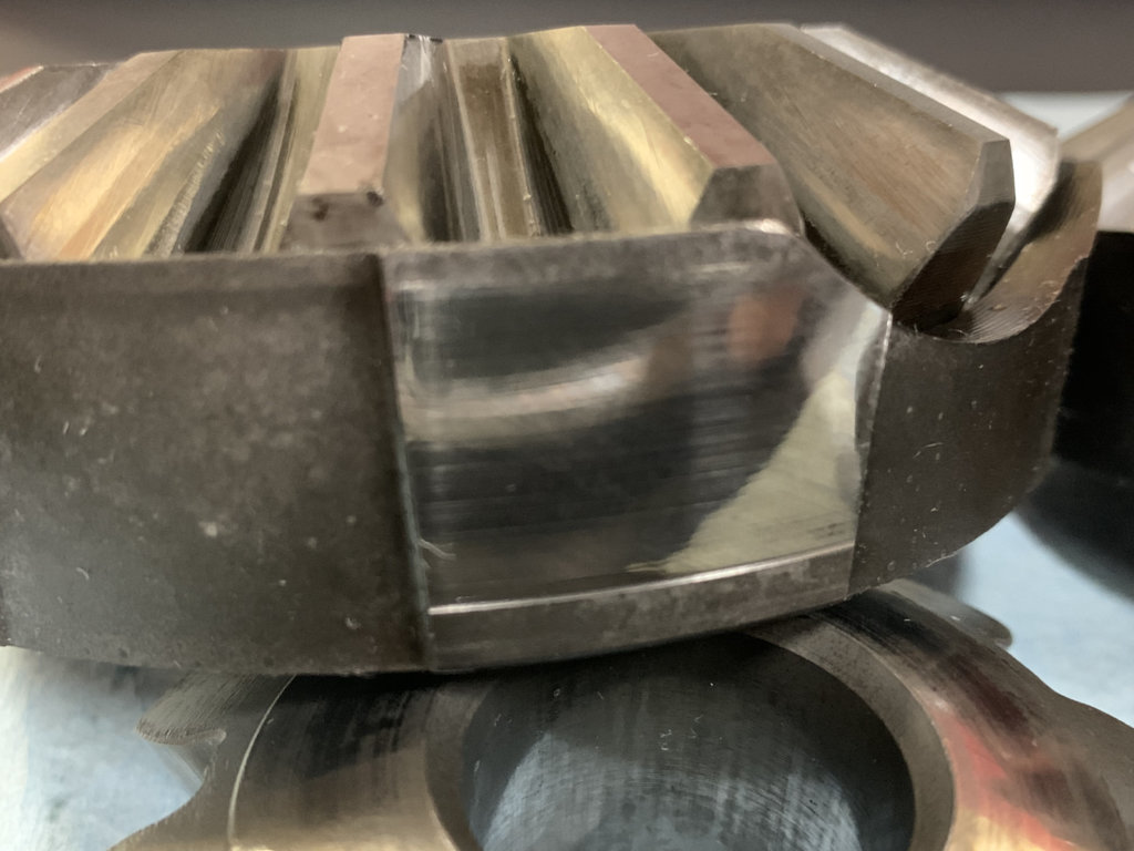

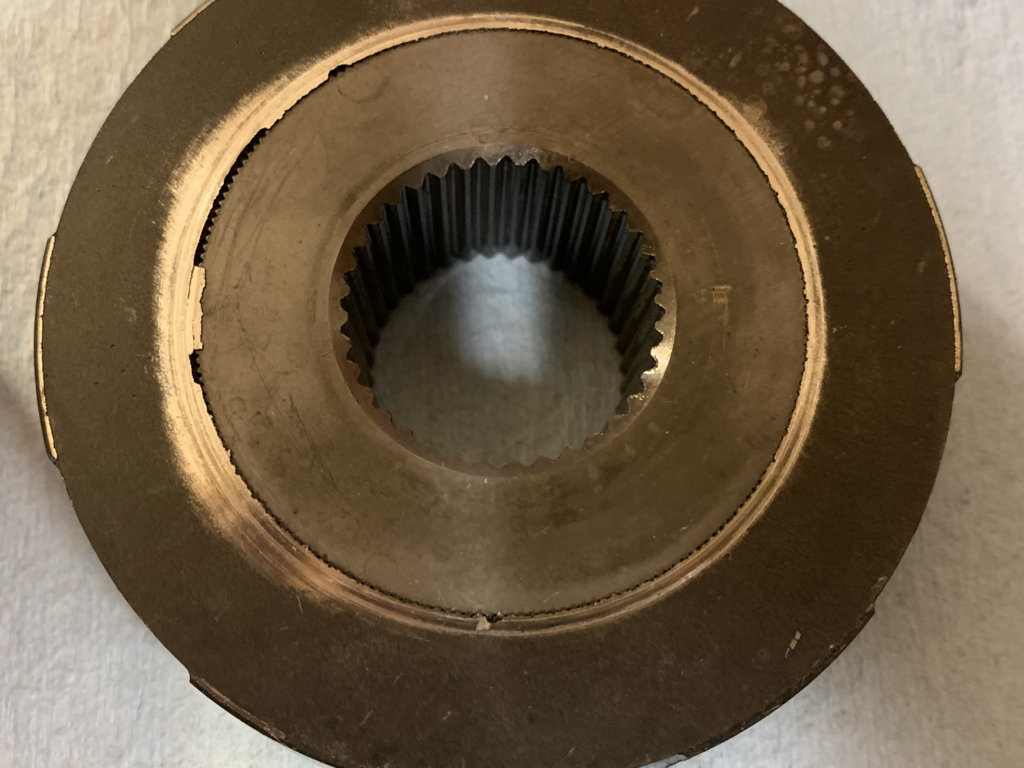

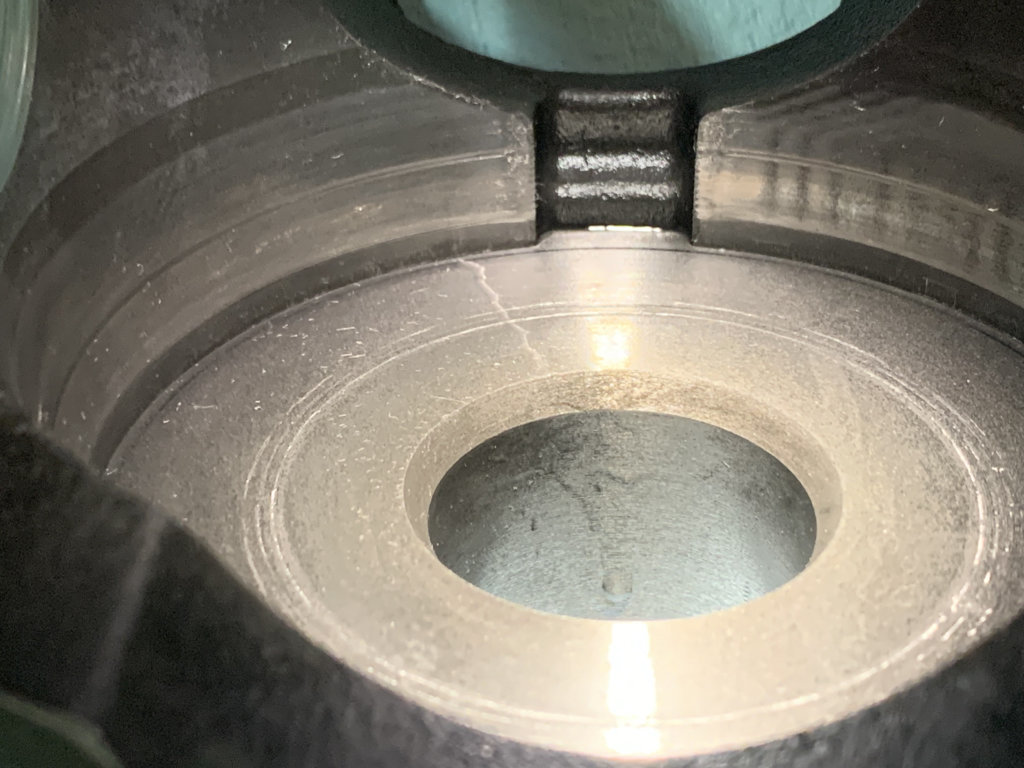

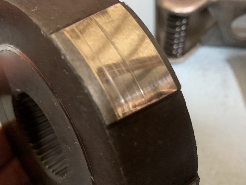

    Friction Modifer. Lots and lots of friction modifier. Like, $400 worth of friction modifier. I think I paid $550 for the Auburn back in the day and have probably put twice that much in oil and FM in to it...
    But even that won't save it from an ignominious death. With less than 10 in^2 of clutch area, the Auburn is hopelessly doomed to fail, unfortunately. Add in what I would consider a manufacturing process failure on the side gear clutch assembly and I'm Team-no-clutch-LSD all day now.
    Clutch 'pads' on the spider/clutch assembly. Yes, that shiny bit is where the clutch material used to be. You can see remnants of the clutch material on the top and bottom of the pad, like an old tube TV watch a letterbox movie...
    Backside of the side gear/clutch assembly. Side gears are pressed in to cone clutch - which is fine - but there isn't a relief cut taken on the inside edge of the cone clutch. It has worn against the case and had several slivers of metal break off and go through the diff. There's one waiting now to break off. A bevel on that inside edge would have prevented that.
    Inside the case. You can see where those metal slivers have gouged out the flat bottom, then been sucked in to the cone clutch to case interface. Also note the heat/chatter marks in the case.
    Where the thrust washer on the back of the spider gears meets the case is also pretty gnarly...
