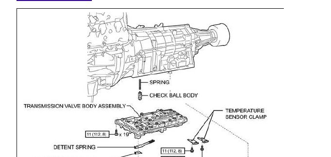

    Wow, yes it is. The Anti-drain back check valve.

    Awesome...guess I'm removing my valve body again...been running without the spring since 07/2021...I am my own worst enemy

    4 years without it? I wouldn't be going back in there just for that.

    Yeah, I'm tempted to leave it, but curious if it changes anything, like the mule kick shifts if I'm heavy on throttle. I was already planning to do a drain and fill since I'm replacing the stock cooler with an aftermarket unit.

    Drain back valve should be the valve that doesn't let the converter drain down after sitting for long periods of time. But if there's one thing I've learned about Toyota's, they are different than anything I've worked on to date.

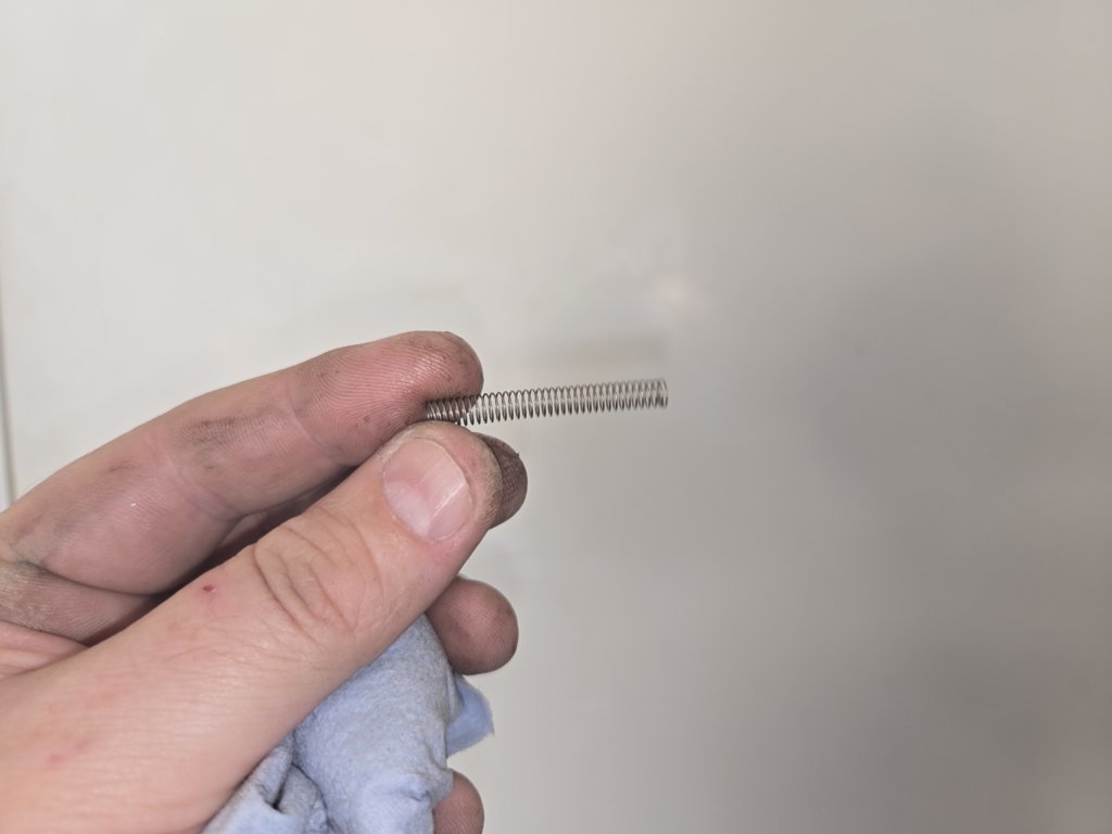

    Is it the original transmission. Extra spring? :rolleyes:Weird how it would migrate to the puck.

    Original trans, only worked on by me. It was folded and stuck inside the outlet port on the transmission. I took off the puck and thermostat and there it was, sitting there like "is this a good time to discuss your truck's extended warranty?"

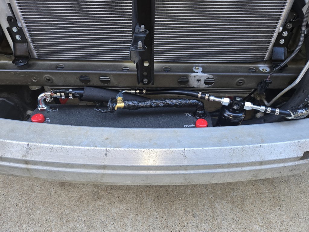

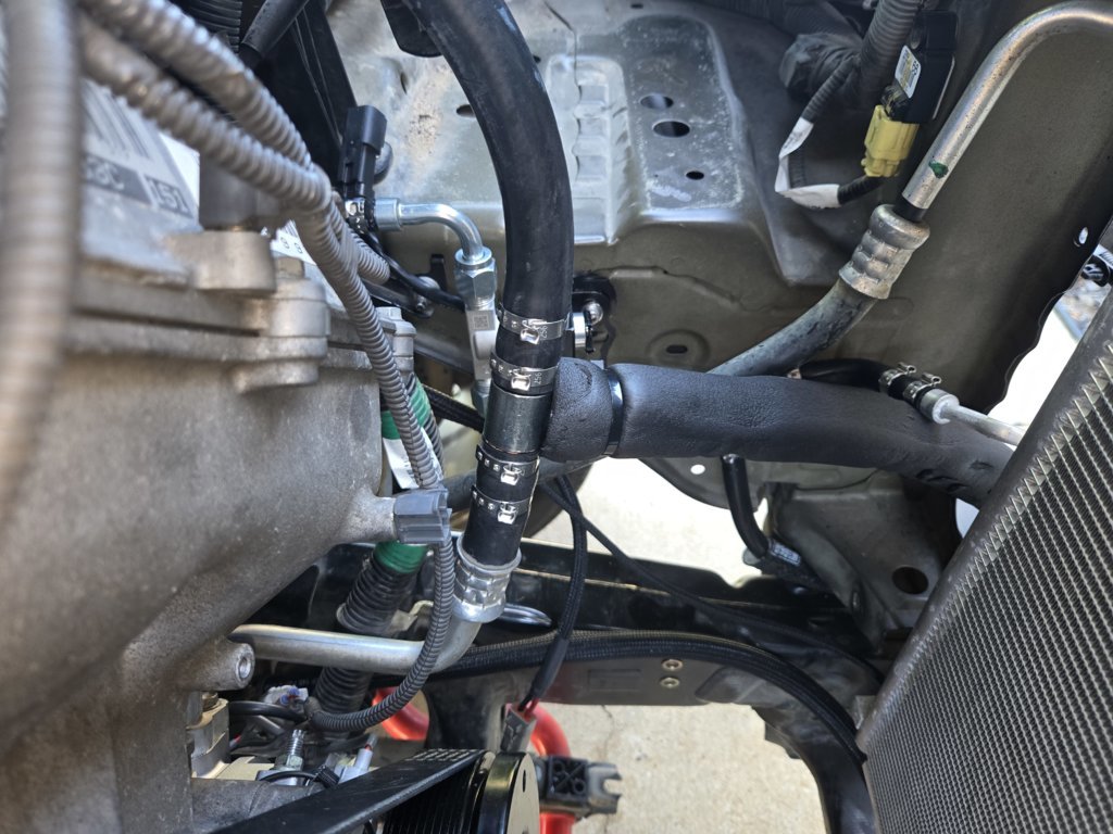

    I finished up the interchiller installation and got my AC system back together...but I'm not happy with that sharp 90 in the soft line, so I ordered a hard 90 fitting and another braze-on connection so there won't be any restriction.

    I'm still trying to figure out how that happened, unless the check ball body fell out and is floating around in the pan as well...the spring is supposed to be on top of the body. Tomorrow I'm going to drain and fill, I'll drop the pan when I do so I can verify.

    The only other spring would be from the tcc relay valve lockup. But you'd be having some major issues if it were out of the valve body. And it's not that long.
