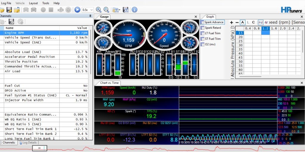

    - Hot idle like poop, the banks afr would oscillate (seen below on the screenshot), you can hear the misfires.
    - few times when cold start, the oscillation would get so bad that I would get misfire codes.
    - it stalled a few times when coming to a stop.
    - while cruising and I give it a bit more throttle, you can hear the misfire then suddenly it downshift and pick up and go.
    It never behave like this until the 750cc/340lph/2.3" pulley went in, been spending last 2-3 months trying to solve this with various help, if you guys can help, please let me know but otherwise I feel like only other choice is try with the 650cc injectors.

    How are the plugs looking, age? Air leaks, vacuum? Pcv valve? Dirty injectors, MAF and TB? Air filter? I know a few dealt with the oscillation but not misfire. Hmmm

    Brand new IKH22 plugs, we ran smoke machine, no vacuum leak, pcv looked good, injectors were relatively new, TB was cleaned, new filter, new Denso O2, new MAF.
    When driving, it's generally really good, only time it ever gave issue is when giving bit of a go you feel slight hestitation and hear couple misfire then it downshift and afr goes into the 12s.

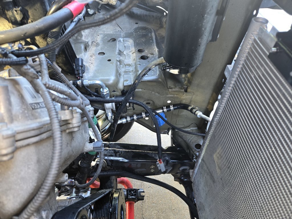

    Mine has the same AFR oscillation at idle since installing the ARH headers. I also noticed misfires idling and at low RPMs since going back to naturally aspirated, probably need to change the plugs and gap for NA until I get the blower back.
    Harrop responded, they don't have the means to bench test the unit so they are going to ship it to SCOL for diagnostics and repair if needed...I guess I should have sent it there first.

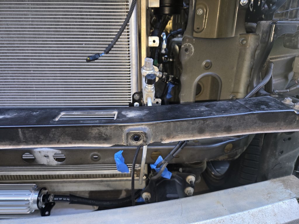

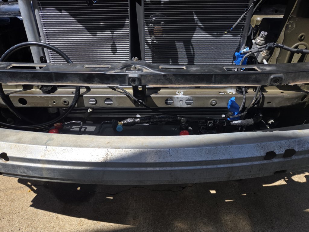

    Made more progress on the Interchiller installation, my liquid line fits perfectly, and I mounted the dryer and interchiller to the crash bar. I need to take the brackets off and paint them, then plumb everything up. Now I need to move my power steering cooler since it's effectively blocked by the interchiller.

    Do you have the primary o2s mounted in one of the primaries or collectors? I've reached out to Keith, he said the O2 position is usually the cause of oscillation problem, this also seem to be confirm by Prospeed and Ekanoo.

    Currently in the collector, I had them in the primaries when ProSpeed tuned it, they welded in bungs and put them there. I moved them to the collector when tuning and troubleshooting with @snivilous, but the reason escapes me, need to review emails. I can move them back and see if that changes anything, but might be a couple days.

    Off the primary (close to the head) was giving really weird AFR readings as I recall, off the collector was more consistent though had the oscillating issue. The oscillating seems very common on all header setups I've tuned, I suspect the feedback loop of the time delay from the exhaust leaving the combustion chamber and getting to the O2 sensor, and the computer calculating the fueling adjustment based on that time delay, gets messed up enough with headers that you end up with the AFR oscillating. In other words, the truck sees the AFR change, adjusts the fueling, but that information is based on out of date AFR data since the exhaust takes longer to reach the sensor, so now the whole fuel trim logic gets messed up since it's constantly delayed so keeps swinging back and forth.
    The oscillating of the AFR also coincides with the short term fuel trims maxing back and forth as it tries to get it under control, but by the time the fuel trim has done its job the command to relax the fuel trim is now delayed so the truck is now over/under injecting fuel and keeps repeating. Increasing the idle speed I think helps this because the exhaust gas flow/speed is increased, so the time delay is diminished enough to not matter---that's why it only happens at low idle and normal driving is for the most part unaffected.
    I don't know if there's a way to fix it with the (simple) tuning in HP Tuners. Moving the O2 sensor to the same distance as factory on one of the primaries I would think would fix it, but you're now basing all your fueling off of one cylinder which has its pros and cons. In Armyoffoo's case the O2 sensor was mounted barely off the head as I recall, so seemed to have weird behavior from the opposite effects of it being mounted so close to the head versus overly far away.
    This is all speculation, I'm not an expert. Take it with a grain of salt.

    I believe 12-16 inches fron the head is ideal in the primary. Too close and the heat will really make the readings off. I was concerned at first by not having it in the collector but been running it in the primary with no issues for the past 13 years. The back pulse of clean air can throw the o2 readings off a bit.

    You are right thou, I was able to get feedback, basically TRD did that on all their sema cars with the 3ur, they ran the primary o2s off one of the primaries and call it a day.
    I'm going to try this method and see what happens, if it doesn't fix it, I guess Motec is the only way.
