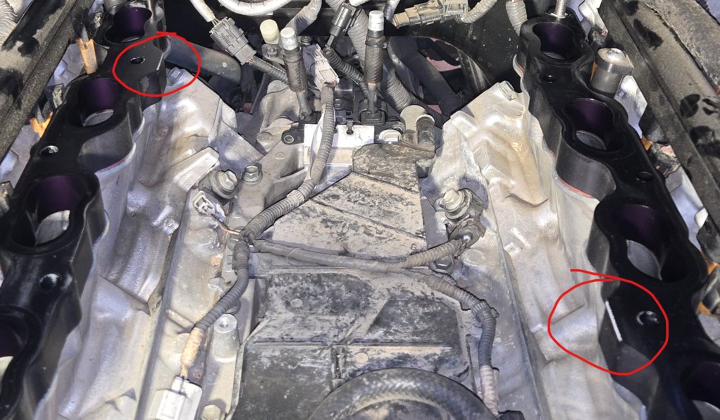

    I usually introduce my issues, one way or another...fml. What's strange is I installed the spacers in November, and this started last month. I agree, at least the SC will be freshened up.

    It's odd that it shifted at all. You'd notice it rubbing during install no doubt.

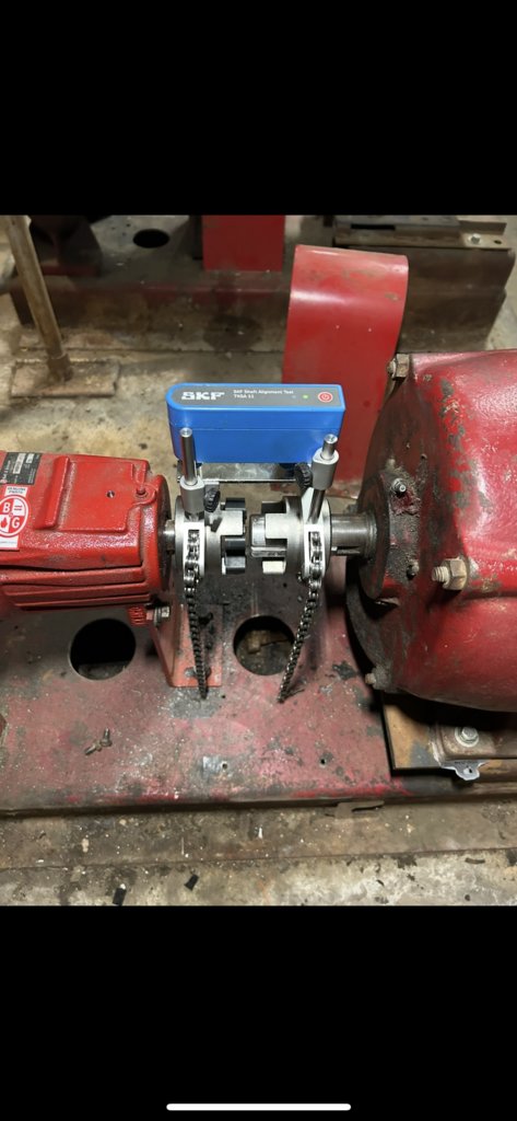

    I’d say you found it my dude! This condition is known as “soft foot” on rigidly mounted rotating equipment. Just worked on aligning a shitty old pump with soft foot today actually.

    Yeah, I didn't notice anything when I installed the spacers. The SC seemed to sit flush and I was able to torque the nuts/bolts to spec with no issues, and no vacuum leaks when I smoke tested.

    Always frustrated me on the ships aligning pumps...no fancy tools back then.

    The electronic alignment tools make it so much easier for sure. I’ve done it plenty with the dial indicators as well. Not enjoyable.

    The new laser machines make it stupid simple. Just put a requisition in for an Easy Laser XT770 at work, to supplement the two 660's we have.

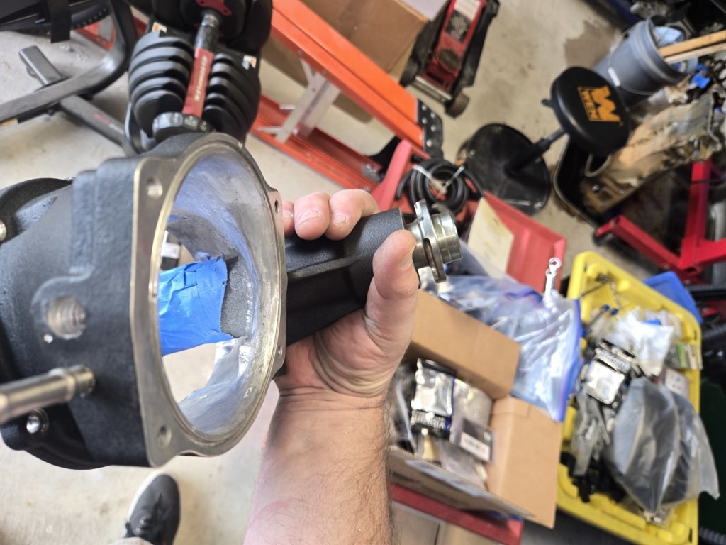

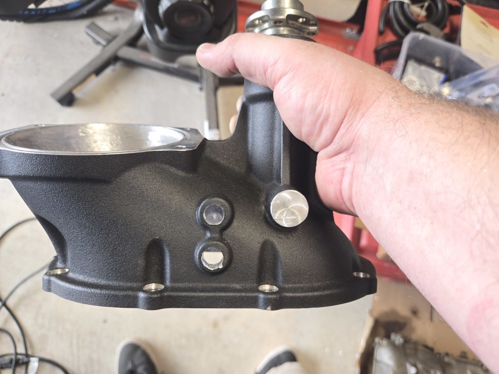

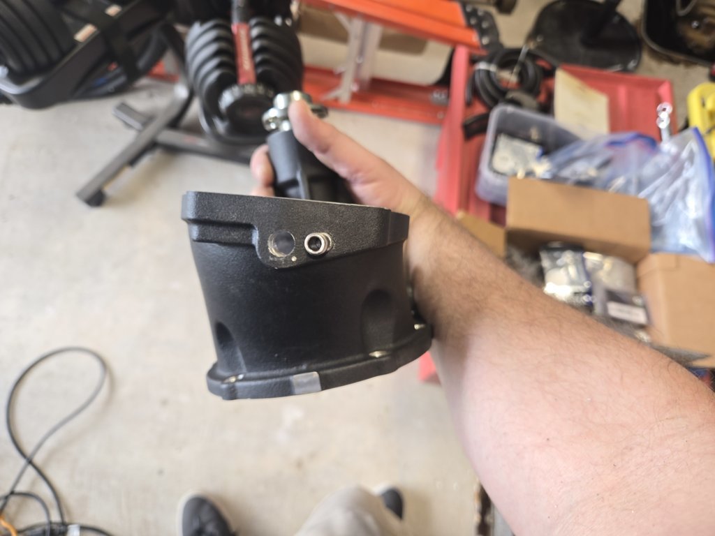

    Finished porting my GM snout, need to clean it up by hand since the cartridge rolls aren't getting in far enough. Also removed the vacuum barbs and drilled the holes out to tap for 1/4npt, going to install 6an-1/4npt fittings in place of the barbs.

    Looking good! Nice to eliminate any un metered air intrusion
