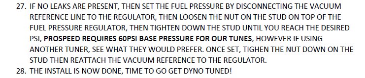

    ProSpeed requires 60PSI for their supercharged tunes, it's not uncommon, most injectors come with data for running at 58-60PSI

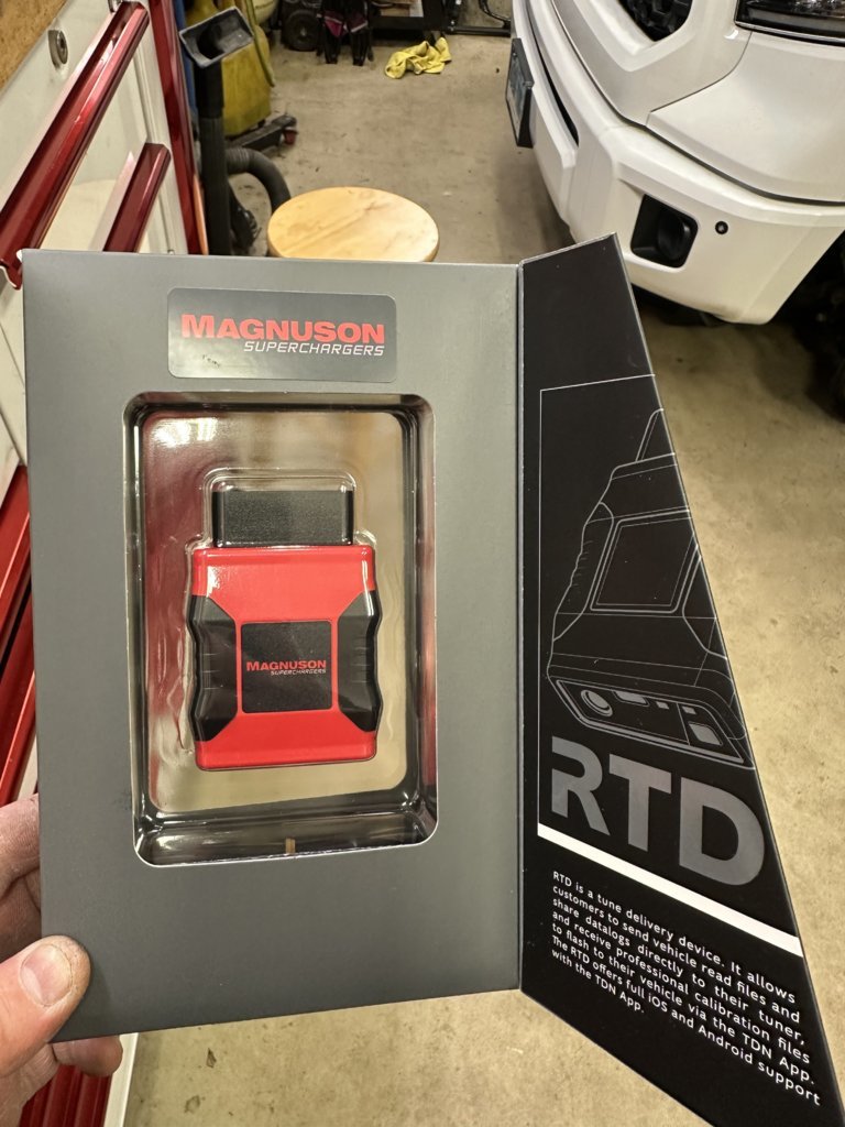

    Anyone out there install a Maggie 2650 on a 2018 Tundra. Apparently I have to get software from Magnuson/HP tuners and download it on my laptop and then hook up the RTD tuner(which came with the Supecharger) and update to the latest tune from them. Just asking to see if anyone went through this and gauging the difficulty level. Apparently the tune is specific to the 2018. Thanks in Advance!

    pic of the tuner

    This is standard even on the 1.9 and other blowers if sticking with the factory tunes not difficult at all.

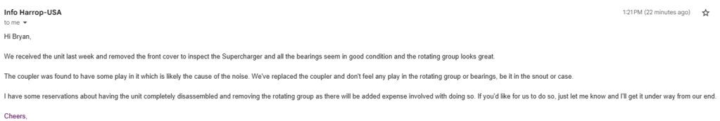

    Response from Harrop on my head unit inspection, I've asked them to disassemble the unit and dig deeper.
