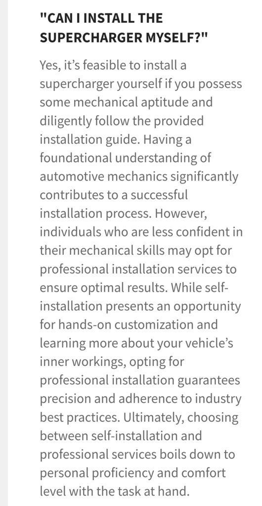

    Interesting...
    Pretty sure their site tells you to only use their certified installers.

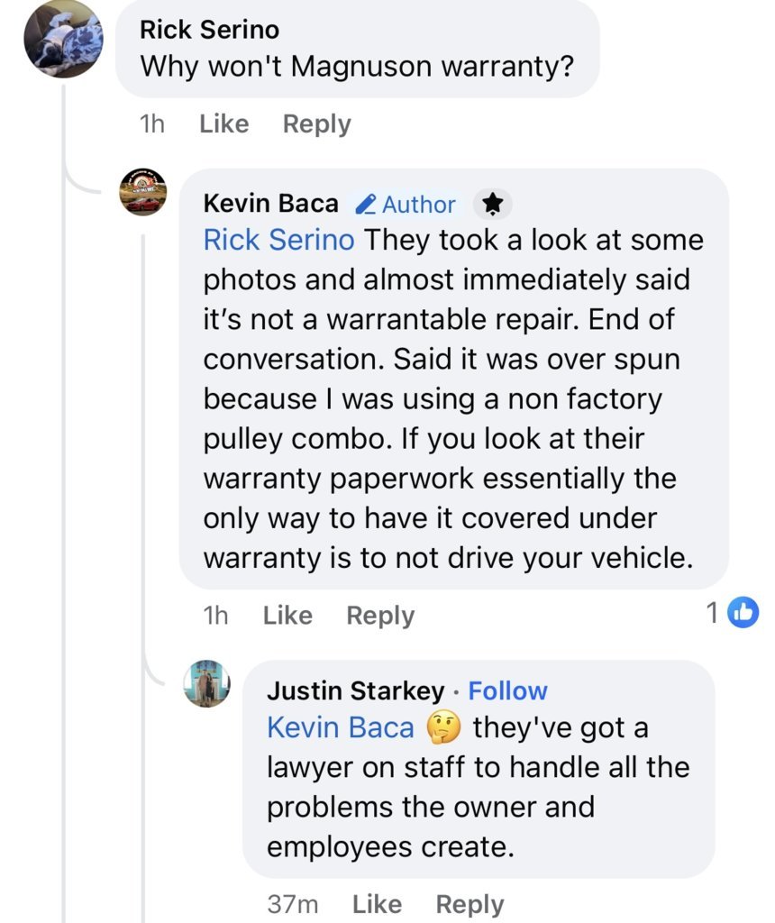

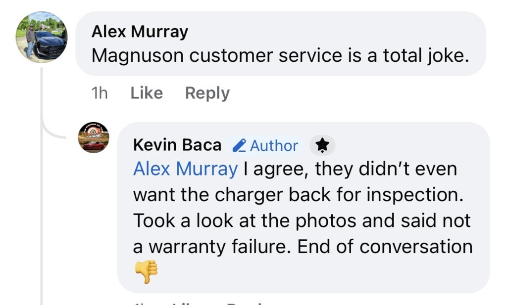

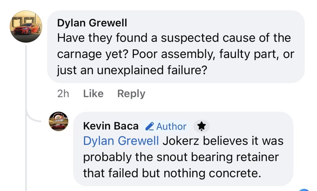

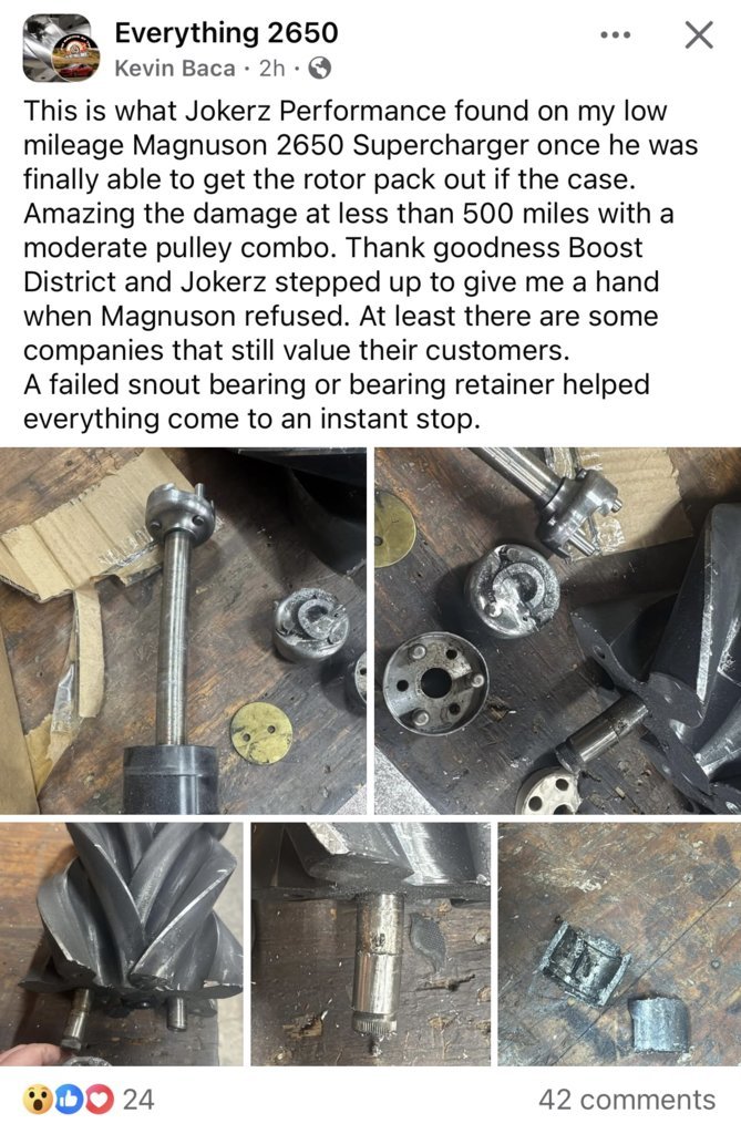

    Just saw this post, and thought it was worth sharing given the predominant topic as of late. Boost and warranty are on different spectrums. 500 miles on it! Clearly it had a defect out of the box, and no dice on warranty repair.

    When I spoke with them he was pretty adamant on stating any alterations, pullies, shooting water methanol would void the warranty.

    Hate to be that guy but if you modify something you run the risk of voiding the warranty. Not saying it should have failed, just that you pay to play.

    They can be pricks if they want to be, that’s their right and they put it in writing. My point is I wouldn’t expect much out of them as far as warranty coverage. Easy fix, buy a Harrop or Whipple.

    Not to keep this going but on their website...

    That's some gnarly damage, hopefully the damage was limited to the supercharger.

    Dang, that's crazy. Wonder if the failure was purely because of his mods or if the unit was defective from the get go and his mods just made it fail way, way earlier. Maybe without the mods it would have lasted longer but eventually still failed within the warranty period.

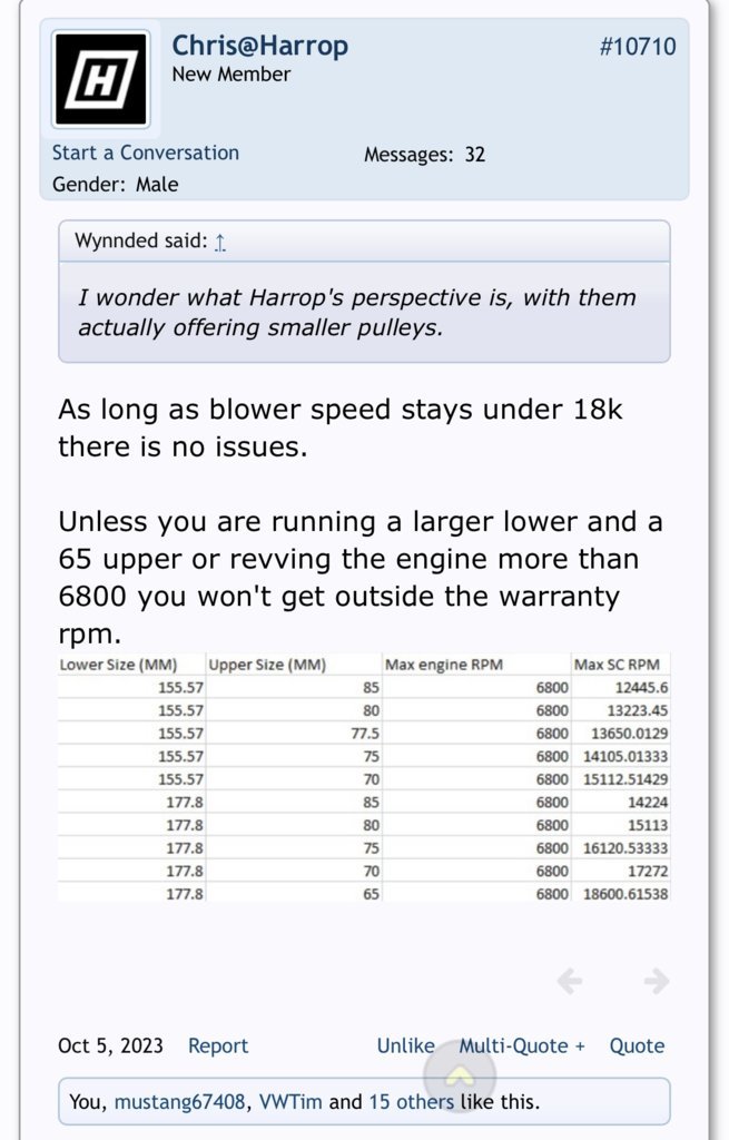

    My understanding of TVS superchargers are the bearings are made to last indefinitely at 18,000 RPM (literally never fail) and sure there are cases where they still do. People run them at 24,000 RPM all the time with no issues. He surely wasn’t spinning it that fast on what he describes as a “moderate pulley combo”. The snout bearing retainer appears to have failed, which would cause catastrophic failure at any RPM. Looks to me like a faulty unit that they conveniently decided not to help him out with.

    So, water methanol voiding the warranty I can understand.
    Swapping pulleys that keep the blower speed below that 18k rpm threshold - I don’t really understand that voiding the warranty. I would think that as long as the unit design limits aren’t breached, there should be zero issues with it.
    When I reached out to Harrop, they basically told me swapping pulleys was fine for the blower, but might not be good for the motor…
    For those of us that live at altitude other than sea level, a smaller pulley is a necessity just to get stock blower power levels.

    This is a good time to point out that the older TRD TVS1900 has a drive design that has much better shaft support. With two bearings giving the drive shaft a ride inside and totally supported by the cast snout prior to the coupler, it’s straight beef. The new larger TVS 2650 has a single bearing out at the pulley, and replies on the rotor pack bearing to support the shaft after the coupler. The TVS 1900 for the 3.5 2GRFKS in the Tacoma has the same less durable design.
    With that said, the newer single bearing design with exposed driveshaft certainly will flow better. It’s also spinning significantly slower to achieve the same or greater flow numbers… but then the rotor pack bearing has a larger heavier rotor, it would be interesting to take a deeper dive and try to factor everything in.
