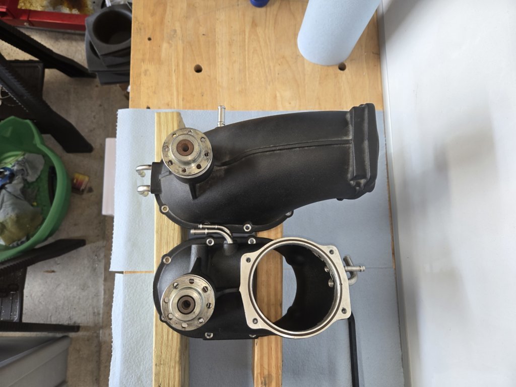

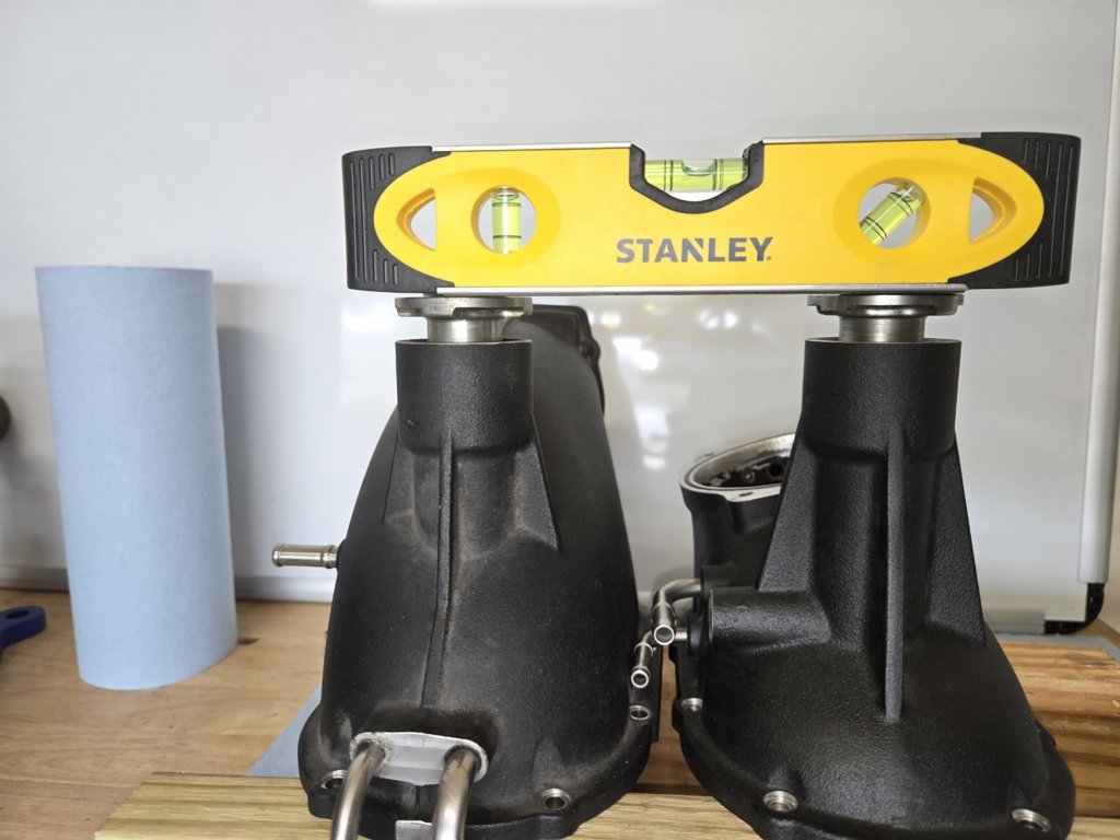

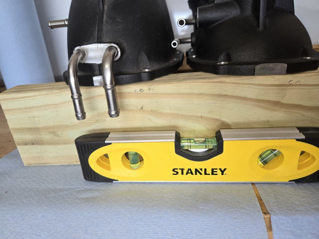

    With me, it's not about the money or the time, it's about being disappointed every time someone touches my truck.
    Speaking of which, I just burned 3 hours swapping my GM snout for the Tundra snout, adjusting lines and my intake tube. It occurred to me, that I don't know the mileage/abuse the GM snout has seen since I bought it used from an Aussie off eBay. I also took the time to verify the pulleys are in the same plane, even though Harrop already said they were.
    I'll let the loctite 518 setup for another hour or so before I go out and get disappointed in my colossal waste of time...

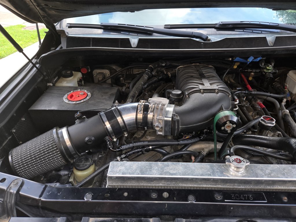

    So I was doing a little more research on getting air temps down as I’m seeing a 30-35+ degree difference over ambient on the highway. Not sure if this article has been shared but I know we’ve discussed thermal insulation under the blower and spacers to get the supercharger up off the motor. Reading this makes sense on the Harrop to run the spacers to get that temp sensor away from the motor for more accurate intake temp readings.
    https://fiinterchillers.com/tech_articles/upwards-discharge-superchargers-vs-downwards-discharge/
