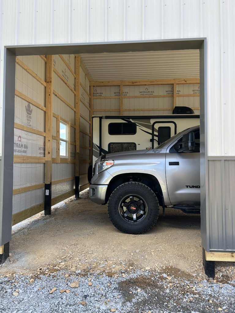

    A little test fit. Still lots to do for this project, but feeling good about the space I’ll have to monkey around with.

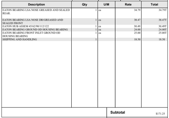

    SCOL says they don't have the snout bearing details, rotor bearings require a full rebuild, and will rebuild it for me if I ship it to them. Harrop said they would inspect and rebuild, so I'm shipping it to Harrop's Ohio location.

    SCOL called me and they have the Harrop snout bearings...going to try that before shipping the rotor pack.
