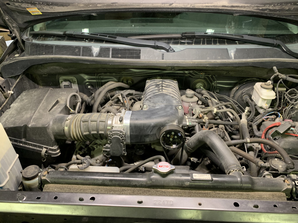

  14. Apr 22, 2025 at 7:35 AM
    e30cabrio
    Oct 20, 2017
    #10410
    6,491
    West Valley, Phoenix, Az.
    Boosted 2013 Sequoia TRD FAUX
    After 5 days on the 5-40, there is only a minor puff of blue/gray smoke at startup. I assume that indicates valve seals? Possibly worse in #8 since it got oily (not anymore)
    HulkSmurf14 and blenton like this.

  19. Apr 23, 2025 at 2:42 PM
    blenton
    blenton New Member
    Jul 15, 2022
    #80740
    3,190
    RMA received from Whipple. Guess I better find somewhere to park this thing and get started on pulling the blower. Any tips? The whipple appears to have easier access to manifold bolts and such than the Magnuson but I'm not sure how similar/different it would to a 2650. I'm not terribly concerned about my ability to pull it, just hoping I don't miss a 'gotcha' and fubar something else.
    e30cabrio and HulkSmurf14 like this.

  21. Apr 23, 2025 at 4:01 PM
    blenton
    blenton New Member
    Jul 15, 2022
    #80740
    3,190
    Haha. I think I have some A&W around here somewhere somewhere. Might have to break out the Weinhards... that's about as beer'd as I can handle.
    Ebrperk and HulkSmurf14[QUOTED] like this.
  22. Apr 23, 2025 at 4:03 PM
    reywcms
    reywcms New Member
    Dec 20, 2021
    #72040
    7,485
    Rey
    North Plains,Oregon
    2017 Tundra Platnium
    Too many mods to come
    Nope super easy didn’t take me anytime at all. Do use caution reinstalling etc with the gaskets and the torquing of the bolts
    Mdl and HulkSmurf14 like this.
  23. Apr 23, 2025 at 5:42 PM
    HulkSmurf14
    Aug 9, 2019
    #34377
    2,781
    2014 Tundra Limited
    Tastefully enhanced...
    That's just as good! I am certain that rock 'n roll helps turn wrenches easier, though.
    blenton[QUOTED] likes this.
  24. Apr 23, 2025 at 5:46 PM
    blenton
    blenton New Member
    Jul 15, 2022
    #80740
    3,190
    Thanks. Will do.
    Whats the easiest way to drain the coolant without making a mess? Pull a fitting off the pump down low in the bumper?
  25. Apr 23, 2025 at 5:52 PM
    reywcms
    reywcms New Member
    Dec 20, 2021
    #72040
    7,485
    Rey
    North Plains,Oregon
    yea that’s it
  26. Apr 23, 2025 at 10:54 PM
    blenton
    blenton New Member
    Jul 15, 2022
    #80740
    3,190

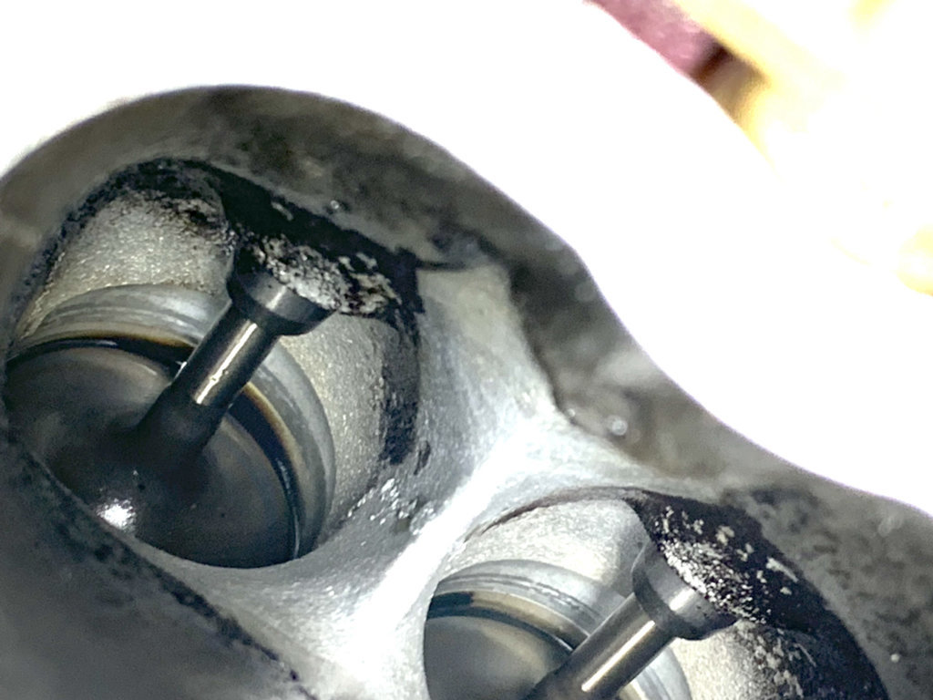

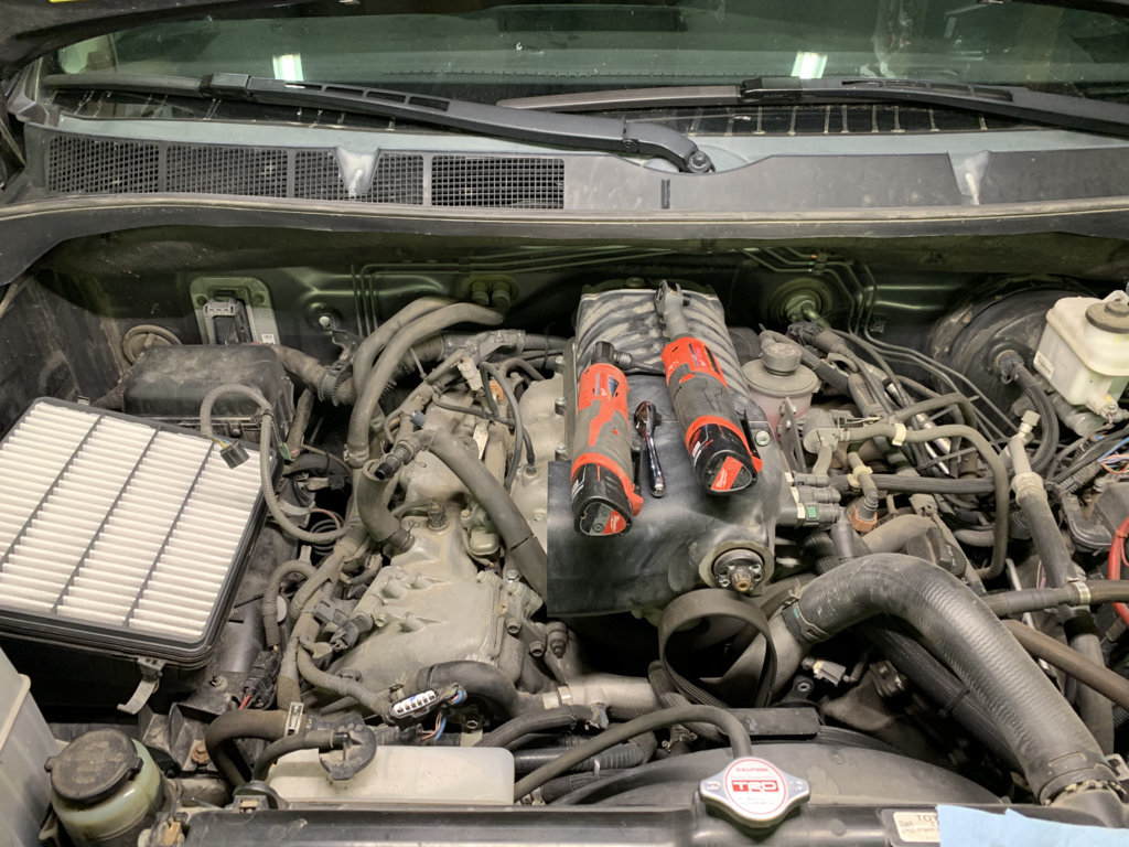

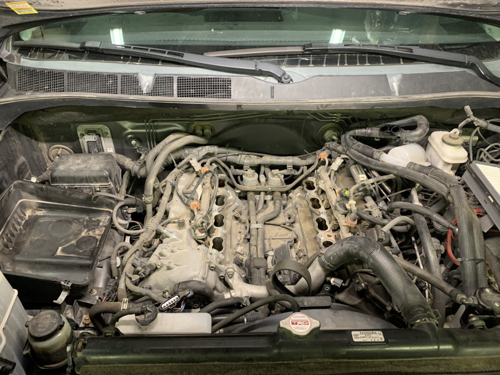

    Supercharger is out.
    Took about an hour, half of that fighting the coolant pump then reading over the install instructions to find what I'd missed... I'm sure the tech is still laughing at me fighting the pump; he clocked the hose clamps in such a way that you couldn't fit pliers, your hand or handss, and the coolant tube all in the same space at the same time. Long nose, angle needle nose, long angled needle nose, pliers built especially for hose clamps, NOTHING had good access to the clamp in a way that you could actually get purchase and squeeze the plier handles! I ended up unmounting the pump from it's bracket, sliding it out a little bit, and getting enough room to barely pinch the clamp and clock it to a spot with better access. Then I was in for a light misting of coolant as I popped the hose open. I mean, better than shower, but it was like taking a leak when a sudden gust swirls around you - you're not drenched but you know you've been got.
    Otherwise, it was simpler than I expected. Then I had to heft that beast from of its throne atop the motor.
    @reywcms I emailed Whipple to ask, but did you need to drain the oil from the SC before shipping? Coolant is drained as much as possible without turning it over for the night.
    My intake seals were pretty oily, but looked intact. Nothing folded over or pinched. I did notice what looked and smelled like fuel from the top of two injectors where they meet the fuel rail. There was a pretty heavy fuel smell when I cracked the SC free from the intake.
    And I got a good look at the backside of the valves. Not too bad for 223k miles.. I'll clean up the runners best I can before reassembling, but for now they are taped shut.
