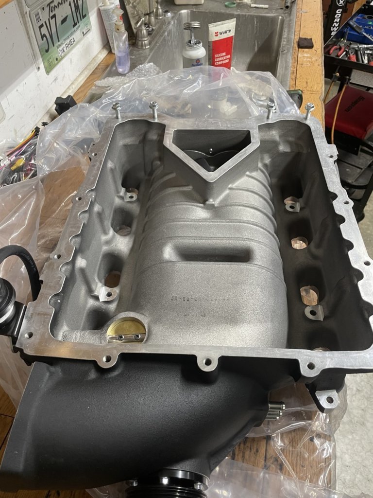

    #146 picture looks like a black O-ring on the main body of the blower. It's probably pre installed so no need to mention it. My LSA supercharger is the same way, and while I don't remember on the one 2650 I installed, there's no way there's not a gasket.

    I was thinking the lid has it embedded or something.

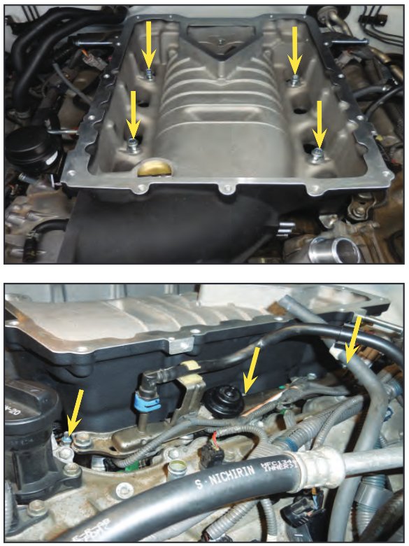

    Correction, it's on the lid according to these pictures I found on Google, which apparently are on the forum somewhere but can't find a link to the post:

    Based on these pics, I'd guess that it was an o-ring in a groove on the upper half. I don't recognize a groove on the bottom.
