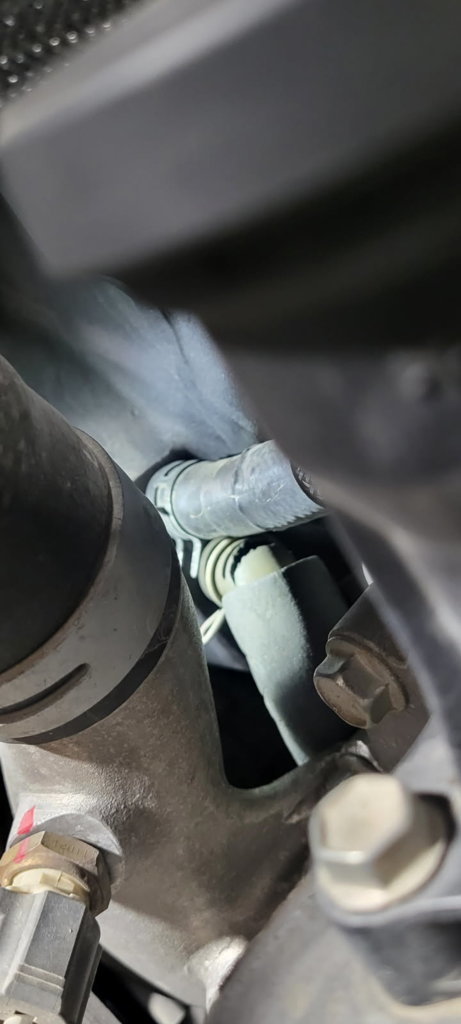

    just finished working on a 2021 S/C tundra from alabama..
    Lean codes P0171/P0174
    found a broken PCV hose..JUST an FYI

    P0171 has been PCV related every time in my experience...or another vacuum line not connected. Nice find! They hide those things!!

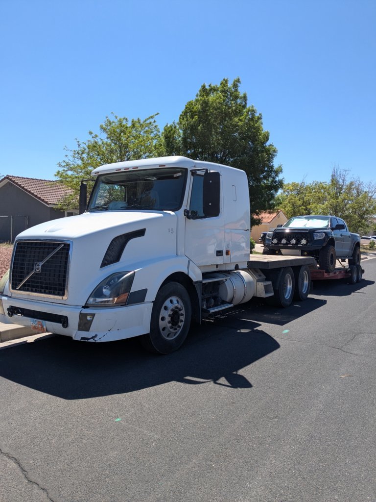

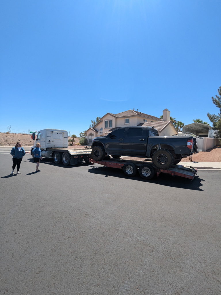

    Tiny is a unit! Last I checked was a bit over 9mpg round trip with cruise set at 78mph. Too bad the flat bed is too short for the Tundra, upside is my trailer doesn't have fenders since Reys truck is so wide it overhangs both sides of the deck :rofl:

    Hahaha that's a solid pull efficiency! Good thing your trailer fenders aren't on! I could.image you building a ramp/bed extension on the semi to maximize that flatbed! You should've thrown the camper on it for the trip!!

    That's been my thought, could add a cradle that indexes to the flat bed and slides into the hitch receiver without too much hassle. But that's a project for another day, especially now that I have another project at my door step :D

    That hose is a bugger. :(

    That hose was my sole reason originally to get a catch can.

    And that's why I have a catch can....Thank You

    It sure as hell influenced my motivation. At least now I know where I'm least likely to have an air leak.

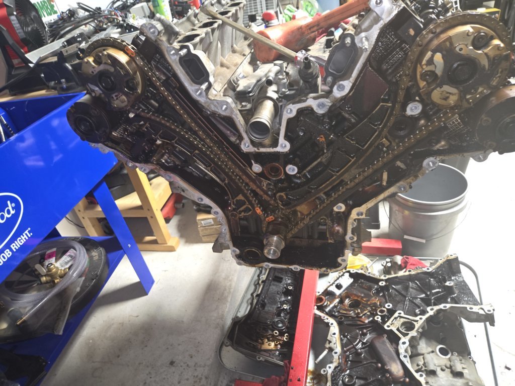

    Came out of a 2010 Tundra with 170k miles. I'm guessing regular oil changes every 50k miles, whether it needed it or not.
