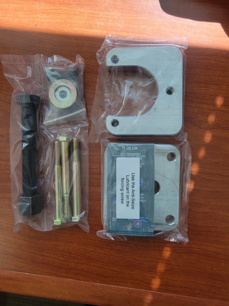

    I bought x18 qt's and used x10, which included the check drip that started as a deluge... I'm going to put x1 additional qt in when I throw the cat plates back on...~1500 miles before that happens...
    On a side note...things are getting more serious since this showed up!

    Did you get that from the eBay seller? I would have shipped you mine to use if you needed one. I think @e30cabrio has the same puller also.

    Damn, I sure did get it from eBay! WHY DIDNT I ASK?! Haha lemme see how this weekend goes and I still may ask to borrow and return this bugger...THANK YOU IN ADVANCE!!

    The anti-seize helps A Lot!

    That's the one that came with my ebay pulley.

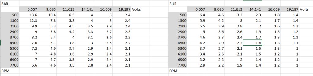

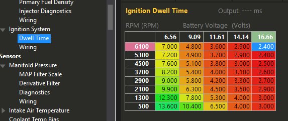

    Double-checking my Haltech configuration, does this look right? The axes are limited to the number shown, so I can't add any additional values. I just want to make sure I don't screw anything up in the base configuration.

    Here is the Boomslang wiring documentation, and some screenshots of what I have configured so far in the Haltech Elite 2500. Adjustments for fueling and dwell are specific to the 8AR coils and Five-O 750cc injectors. Knock frequency is based on 94mm piston size.
    **Note, I haven't adjusted any of the values in the base fuel or base ignition tables, only the axes for RPM and MAP**

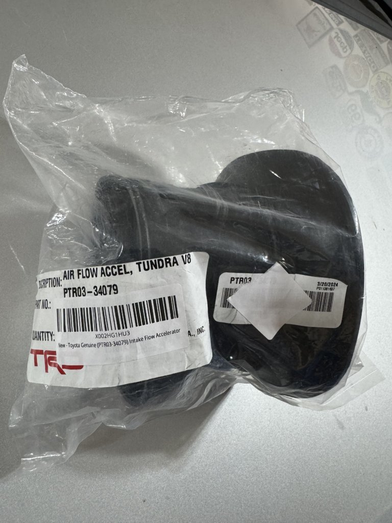

    TRD air flow accelerator arrived today. Going to be installing this on the OEM lower airbox along with the SABM which is currently in route.
