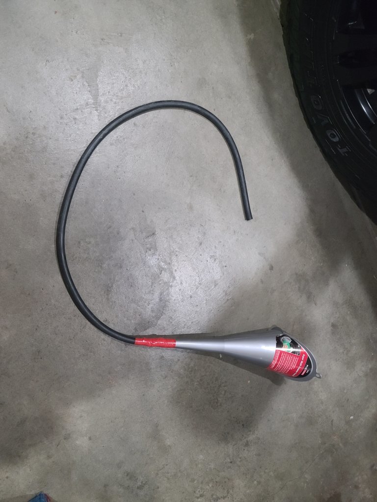

    Oh just a heads up to make life easier when refilling the trans. All the transfer pumps out there are shit imo. So went with simple funnel through engine bay with 5/8" outside diameter hose. 5/8" fits the Trans fill hole tight making it easier to fill quickly. May save some unnecessary waste of time using a pump
    Abell207, HulkSmurf14 and e30cabrio like this.

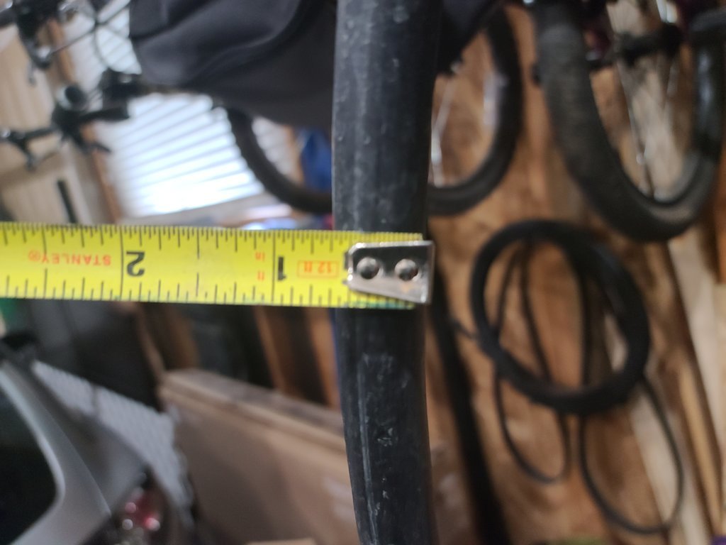

    Good call and I forgot to suggest...transfer pu.os are still annoying and messy...I bought 10ft of 1/2" ID tubing and a right-angle barbed fitting and threw a funnel on...made it so much easier to fill. Cost me $18 at Ace Hardware for that easy button!
    ARES35[QUOTED] likes this.
