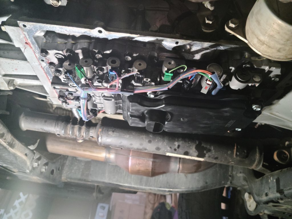

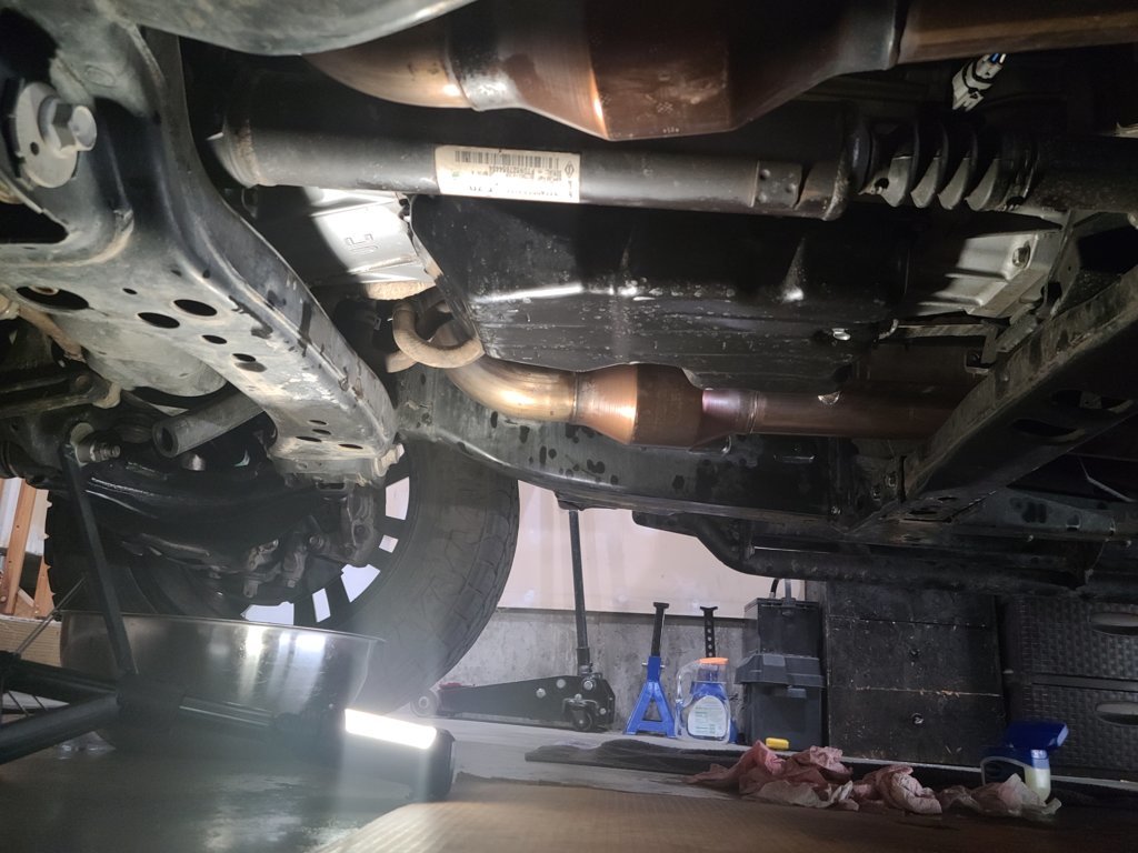

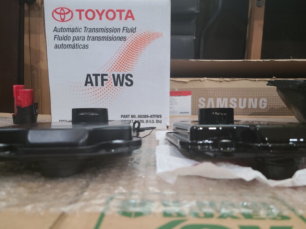

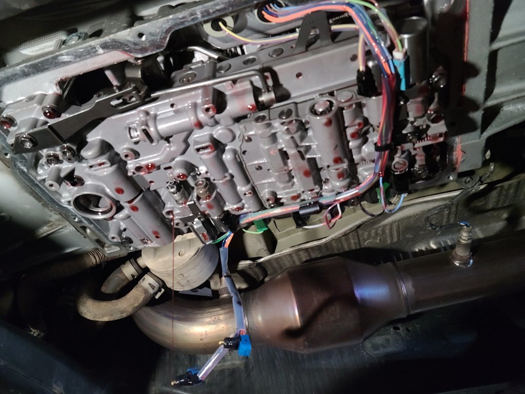

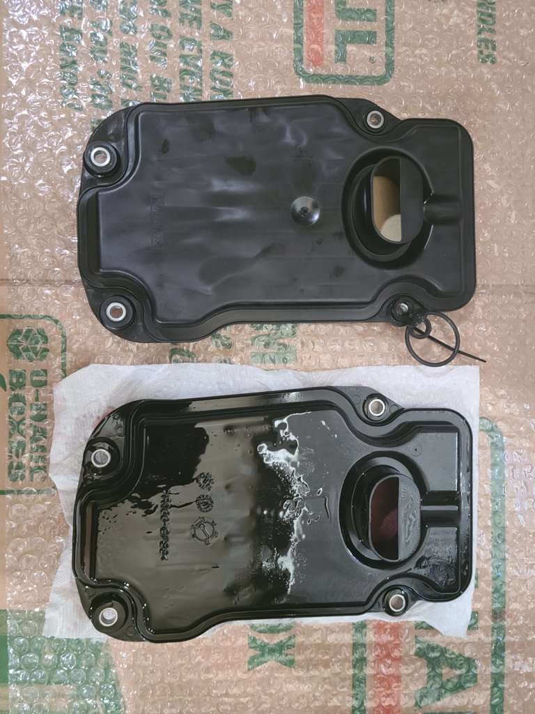

    Was able to break free from work so started to rip in. Letting it drain for now, its a messy ass job. Filter wise they are exactly the same. Part numbers are a perfect match.

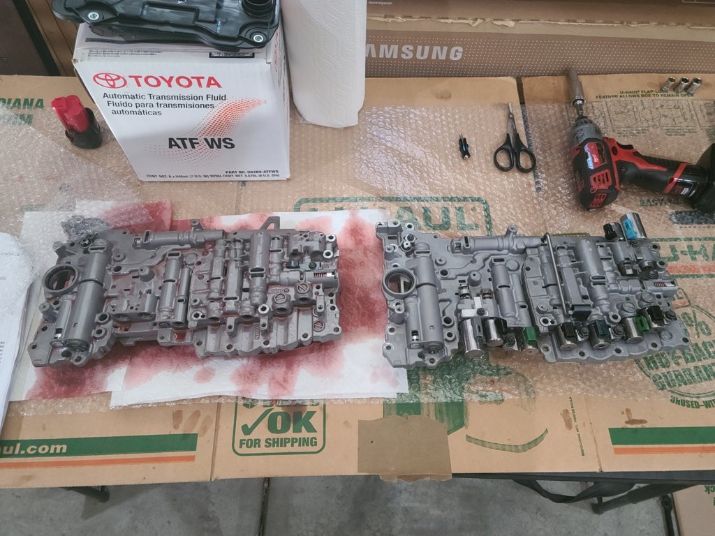

    Just wanted to say be careful of the solenoid install. The inlet screens can come off if forced in. Heard a few instances of this happening.

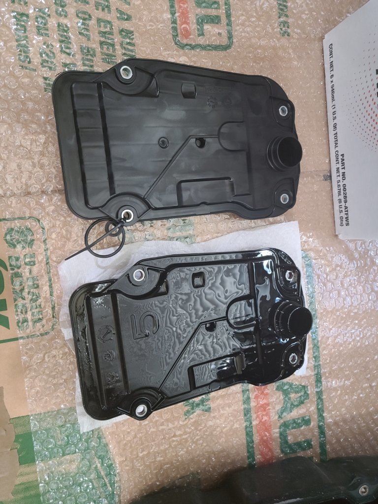

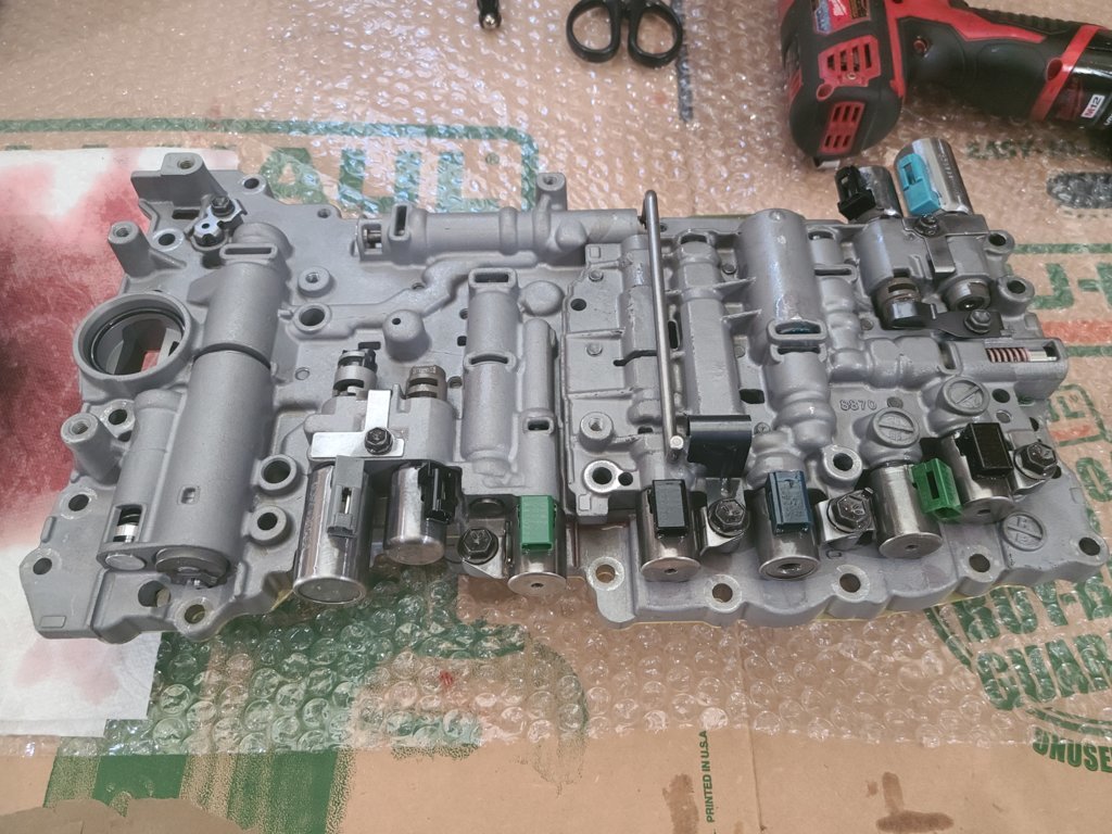

    Got it back together smfh. Most frustrating part was the B1 and C3 accumulator and check valve falling out. Had to strong arm the valve body and set those at the same time, then get some bolts started to take some weight. Was a bitch. This is where a hand would have been extremely helpful. Don't have a transfer pump to refill so off to the auto store.

    That's where @armyoffoo mentioned having a plate to bolt in hold them in place and sliding it out of the way when vb is ready to be bolted in.
    But I always suffered and hoped it all stayed in place. Haha

    That's genius! I missed that memo and suffered :rofl:

    It was in the WAT YT video too...it saved me a lot of "ready to go" curse words!

    Alright transmission filled and trickled per Toyota specs. Now just have to hit the road and test her out.....after this damn snow storm
