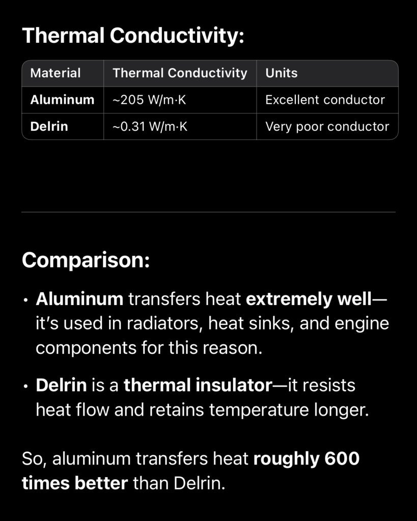

    I’d probably do delrin if it holds up ok due to likely less heat transfer from the block to the supercharger tub on supercharged trucks than aluminum I would think. Thermally isolating the SC is probably the greatest value of them IMO.

    Guarantee the spacers are useless in every possible metric.

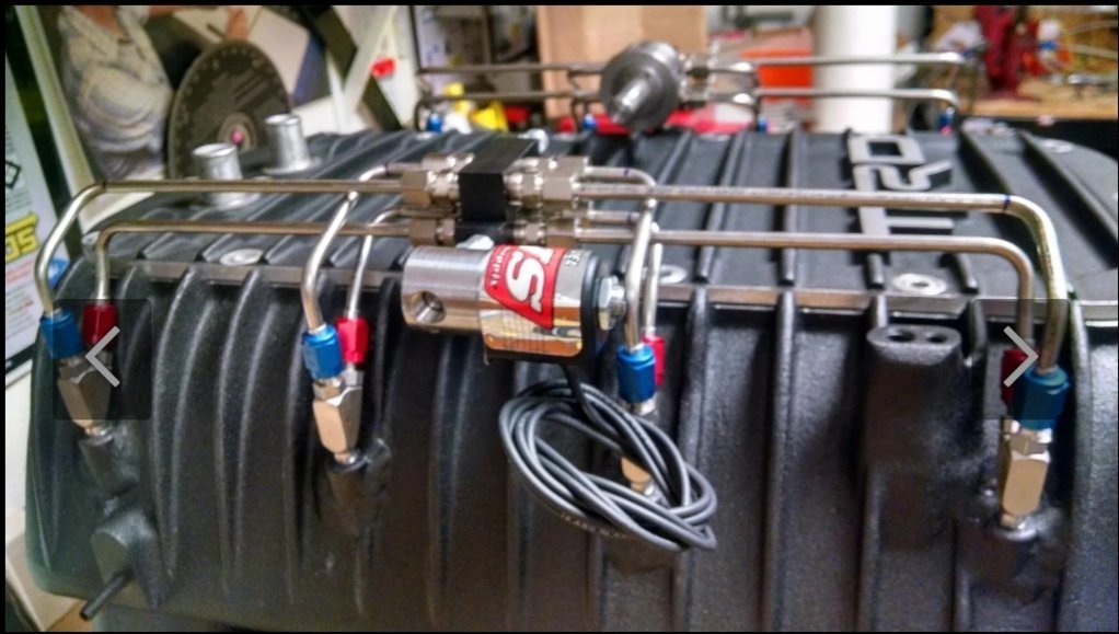

    I know I posted this before but the placement of nozzle on the intake.
    like this guy did back in 2015 with his built engine. We all thought he was crazy the way he was talking but he dumped some serious money in his build.
    I could send you my little Maggie for some methanol nozzle ports...:D
    If I need to I can add another nozzle pre TB if I go for more HP.
