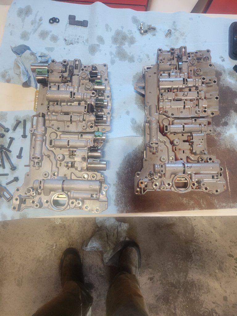

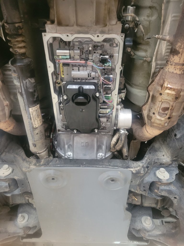

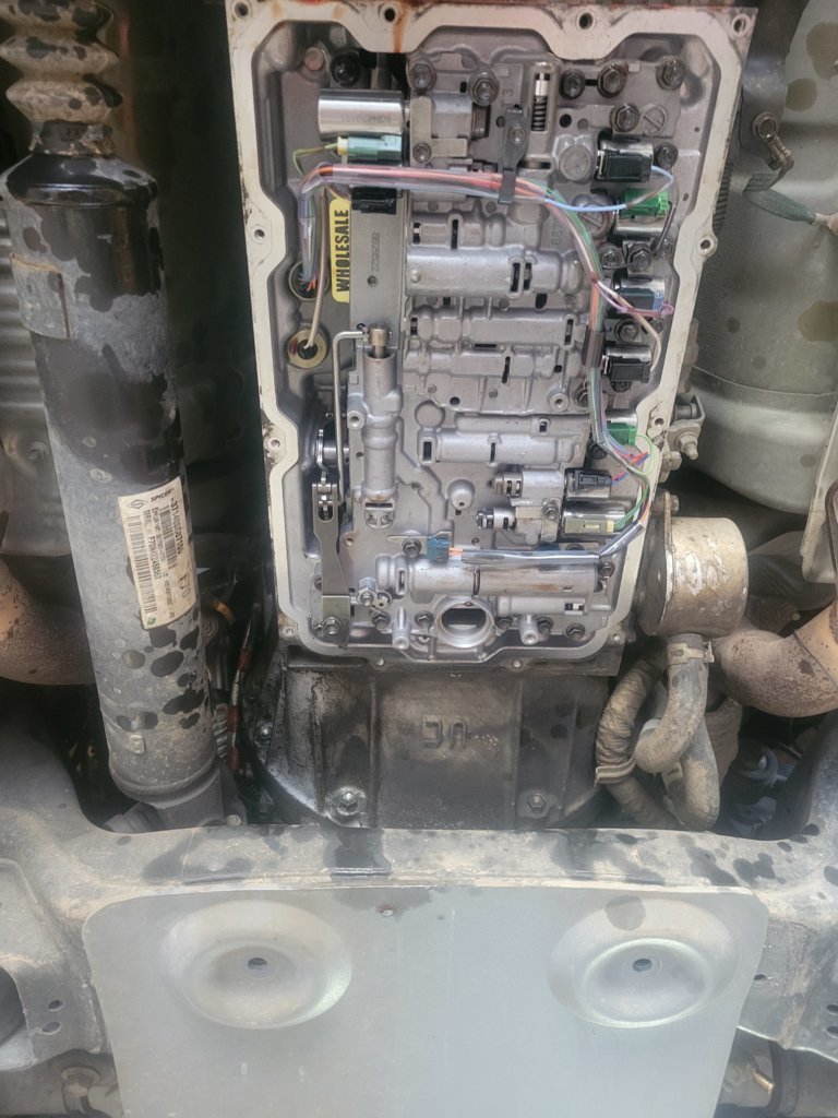

    So I got her all done and buttoned up...it definitely took me 4 hours at least...but I'm happy! The new pan is a beast and I've opted to not throw on my cat shields until my next oil change in a couple thousand miles...those took me longer to take off than I'd like to admit! I only used and needed 10quarts of fluid through the whole project. A lot continues to come out once you remove the VB...it's an f'n mess but kitty litter kept it mostly contained.
    Driving impressions: f'n legit! Solid shifts, and they don't hang or make me want to curse if I was on the phone. It just feels like good, clean shifts. It definitely tightened up what I experiencing as slop. Gear engagement from Park is quiet and no longer clunks (thus far) and full WOT runs did nothing but make me smile...definitely holds so much better. Had I known about these VBs earlier in my ownership, it'd been the first thing I do.

    How many miles on your truck? Any trouble getting the pan bolts out? That is the only part I’m not looking forward to.

    I crossed over 106,664 miles and had zero issues with bolts anywhere on the disassembly. I did do a fluid swap at 80k with new filter so I'd imagine that's a bonus for today's work and no stuck bolts. They only have like 39 inch/lbs of torque so they aren't hard to pop off with an impact driver. You got this...I was dreading doing this but man, that video that WAT did was super helpful! Just remember, their "driver's side" is opposite of us NA owners! I used x4 cans of brake cleaner to get the bell.housing and bits factory clean, and one in the existing VB to send back...to WAT or Cruisers, I know not, yet...

    Good to hear on the pan bolts, mines the remanufactured so fingers crossed that they come easy. Great falls for me and HS in Billings. I'll be heading to Billings in July

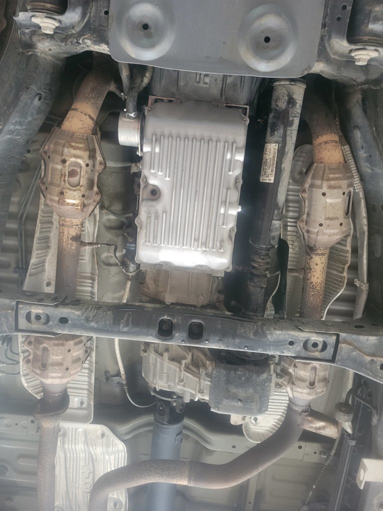

    Is that a PML transmission pan?
    I love it

    Yes sir, it's a PML transmission pan...got it in the GB deal a few months back. B&M also has a great pan available that @reywcms is rocking with success!
