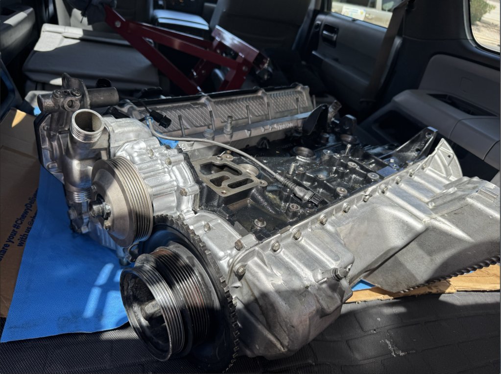

    My next new engine is ready to become....
    See the red thing just past the motor? It's my stand, he has 12 & they are full.
    Good news is I go to the front of the class.
