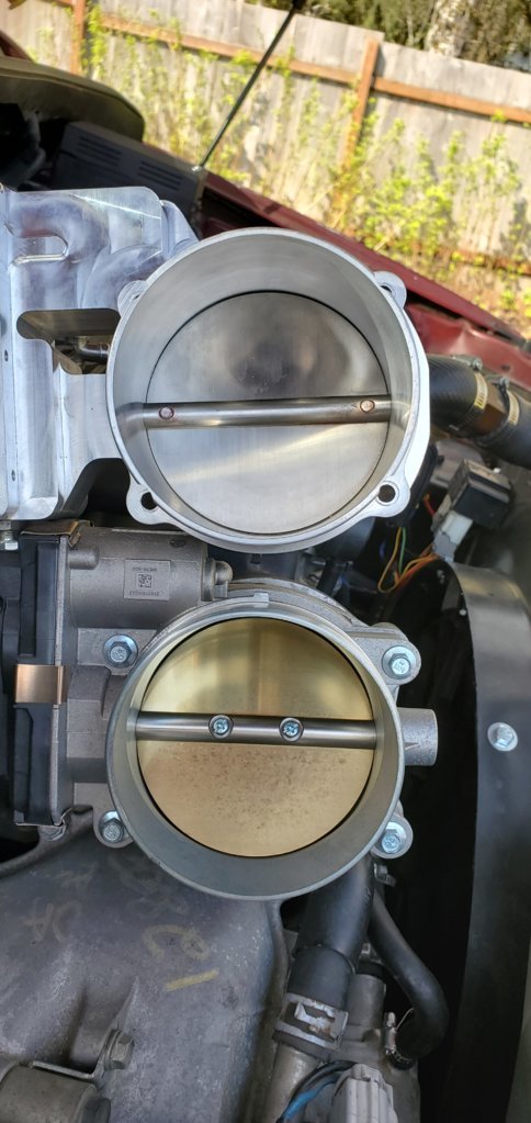

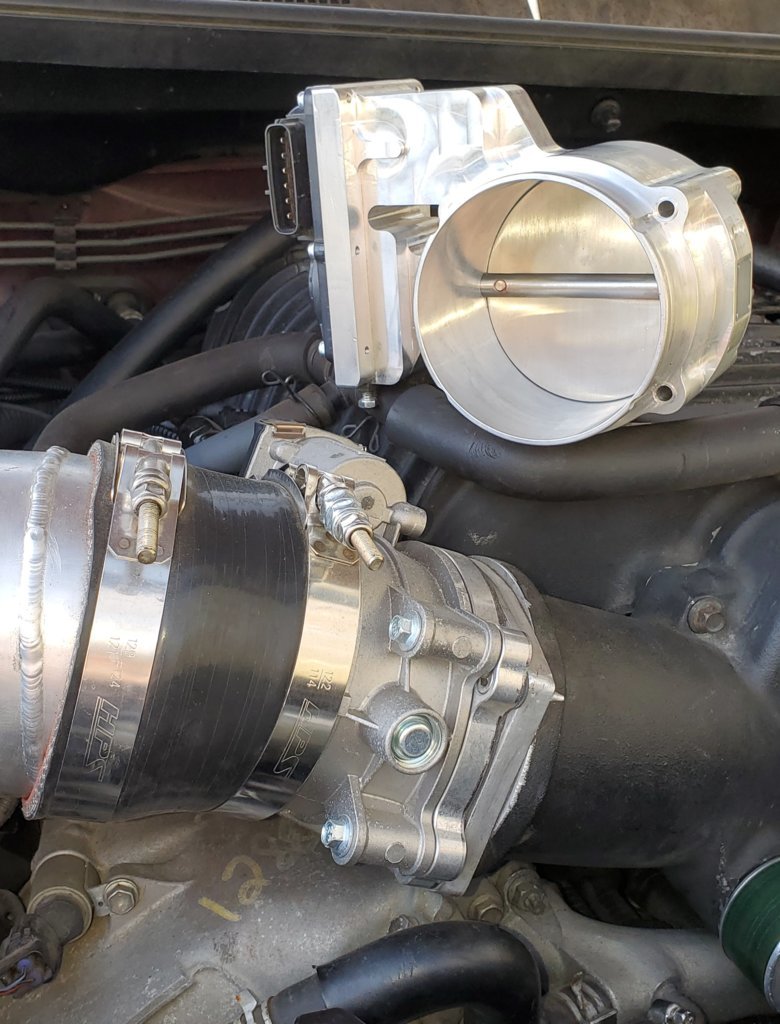

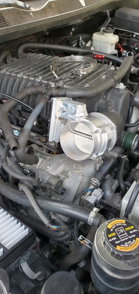

    Installed @snivilous 95mm TB and ran it around the airport a few times. Stock airload was decently responsive. Loaded my GM 95mm airload table and shifts were really good and TB worked as it should. Researching a few areas to resolve but pretty wild for the Sniv's Speed Shop 95mm throttle body with stock Toyota internals. Brought it up to 6450rpm and 13.3psi. Mostly did a few pulls up to 4800rpm, 11.9psi.

    Anybody done any dyno or 1/4 mile runs with the larger throttle body’s?

    As soon as I get some things squared away I'll be hopeful for a dyno run this summer. I did a 1/4 dragy run but freaked out when my front wheels were spinning and let off.
    @reywcms and @armyoffoo are running GM 103mm TB's and I'm on a GM 95mm.

    Boosted launch or just flat foot it from a stop? Once I get this last log with meth and an extra psi I want to really see what this thing can do from a dig.

    Curious to hear how yours reacts. I've had better times with brake boosted launches at ~2k RPM (1.0 1.5psi) but the G forces are higher without the brake boosting. Times are within 1/2 a second of each other.

    Flat foot from launch. 1/4 was 12.86 with 0-60 4.45 (4.25 corrected 1ft). I let off for a split second. Pre 5.29's! I'll get another as I gotta do some testing on the new SSS 95mm tb.
