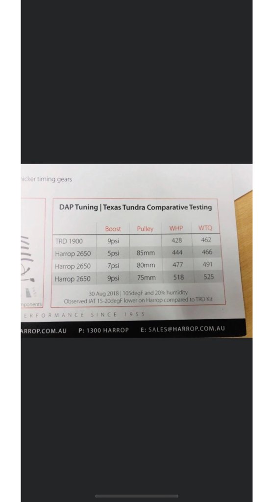

    Headers and exhaust will drop boost some but how much depends varies about ~1PSI. A larger blower also helps keep the boost down.

    Saw 2 psi drop in my setup recently. What would be typical next steps would be to double down on the pulley size to regain the boost loss but we’ll leave that to the built motor for moaarr powwwaa. Not that it really needs it

    With the 3 inch exhaust, headers, no cats keeps the psi down.
    With a 6.75 or .71 crank pulley and 2.0 SC pulley I'm trying to keep it low. But the little 1900 does sing. Just gotta keep it all together. :D

    Yes! Less boost more power super efficient is the key.

    Shame I didn't have my boost gauge before headers. Probably wouldn't have mattered since I still had the stock muffler on lol.

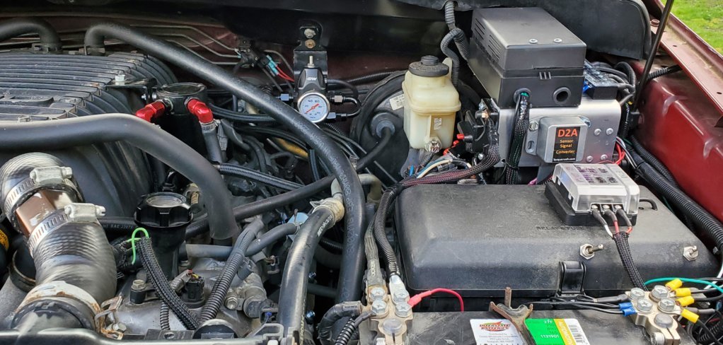

    Finally got my relay box installed. Tried to copy @armyoffoo original setup as best I could. It did clean up the rats nest of wires and relays stacked on the fender/firewall. I still have some more to do... Thanks for the info!
