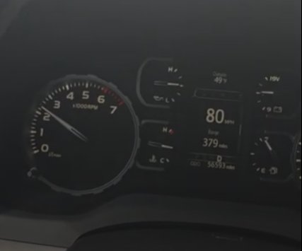

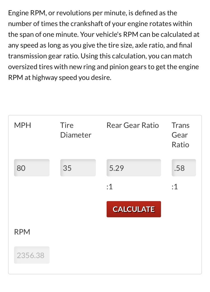

    I don’t have 5.29s yet but it looks close according to this calculator. I will say, 80 Indicated on 35s is probably more like 87 in reality by GPS isn’t it?

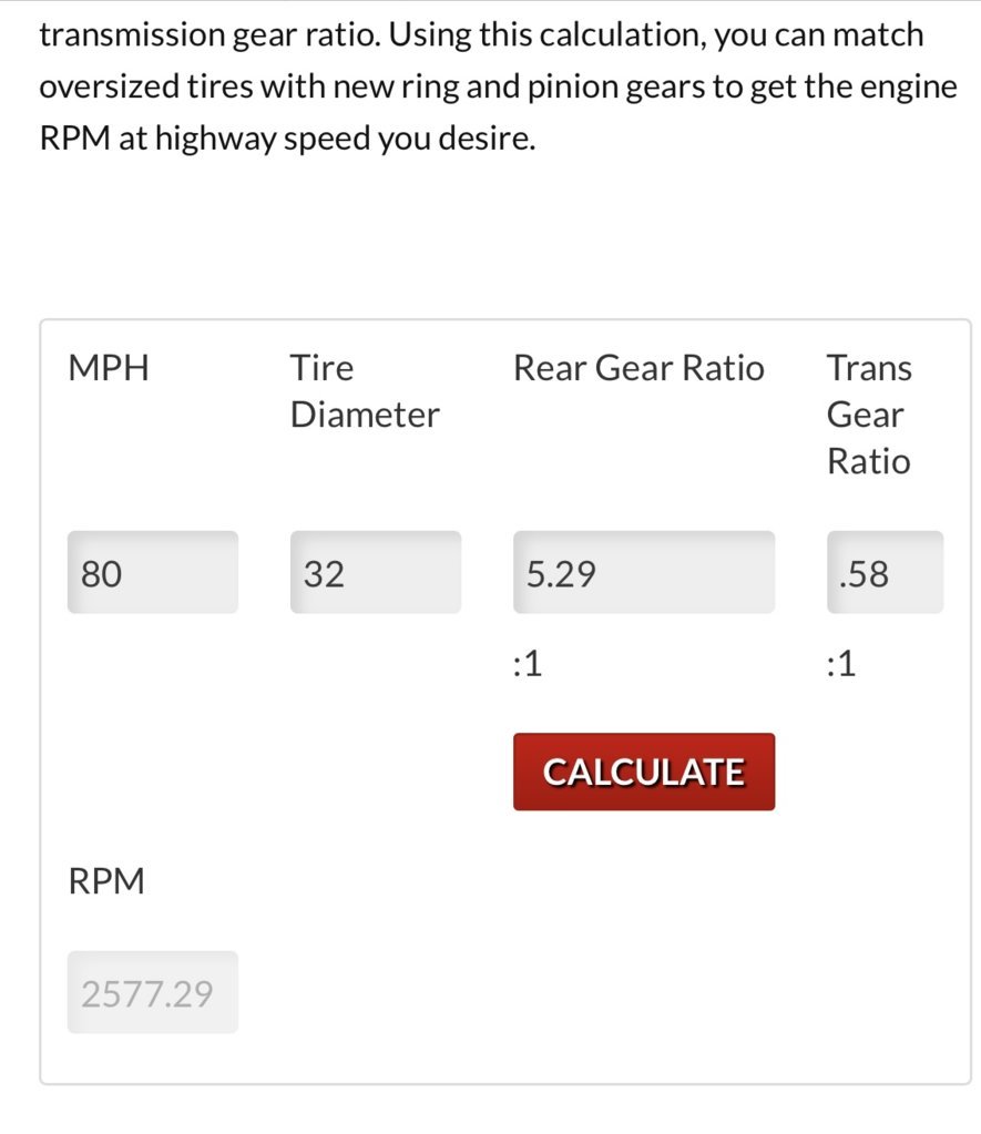

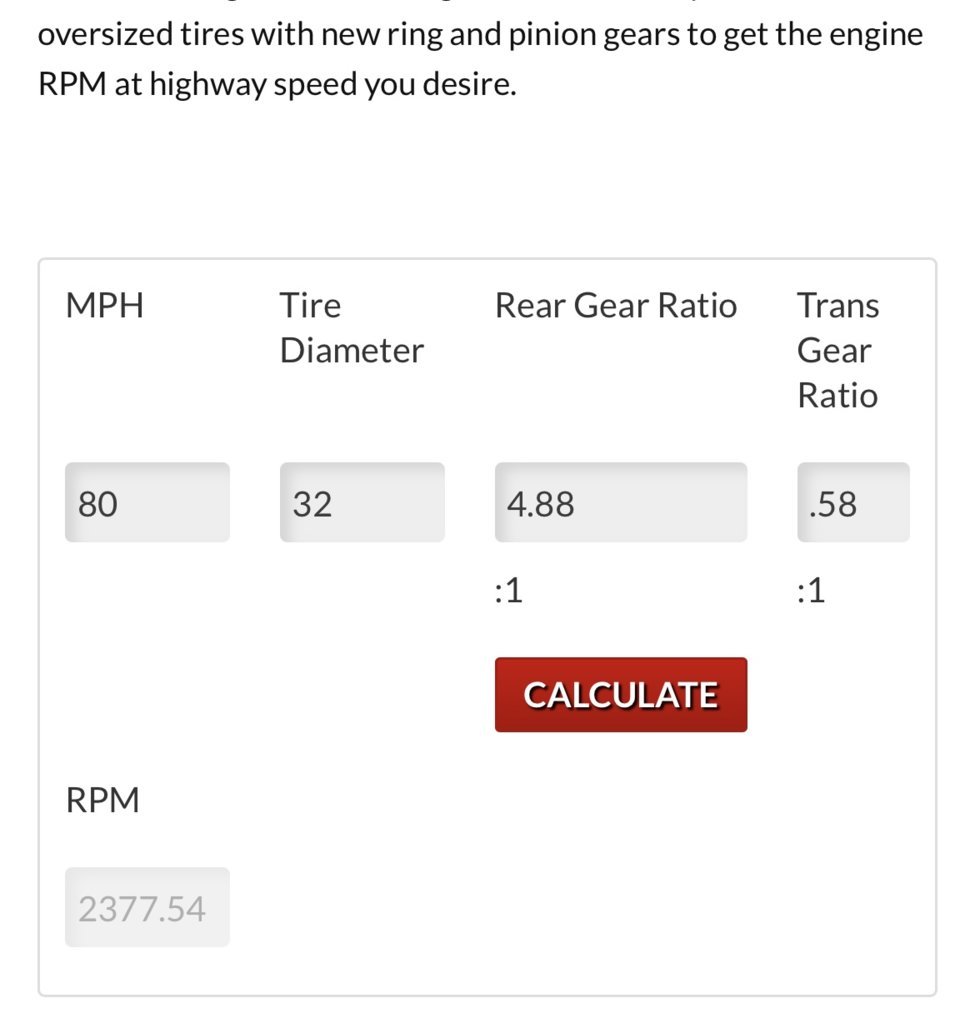

    Yea you have to put in stock tire size which is what the dash thinks. Actual tire size doesn't matter in this case since the speedo isn't referencing actual size.

    That's what I'm saying. Though maybe it's just tolerance stack up between the tach and speedo. I would expect every truck to read identical, but obviously not (my truck reads right around 2650 at 80mph indicated). But sub 2500rpm just seems exceptionally low.

    Maybe @NatesNightMare has a speedo correction device and doesn’t know it if he is not the original owner?

    Nope my speedo is on

    Ive checked my speedo and it reads correct
