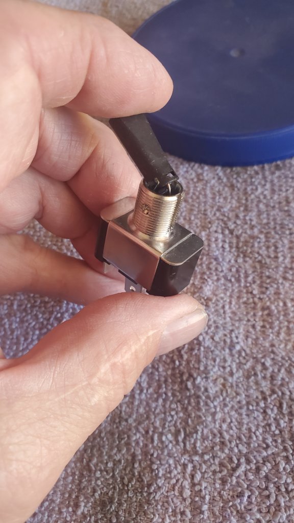

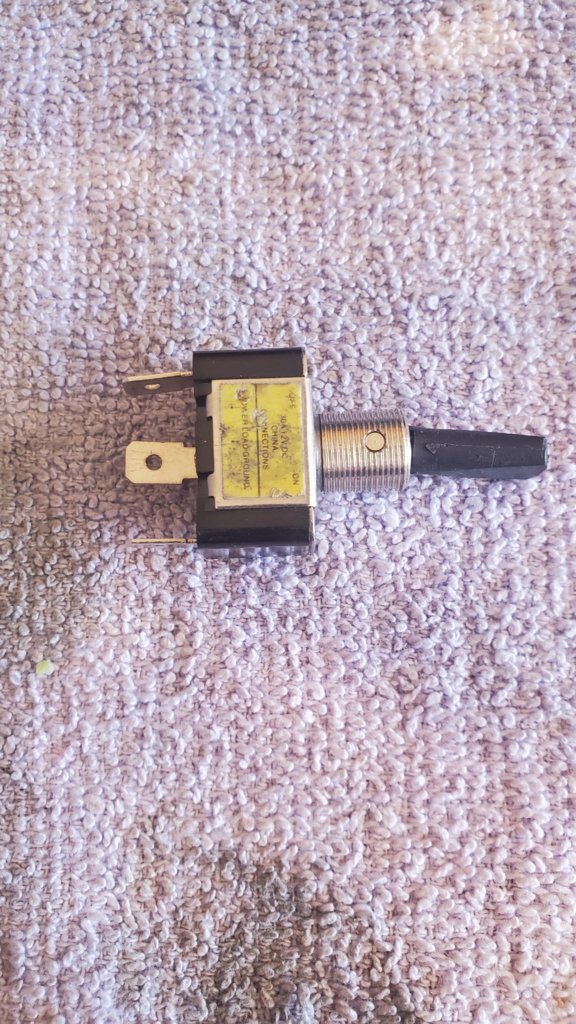

    Current : Magnuson S/C 5.7 FFV, Tundra CM, SNIV tuned w/HP Tuner, SG-1 Wide band AF w/gauge, TRD cat back, slotted and drilled rotors, stainless brake lines, TRD pads front and rear, front OEM Sport sway bar, rear TRD sway bar, 38 gallon OEM fuel tank, Tesla screen, ham radio, 2.5 Icons w/ res front and rear. X2 battery w/Voltage Booster Pro 2014 OEM wheels. https://drive.proton.me/urls/Y8739Z14BG#HCVT8AowG9fl ---------------------------------------------------- Previous: 2002 Tundra AC 2wd... Converted to OEM 4wd , S/C 4.7, TRD exhaust. 35's w/4:88's, too many other mods to list. https://drive.proton.me/urls/SWEWY4AFMC#eC7zX57Ex6pI ---------------------------------------------------- Other: 1967 mustang , Blown 408, 671Mike Kuhl 12.5% overdriven, 300shot NOs 5 speed TKO600, 4:11's Ford 9", Detroit Locker (real) Evans Coolant, Twin 12" Spahl fans https://drive.proton.me/urls/ABBVY3TQ3M#OT9LceyNwbTy ---------------------------------------------------- 2015 4runner TRD drop in filter Prinsu 1/2 roof rack, Nfab side steps, TRD FJ lift kit. ---------------------------------------------------- 2007 Prius 45mpg+ ... It's the only way to afford fuel for these Beasts!
    I've been lurking for some time, finally all caught up on this thread. been about 6 weeks
    Lots of great information, THANK YOU ALL - to many to list
    please add another Magnuson to the list.
    Got it free and sent it out to SOL for a complete overhaul and new everything along with the green injectors.
    Thru a very close friend I was able to get ahold of @snivilous to tune the truck for me. I bought my own HP tuner. He turned me on to this website.
    This truck has never thrown a code and runs really well for "STOCK SC". I can't say enough good about @snivilous . I had a small issue with the truck when I first installed the SC. He met me on his way back thru town to help, taking time out of his own personal life.
    I Finally figured out the issue and it had nothing to do with the SC or the tune.. It was all on me and something I did to the truck years ago.... I must say he went above and beyond and just wanted to say THANK YOU!!! @snivilous for being very dedicated and just a good person overall.
    I look forward to participating here and one day will install his party pulley. I have a spare engine and am saving for all the go-fast bottom end parts. Also saved the AWD- might do that too...pipe dream for now.
    If I want to go real fast right now - I just open the other garage door. I think I'm in the 2 SC club as well..
    Best forum Ive been in in quite a while..
    Thanks to you all

    I installed a kill switch in the injector power feed line, so even if you had the key, the truck would not start. Turns out the switch would intermittently go open, but only at WOT in 4th gear...every time. No codes or check engine light...
    I finally figured it out at work one day when the truck died just by touching the switch...replaced the switch with a 40amp steel waterproof one I had left over from the buggy days and VOIALA! no more dying..
    I should have known better but never had an issue when the truck was stock.
