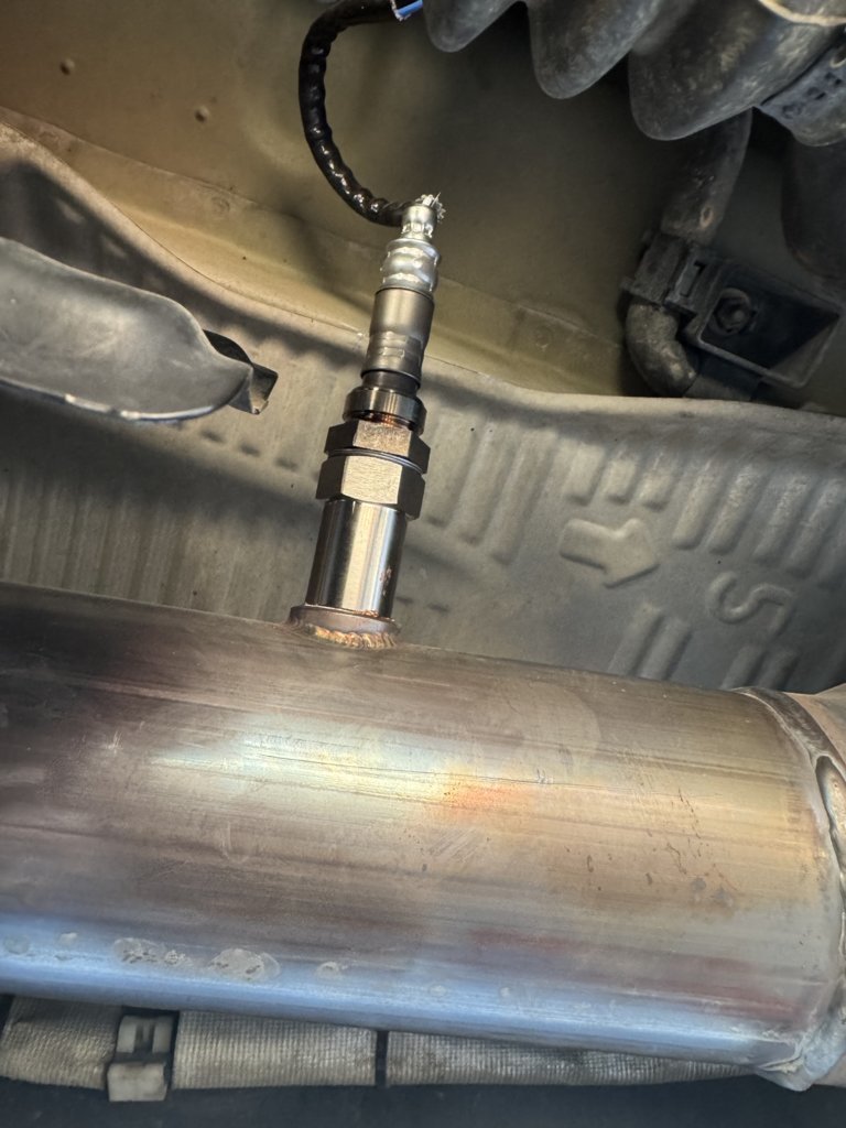

    The 8AR mod to my tune has solved all my issues! It's like magic!
    I tried to install the upstream O2 and it is in there so tightly with an O2 socket I semi rounded the sensor.

    That's great! My extended starts are gone and starts within 4 seconds, seems stronger too. I still haven't gapped out to .034 but am at .028 right now.
    Those primary O2's can be a bitch!

    Had to use vice grips and a hammer to get mine loose.

    Powersteering fluid and acetone in a 1:1 ratio will loosen those 8itches up nicely!!

    I’ve always done transmission fluid and acetone. Nothing that stuff can’t loosen up.

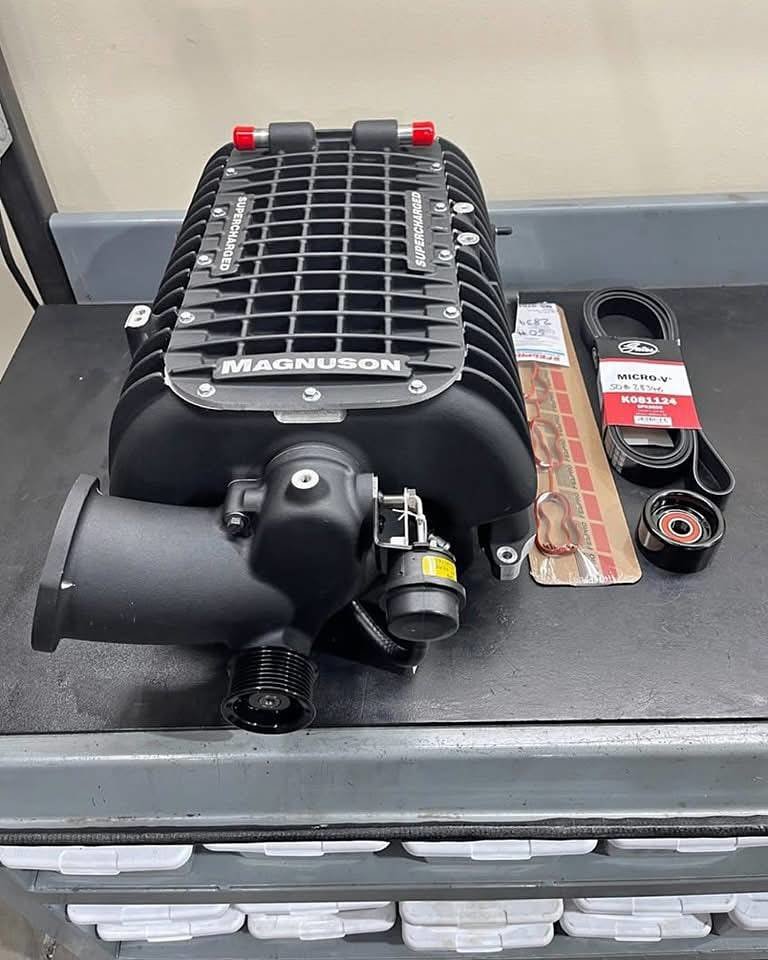

    Hey supercharger gods. Looking at getting this kit but am a noob to this topic. All that comes with this is the following:
    MAGNUSON SUPERCHARGER TVS1900Head unit with intake gaskets, belt and idler pulley only.
    Just want to know what else I need to install. I know it will require a tune as well. And do I need to be concerned if its for flex/non flex fuel? Thank you.

    Assuming that’s Nergal’s ad from superchargers online. You’ll need the fit kit to install it. And they can source that for you.

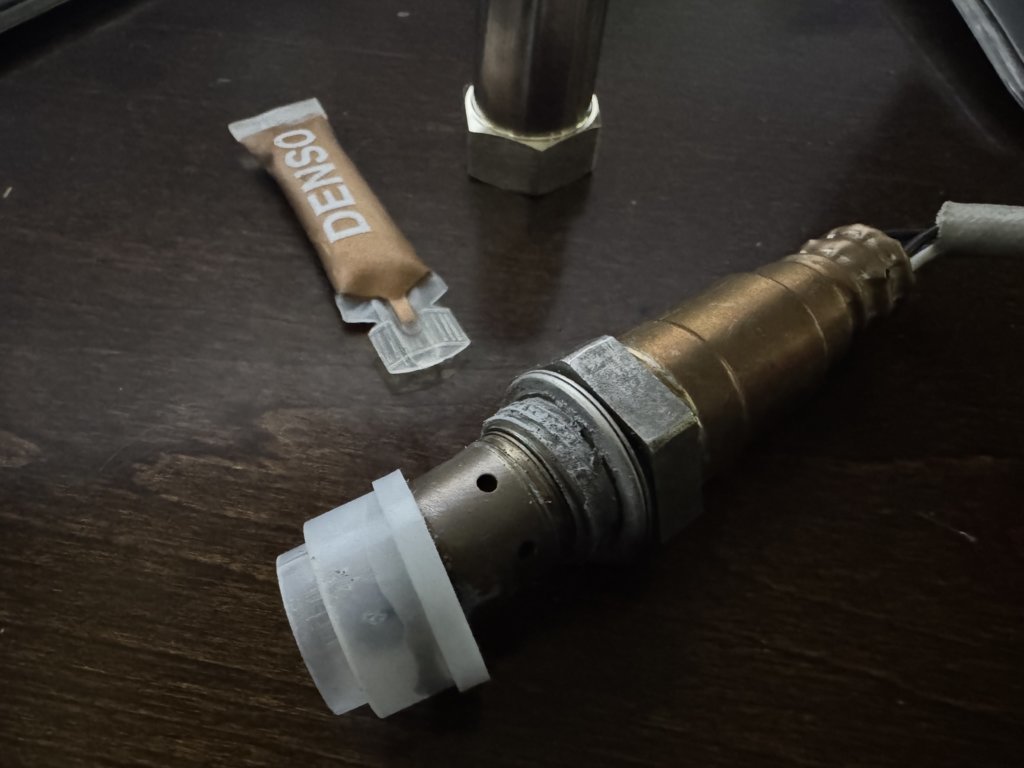

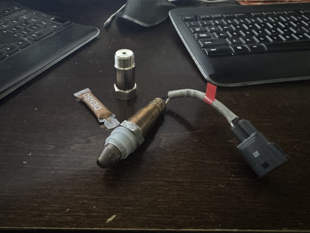

    Welcome to the insane asylum, warning: Through this path madness lies.....
    2 questions, I want the defouler on the upstream & although there is antiseize on the O2 do I also need whatever is in the packet?

    Your primary needs to read for closed loop it won't be accurate.

    So the defouler goes on the secondary.

    Yes the secondary. It helps with the p0420 related codes. If in the primary it won't properly read and could be way off for the ecu, inject less/more fuel than needed.

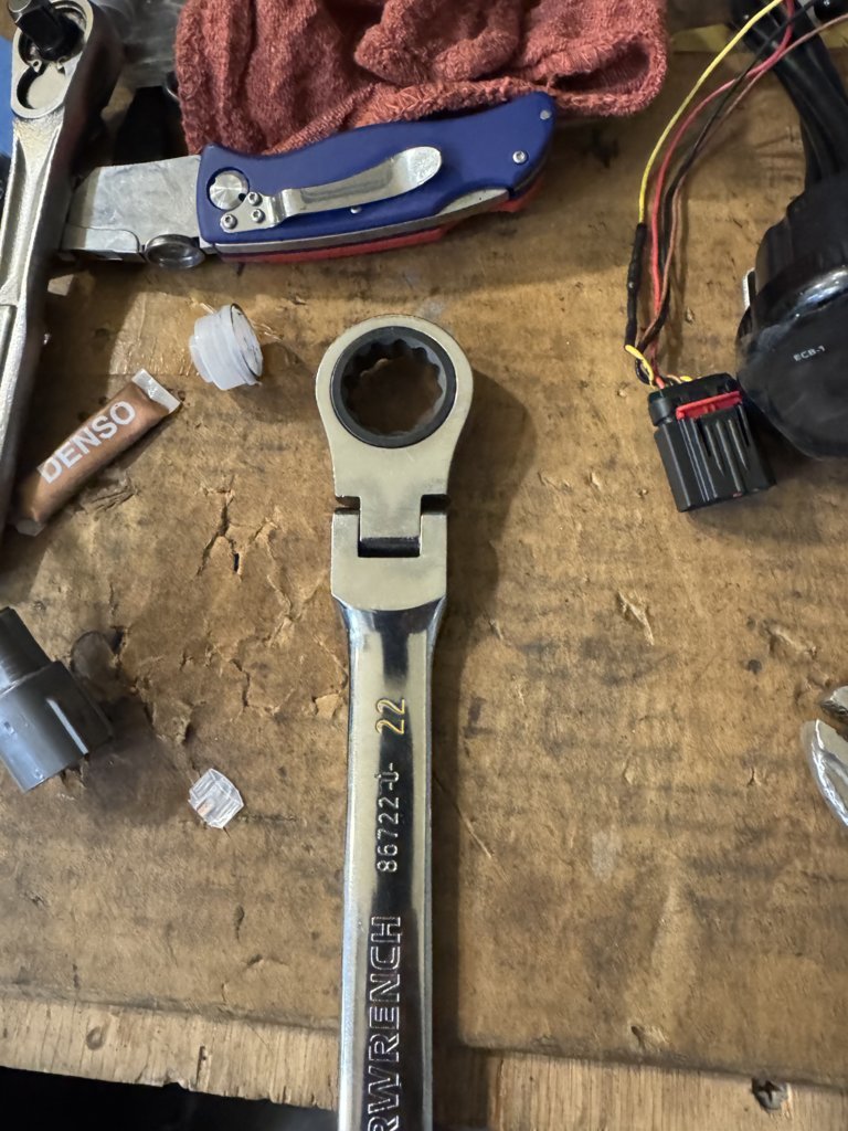

    Was that on the driver side? My main issue is the front driveshaft, that fucker is seriously in the way.
    lol
  27. Mar 20, 2025 at 8:43 AM
    e30cabrio
    Oct 20, 2017
    #10410
    6,296
    West Valley, Phoenix, Az.
    Boosted 2013 Sequoia TRD FAUX
    Didn't occur to me the connector will fit through a 22.
    Trying this.

    Whelp, it's rounder nau.
    lol

    That packet is anti seize and yes, I’d use it to avoid rounding it out next time you need to change it.

    That's why you need the 6 point open end o_O
    12 points only exist for tight spaces or stupid fasteners
