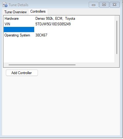

  25. Mar 17, 2025 at 6:44 AM
    e30cabrio
    Oct 20, 2017
    #10410
    6,674
    West Valley, Phoenix, Az.
    Boosted 2013 Sequoia TRD FAUX
    Is this what I need? I got it from what I think is the right read.

  27. Mar 17, 2025 at 8:26 AM

  30. Mar 17, 2025 at 11:17 AM
    e30cabrio
    Oct 20, 2017
    #10410
    6,674
    Thank you so much for the file!!!!
    Read is greyed out :( I got the ID from step one on write
