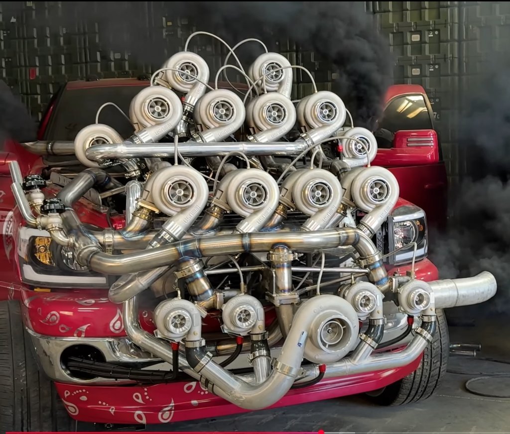

    You better watch out @TurboKits looks like you have competition nipping at your heels....
    and it already comes with Meth just not water/methanol ;)

    Only has like 46,000 horsepower, though...:rofl:

    But is there lag? :)

    It's decorative.
