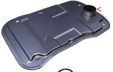

    The one I attached is a stock photo, of a oem/replacement filter. Trying to show where it was trimmed with the red arrow and used in my case without a aftermarket pan.
    Unfortunately, pictures were not taken of the WTA filter that was provided and I'm only guessing it's for the deeper pans as I don't see anyother reason for it being extended in length, not much was trimmed, but needed to happen as the pan will not seat.

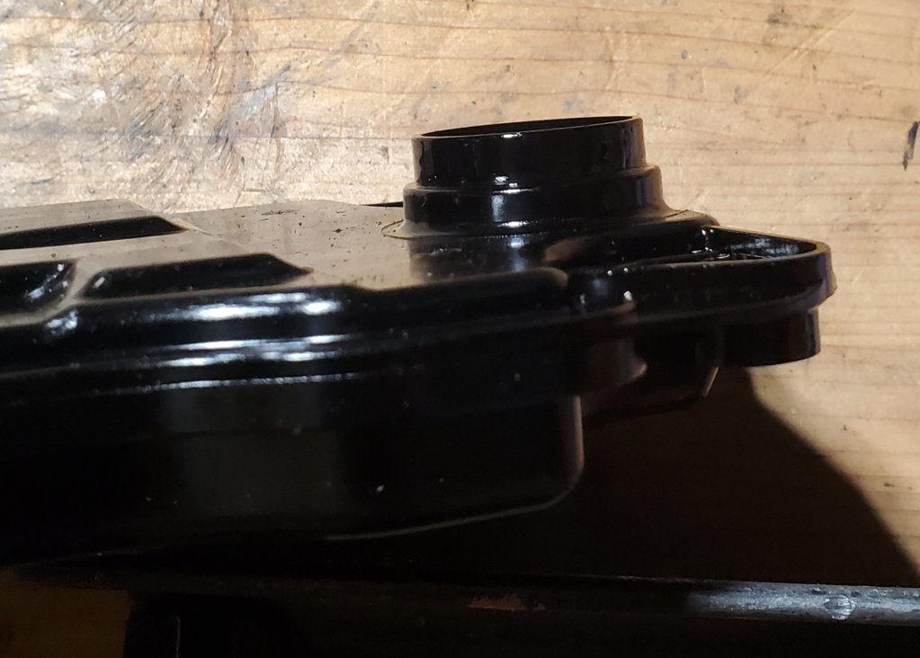

    That would be a good question as most will get the VB without the deeper pan.
    Was it just the top inner seat portion where the o-ring goes as in the pic? The valve body depth is only .25 inches.
    The filter sits about .5 inche above the rear baffle on the pml pan. Didn't think it was worth the effort as I always add extra fluid when filling.

    Correct it was cut where the inner seat portion is with the o-ring, tight fit. I believe only about a 1/4" in total was removed from that section.
