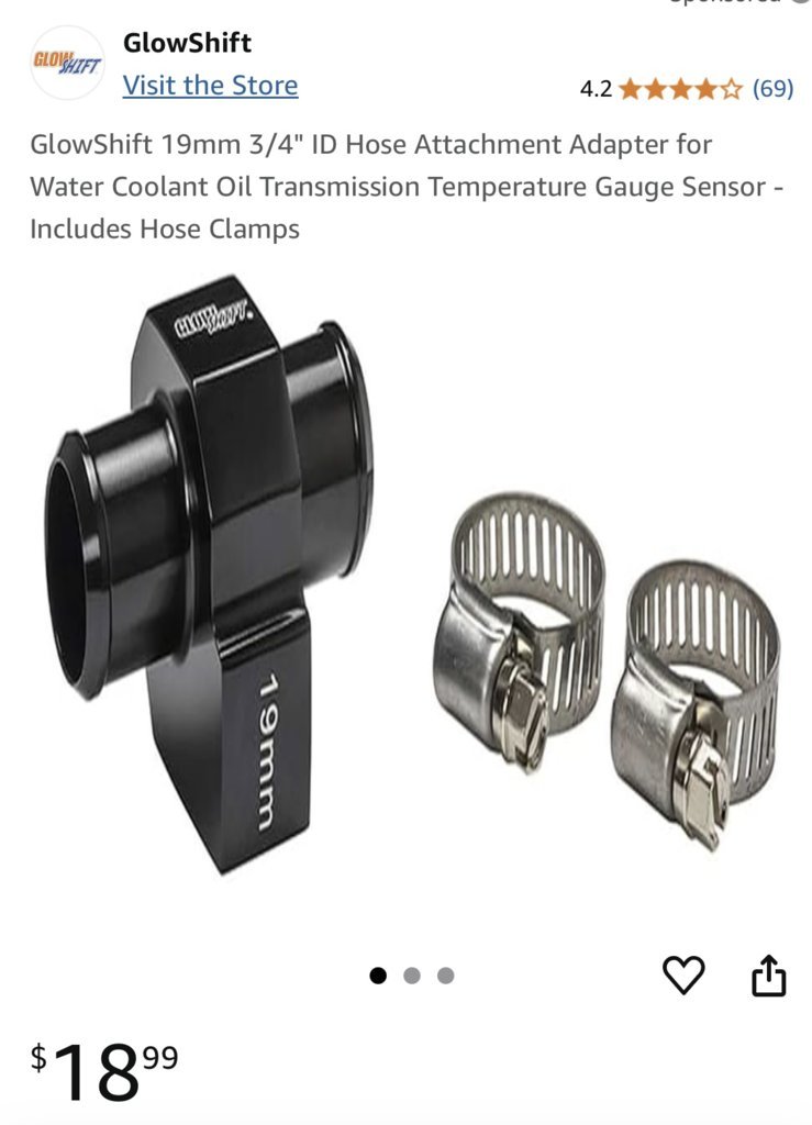

    Is anyone here monitoring their intercooler fluid temperature? I was thinking of installing one of these inline adapters with a threaded port to screw a sensor into for a coolant temperature gauge.

    I wish I knew about that before fabricating my own on my LS :rofl:

    My thought was if you wish something existed for a particular function, it probably already does. It’s just a matter of googling the right terms to find it lol. That’s what happened here.

    Well I have another temp sensor I need to hook up so I now I know! Get pre and post intercooler temps was my goal.
    But from my fairly limited experience so far with the intercooler temp gauge it doesn't change much. My main concern was my power steering is cooled by the intercooler cooling loop so I have two heat sources dumping in. I had always assumed the IAT matched the intercooler temp pretty close, and they do seem to match extremely close now that I can monitor both. I'd imagine with just the blower that the intercooler temps will hardly move and just mimic the IATs you're already seeing. On my buggy that's like 100-110F usually, but obviously the ONLY similarity is both engines are supercharged :rofl:

    Im able to monitor the true IATs since the Harrop uses an actual sensor measuring intake temperature after the intercooler entering the cylinders. It’s consistently 30-35 degrees over the ambient air temperature as the hot HX coolant circulating the engine bay gives up some heat to the intake air, but getting into boost it doesn’t move at all and stays stable (pretty awesome considering each PSI increases the leaving temp by 15 degrees theoretically.) I want to measure the HX fluid temperature to know what it really is, but seeing as the IAT is always 30 degrees over ambient, the HX coolant is probably 40-50 degrees over ambient at any given time I’d guess. I want to see what happens to the temps if I incorporate a front intercooler sprayer down the road.

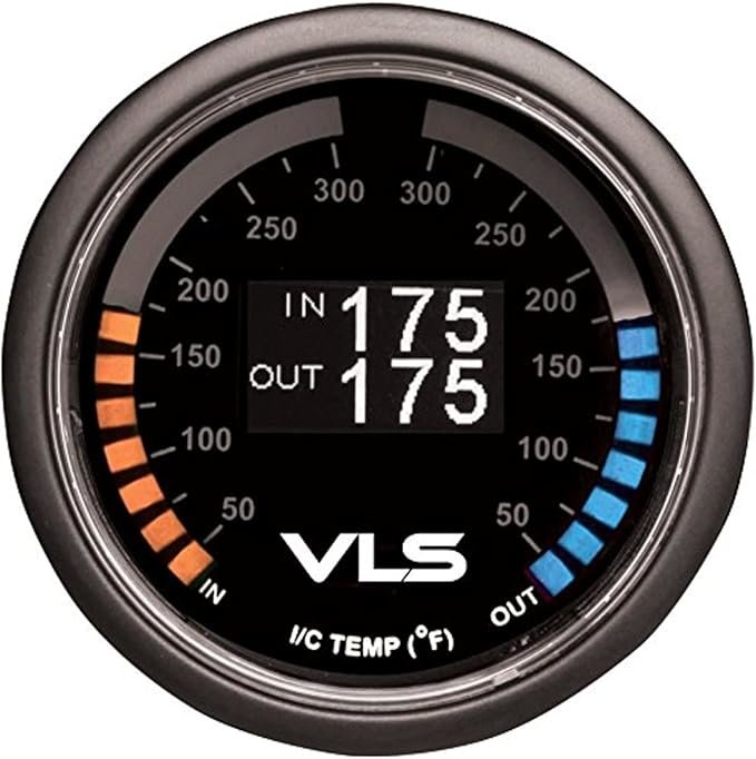

    I was and was looking to do inlet and outlet temps with this gauge.
    Amazon.com: Revel 1TR1AA006R Gauge (VLS 52mm 50-300 Deg F Dual Intercooler Temperature), 1 Pack : Automotive
