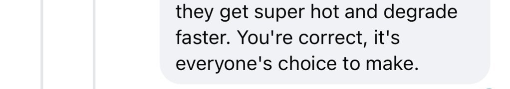

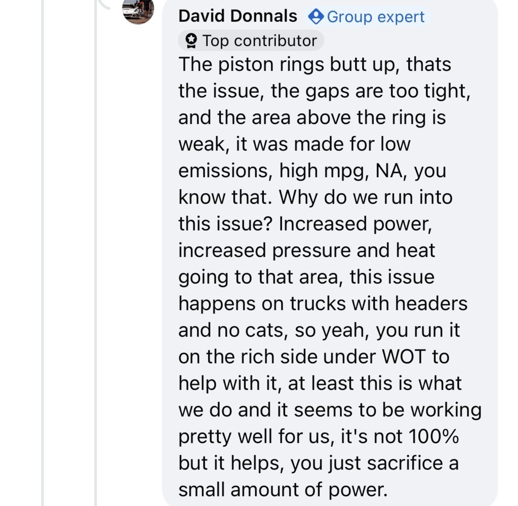

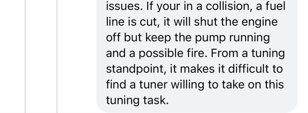

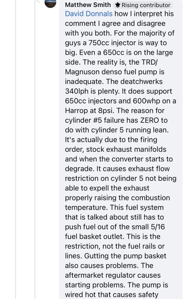

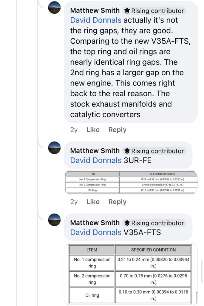

    I was reading some slightly older comments/discussion on the boosted page. I thought this was an interesting different opinion on what causes a boosted 3UR to have busted ring issues. Just thought it was relevant to the recent cat converter and AFR discussions so figured I’d share. Maybe the real boosted longevity issue for the 3UR is exhaust manifold/cat restriction causing high cylinder temps, and not the ring gaps themselves? Gotta say, the ring gaps being similar to the new V35a-fts is interesting despite being NA vs built for boost.

    I was running JBA LT's, 200 cell high flow cats, dual 3 inch exhaust( not stock). Aeromotive 340lph pump when mine went. AFR's were usually 10.8-11.4 at wot. So most likely leaned out because of supply line size and BD tune?
    I've always geared towards the 10.5 from Matt's post that I saw in the past.
    It is interesting and some food for thought.

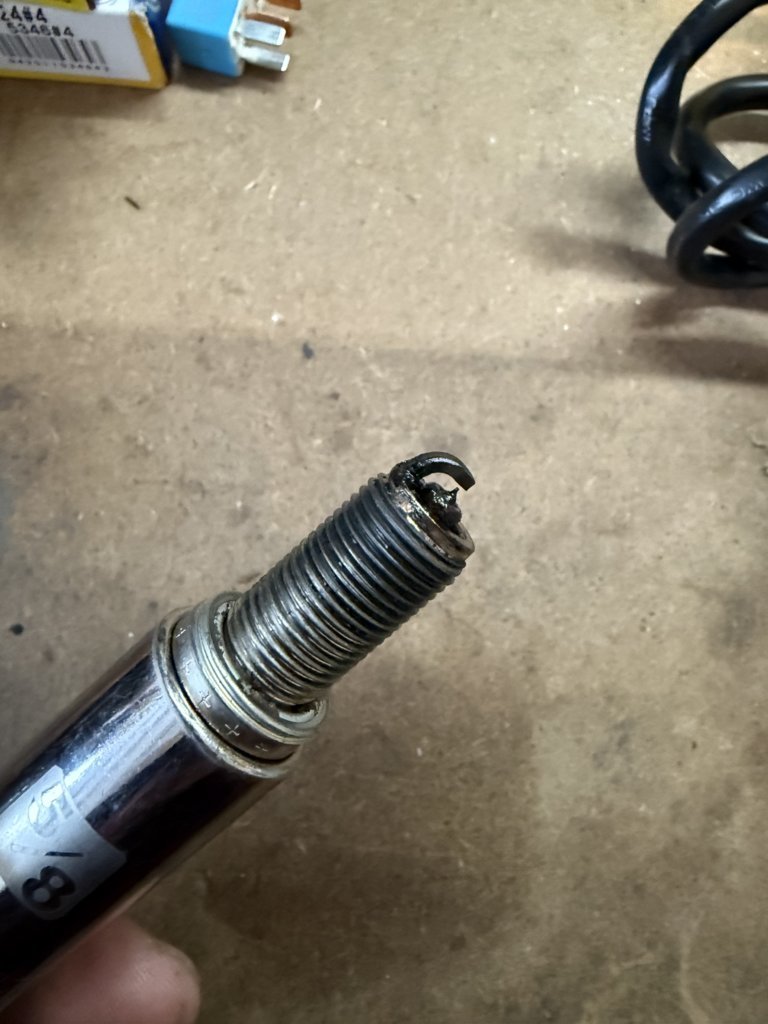

    Continuing the crank no start. Tossed in a new Odyssey just to cover any random voltage issues. Pulled 2 plugs this morning and they’re soaked in fuel and gunk so this could definitely be a contributing factor. More to come.

    With the 8arfts coils have you thought of opening the gap. Even just going back to .028 to .032? When I get the new injectors I'll be opening them up @Jowett asked if we tried opening for the stronger spark.
    I saw my five-o's were pretty rich on start up @Wynnded had same issue but from extended starts.
    Good luck trouble shooting I'm sure your covering all the bases.

    I had to go to 32 or so to get rid of my misfire with the 8ARFTS.
