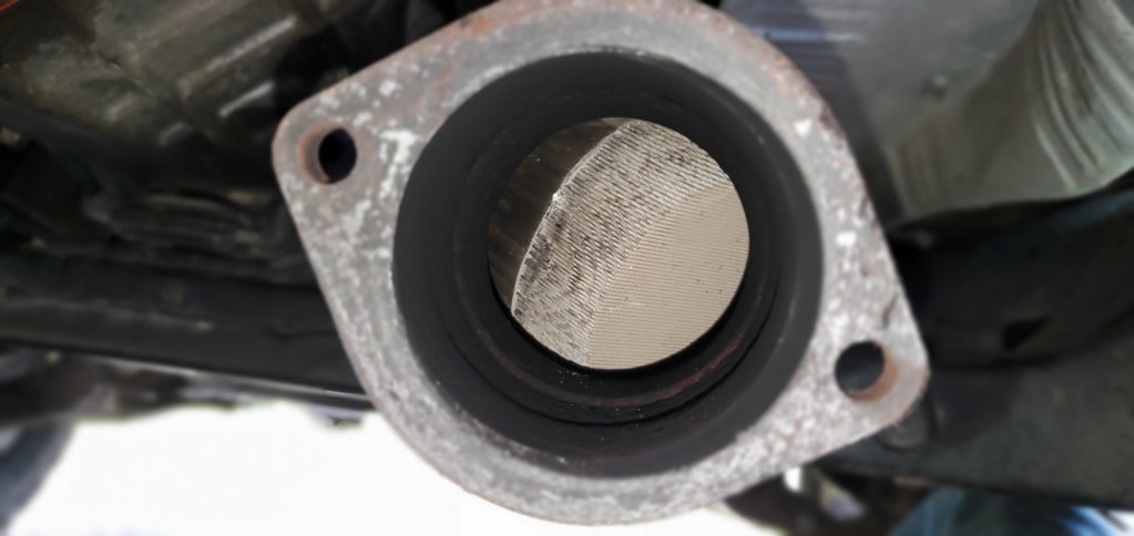

    Well the cats I bought are not able to withstand the heat and pressure. At least they said send em back and refund me. Looks to be only press fit, oh well. Straight piping it for now.
    Will have Keith make up some mids with mufflers later on. Guess he's working on some JBA style headers and I mentioned about the single AIP pipe (like arh) off the 7 and 8 primary.

    Why do you want cats anyway?

    Well its straight piped now. I think it'll lower the psi a little which is probably safer...when is the 1.9 coming in. :D:thumbsup:

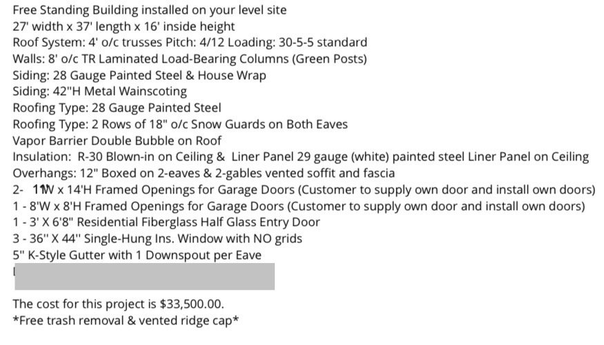

    No worries, no different than talking about what we pay for trucks and mods IMO. I’ll say it can vary a lot totally based off of options you choose. Definitely get at least a few prices.
    For the base building and these options I’m looking at 33.5k for just the building not counting garage doors, concrete, electrical work, lighting etc. I’ll do the electric, door openers, and lights on my own most likely.
    Other add ons:
    11x14 doors are 3500/door
    8x8 door is 2k a door
    Basically looking at 10k for doors. This is with no openers and these are higher quality insulated doors than your standard foam door so they cost a lot more.
    6” concrete will be about 9k.
    Site prep I’m expecting 2.5-4k.
    Basically, do the math for a rough idea of what your project may cost.

    Thank you brotha! That is actually a bit of a relief to me. I had budgeted quite a bit more because I always like to overshoot what I think I will be spending. Thanks for the break down. And good luck and show us progress when it's being built!

    No problem! Also realize this a pole building which is more affordable to build. Not sure if that was what you had in mind or not. Always better to budget high!
