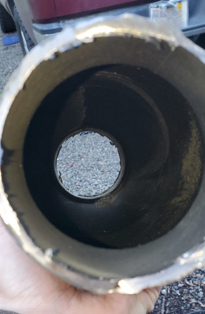

    Is there supposed to be something in my cat? I noticed a rattle. Ordered a new cat under warranty and went to replace. Huh?
    I'll have to look at the other side too.

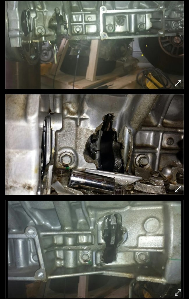

    That looks like my stocker when I blew it to chunks!

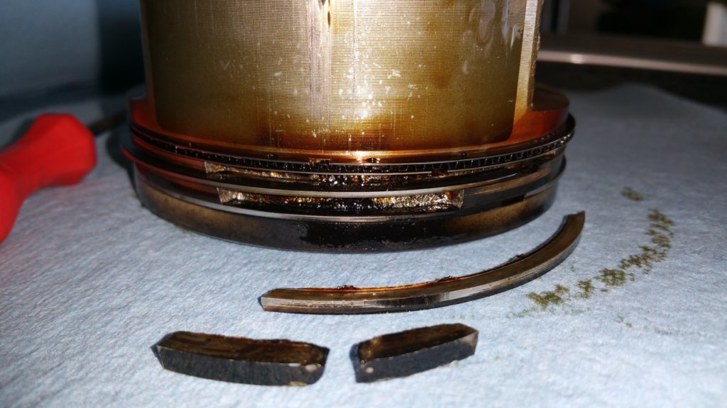

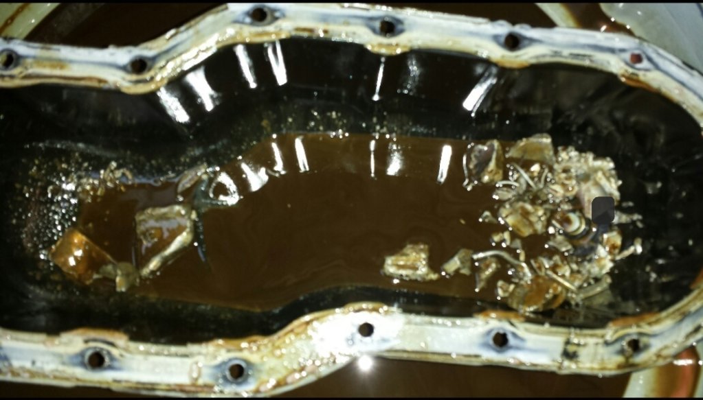

    Well...it stems from engine failures due to ring failure. Myself, ViktorG and a few others back in 2012-2014 had engine failures. The piston rings are pretty tight combined with thin lands led to failure. It is believed they overheat and bind seizing in the cylinder. Connecting rod failure was another issue. It was thought to run them pig rich to keep the cylinder cool under high boosted loads. We had crap tuni g too.
    With better fueling and tuning we could most likely go leaner. It happened to a few N/A engines but mostly forced induction. A few on tundra talk and solutions. A few that kept quiet out of embarrassment...
    I have started to ease up a little but I'm still cautious over 10psi.
    From 10-13.7 psi it sits at 10.5 afr but the W/M sometimes makes it dip more. I stopped trying to mess with it.

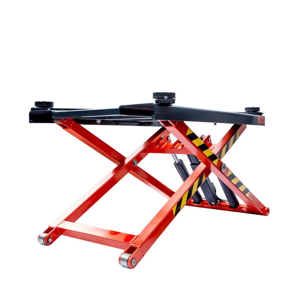

    As a person who owns 2 types of lifts, do you want you want to hear some real life thoughts?
  11. Mar 7, 2025 at 4:08 AM
    Silver17
    Oct 3, 2021
    #68847
    3,737
    Eastern PA
    2017 TRD 4x4 Harrop SC
    TBD! I have to see what @koditten has for opinions before I could possibly make a decision. Honestly though, I haven’t spent much time looking into the lift possibilities just yet. I initially like the idea of a lift like this atlas lift @ViktorG showed a picture of once. upload_2025-3-7_7-8-41.png
    Well surely I do! Nothing better than real world feedback.

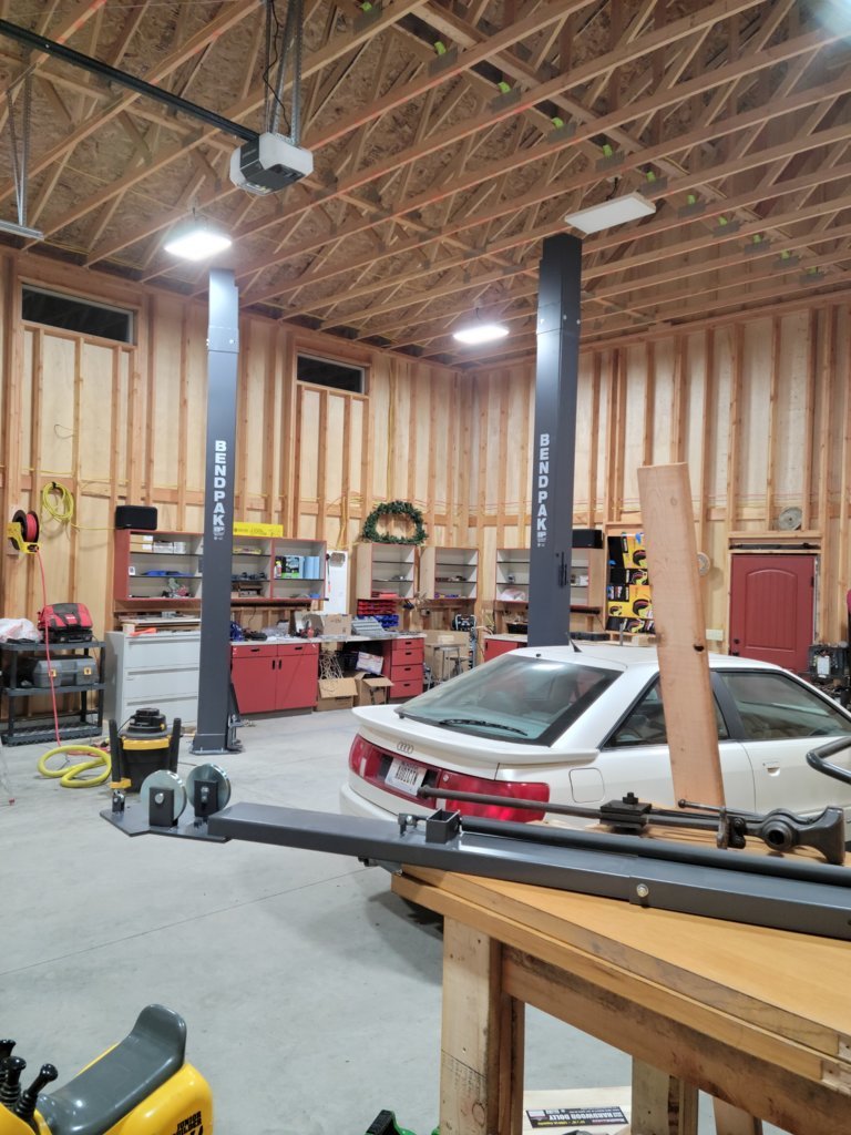

    Those are great lifts. I just had a Triumph C-7000 "portable" 2 post lift delivered, now I just need time to install it.
    Mdl and Silver17[QUOTED] like this.

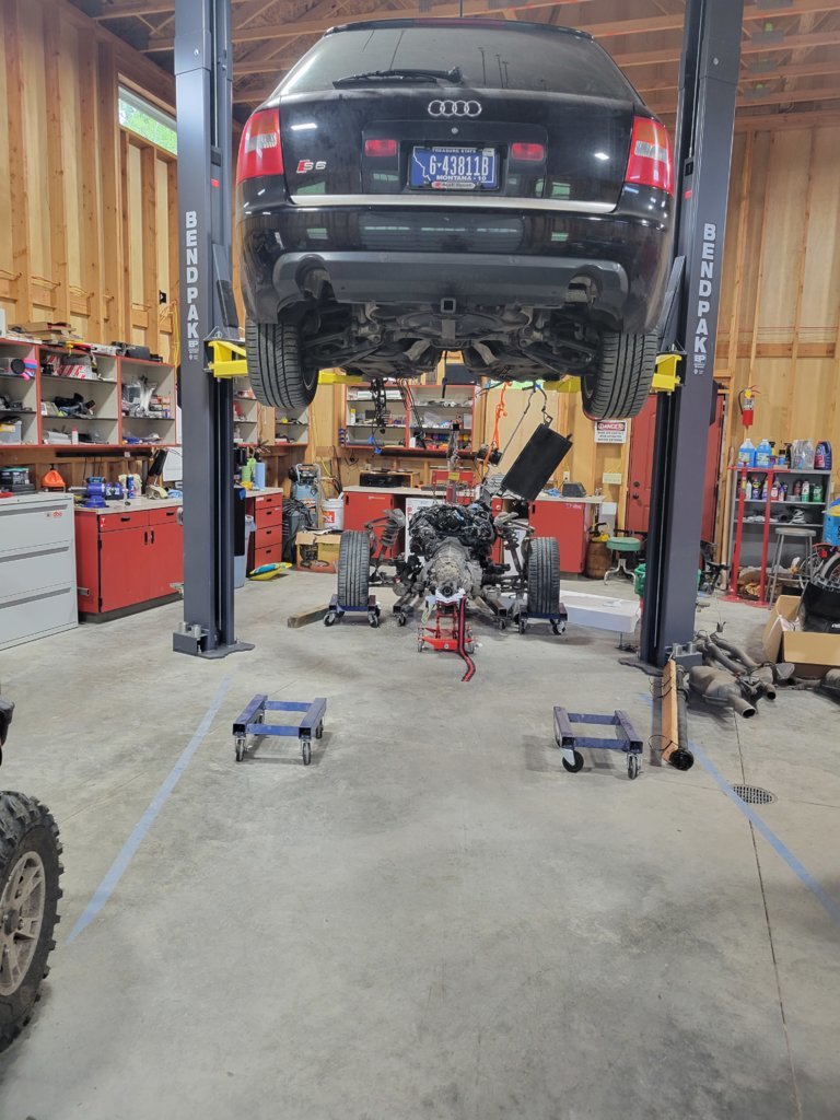

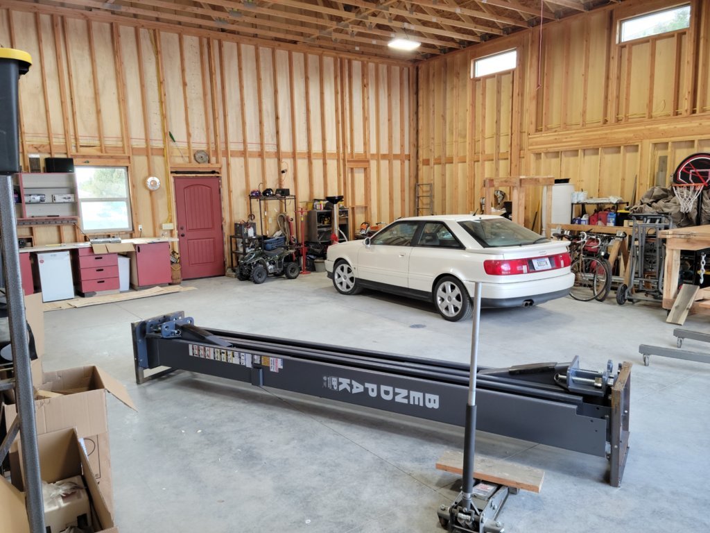

    My asymmetrical Bendpack 10k 2 post is rocking for me...if you can install it diagonally in a space, it's much easy getting ALL your crap into a shop..."less" in the way. Portable ones, either 2post or 4, are super great too...it is more annoying than hard to move them but how often does one move them around? The casters are expensive but like you all know, having the right tool for the job, even if it's once, makes it worth owning 90% of the time!

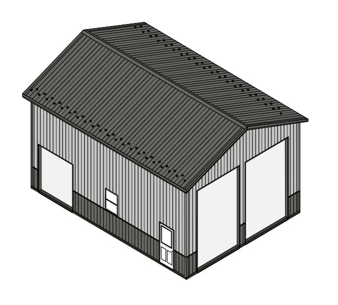

    That Bendpack & a smaller version of that shop are what I am shooting for when we build our new house.

    My 1st love is my mid height lift. I added a piece of plate steel so I could use the lift as a work bench.
    I love the fact that I can move it outside when the weather is nice. These lift don't require 12' ceilings. This is the deatailers choice for doing waxes. No post that have to be worked around, either. 90% of car work, the vehicle does not need lifted to head height. A roll around stool let's you do oil changes with ease.
    This hoist never needs adjusted. All 2 post lifts build up air in the hydraulics, thus requiring the arms to be adjusted on a regular basis.
    I like my 2 post unit, but it does have its disadvantages.
    Our Tundras are too wide. The balance point is near the center of the front doors. To get out, you have to squeeze thru a tight gap between the door and the post. I cheat and just exit the back seat.
    The 2 post can't be moved. I'm constantly tripping over the arms or I just lift the empty hoist as high as it will go. I'm 5'10" so I can walk under the arms. My six foot friends hit their head.
    For safety, I put 6' jack stands under the truck when doing tire rotations, the center of gravity can really change when you remove 2 tires from one end of the vehicle. This is for safety, but those jack stands really take up a lot of space.

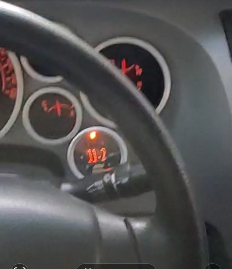

    I've been trying to keep eyes on WB gauge during pulls but it's hard, how are you guys doing it? by filming?
    HulkSmurf14 and Mdl like this.
  22. Mar 7, 2025 at 8:39 AM
    helidave
    helidave Hellacopter
    Oct 3, 2018
    #20151
    1,427
    flagstaff
    2015 DC 4x4
    Magnuson 2650 w/76mm pulley, ADS suspension, 35's, misc overlanding bro-trophies
    It takes practice

    My older AEM flashes red when I hit pre marked areas of the afr.
