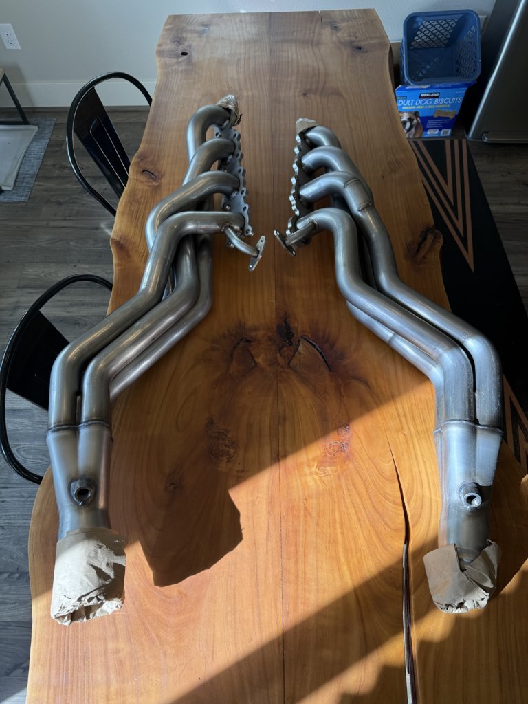

    I really like the one aip tube! Easier install than my JBA's...

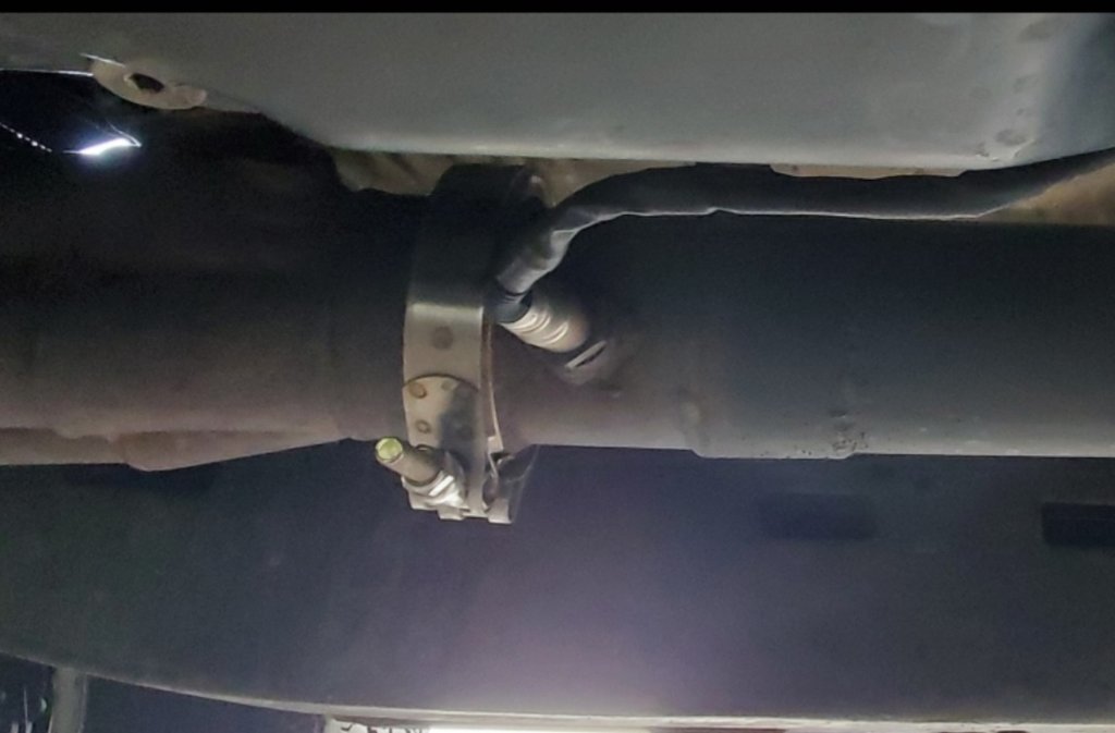

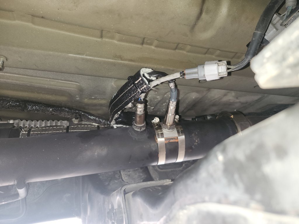

    Anyone with long tubes have a pic of their wideband sensor location I want to be sure I have clearance of where I want to weld it at

    I put mine a couple inches in front of the O2 sensors in my mid-pipes

    I see the clearance is pretty good. I’ll be adding mine closer to the merge collector before the cats.

    I have mine pretty close to the vband/collector. I kept it within the 18-23 inches from manifold. My cats are actually after the secondary O2's...
