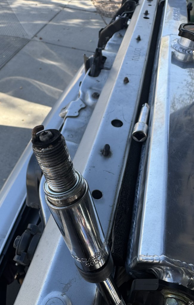

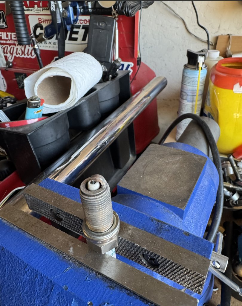

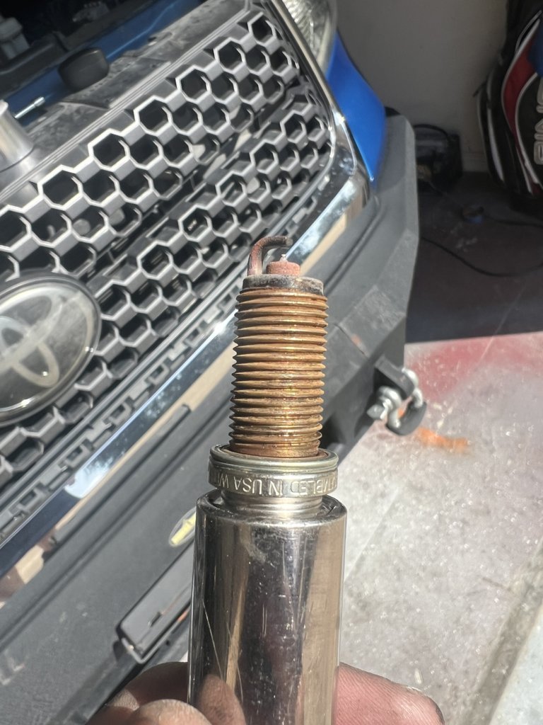

    Had a sporadic miss in #7 so swapped the new plug & Denso coil to 1.
    The orange tinge is from octane boost I used on CA. gas

  15. Mar 1, 2025 at 10:26 AM
    centex
    centex New Member
    Nov 27, 2022
    #87464
    2,191
    Electrodes look a little worn.
    HulkSmurf14 likes this.
  16. Mar 1, 2025 at 10:58 AM
    e30cabrio
    Oct 20, 2017
    #10410
    6,531
    West Valley, Phoenix, Az.
    Boosted 2013 Sequoia TRD FAUX
    That's the way they came, they have under 100 miles. I put them in after the L.A. Drive. There was still CA gas in the tank.

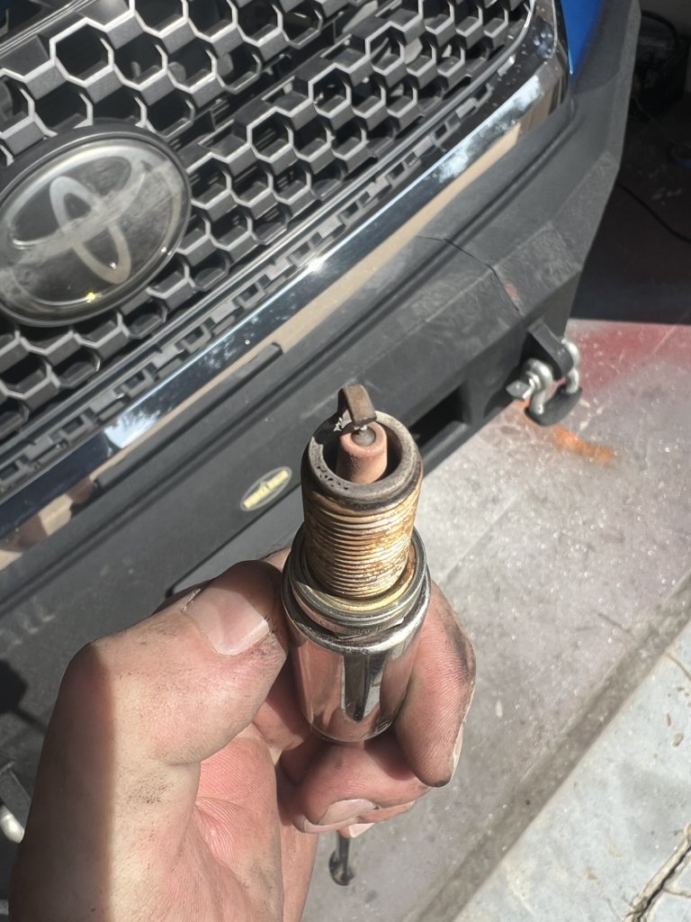

  17. Mar 1, 2025 at 11:00 AM
    e30cabrio
    Oct 20, 2017
    #10410
    6,531
    Here is one where you can see it better.

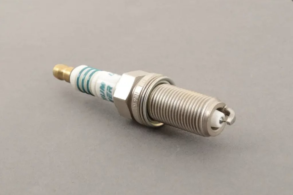

    Here is how they are new.

  18. Mar 1, 2025 at 11:13 AM
    snivilous
    snivilous [OP] snivspeedshop.com
    Apr 16, 2019
    #29192
    5,003
    SW UT
    300k+ Supercharged 2008
    It's always hard to judge spark plugs but those look pretty nasty. In the email #1 looked pretty good but #7 definitely had the looks of misfiring

    ooo man thems are naaaaasty!

    Ok. First pics didn’t look like the nub was there. But if that’s after a 100 miles that’s still looking pretty rough. These are mine at 75k.
    With the issues you were having, I’d swap the plugs out. These may be fouled.

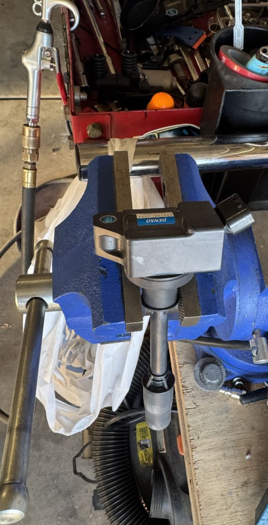

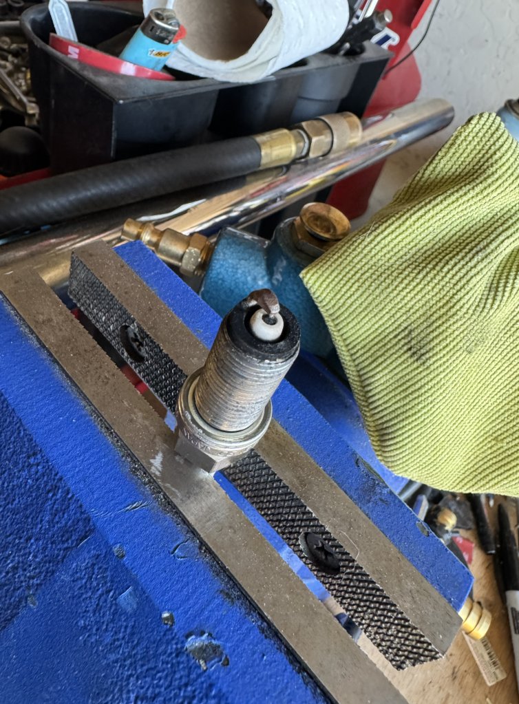

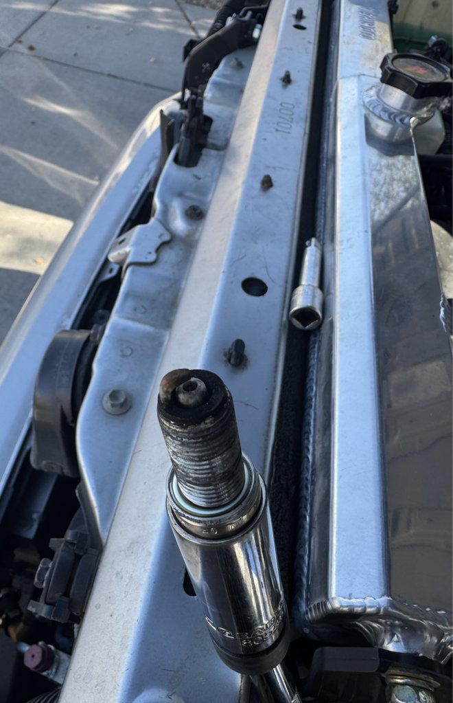

    Got some logs, had misses on cyl 1,remembered I put a crappy AutoZone accel pedal in. I have had weird idle in neutral & park, put the 143k oem in & the truck feels better & the surging idle is gone.
    Pulled the plug form 1 (that was in 7) it looks better, I cleaned it & put it back. No misfire, got to 9.8LBS.
    Plug in 1 from 7 before cleaning.
    After cleaning.
    Denso coil.
    Maybe......

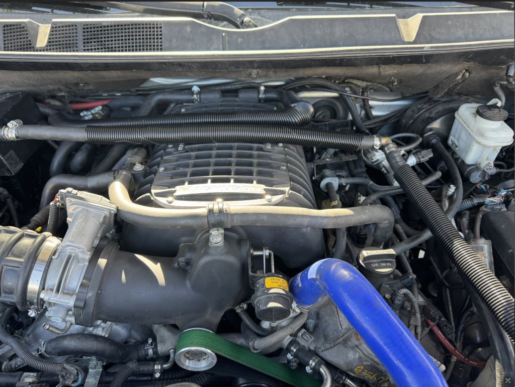

    I finally used the hose protection that came with the 300.00 TRD hose kit.

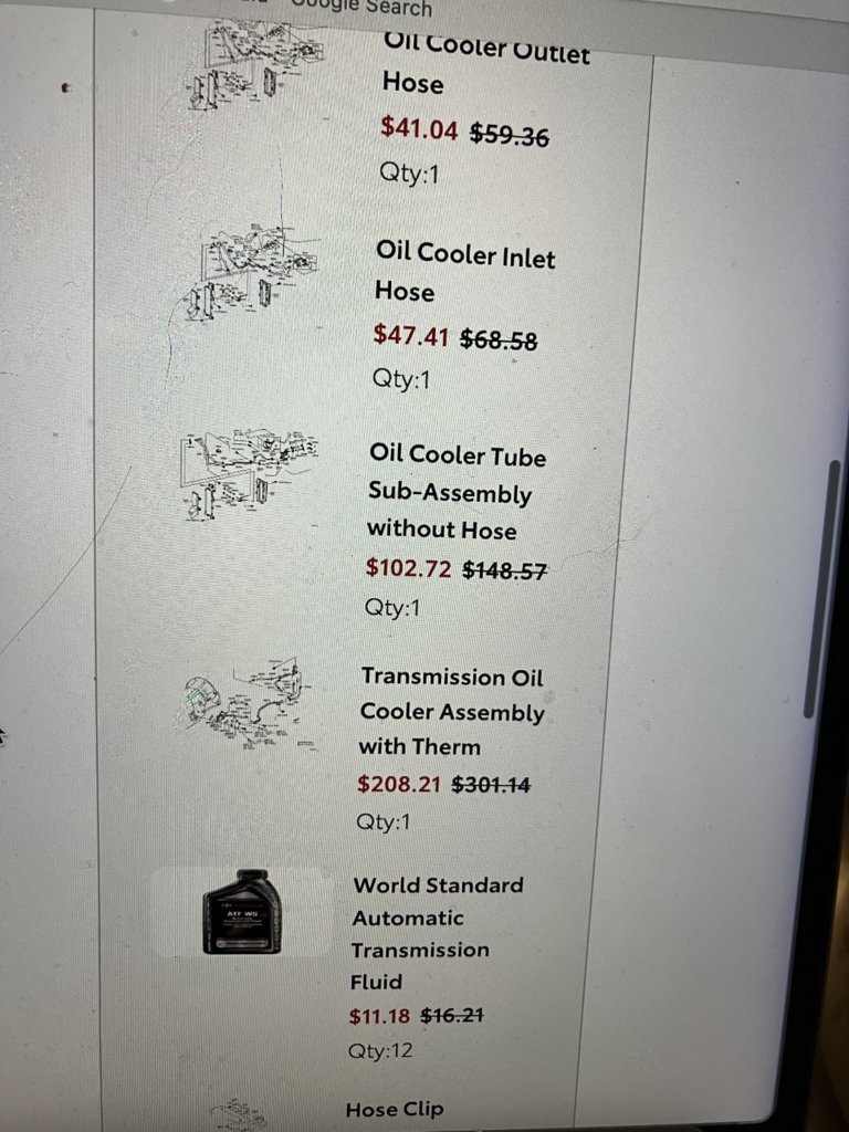

    Hey guys... Looks like Fred Anderson has the 25% off plus free shippping sale going on now in case anyone needs anything...
    Also, for those of you that have done a tranny cooler (which I think is all of you ;)), does this list of parts in my cart appear to be complete for what I need to complete the install... and confirming there's nothing on the list that really isn't needed, correcct???
    Also, it seems weird to me, but Toyota parts website is always strange in how it labels; like the T-stat is called the Oil Cooler Assembly w/T-stat. So, just confirming that's the "thermostat" that everyone purchases for these installs and not a 'complete' OE trans cooler (like I have on my '08), right???
    Finally, should 12qts of fluid get me through this intall w/a drain n fill, plus have enough to complete another drain n fill down the road??

    But 12qts should be more than plenty for 2 drain n fills.
