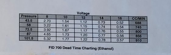

    These are the voltages for the ProSpeed injectors I sold you, at 70PSI they are essentially closer to 800cc

    On the old motor it was at 52 or so, with the new one it is over 70, Sniv said leave it alone so I did. :p

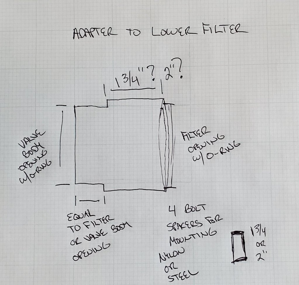

    @snivilous @Jowett
    For the deeper PML and B&M pan to lower filter deeper. Is it easy to chuck a piece of aluminum pipe in a lathe and reduce outside and inside openings to accommodate the valve body and filter. Not sure on length and transmission pumps ability to pull lower?
    Fab up some spacers for longer bolts.
    Thoughts?
    Excuse my piss poor drawing and lack of opening measurements as I don't have a filter to grab the measurements.

    Don't see why that wouldn't work.
    You could also put a nozzle extension on the filter itself, not sure of a nice way to go about that besides tapping into the filter which seems undesirable, flip side is if there's any issue with the extension sealing you'll still pick up fluid unlike the top side extension.
    If you can grab dimensions I can throw something on the lathe this week.

    The suction side is an oval shape. Unless someone 3d prints and adapter and use fipg/rivets to secure it in place?
    I thought of cutting the old filter suction apart and that would give maybe 3/4 inch extra.
    I'll see if the old filter is in the trash...thanks!

    I can cut a bottom side extension on the mill too. I definitely think the top side extension is the most straightforward, but food for thought is all.

    Needs an O-ring for the top side of the adapter, too.
    Will the baffles clear the filter in the new the lower position?

    Well I pulled the pan and the filter pickup I have sticks down about .75 inch from filter body. Now if using a WIX it is flush so avoid aftermarket or ensure it has the extended pickup. This is right above the baffles center opening. The pickup sits 3 inches down from the body, by drain. Front baffles are 2 inches tall for front and 1.75 tall for rear. Filter pickup is just forward of rear baffles about 3/8 of an inch above forward edge of rear baffles. The filter pickup sits about 1 inch below the check level drain.
    I don't think we need to extend it. One could make a 1/2 to 3/4 extension but is it necessary? I'm good...I think?
    Valve body diameter is 1.435 inches x .26 deep if needed for B&M pan.
