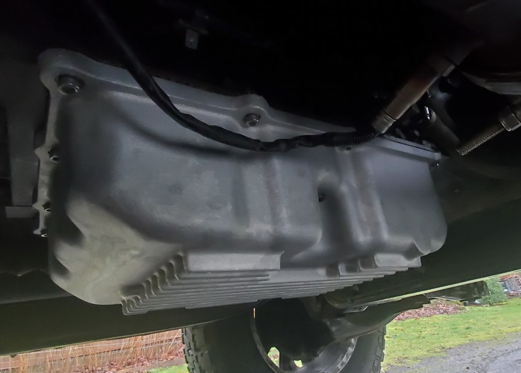

    @snivilous this is similar to what I was trying to explain. Not sure if you can look at my initial read file and first tune you wrote for me it disappeared. Only thing that comes to mind is fueling @texoma or some sort of torque management or ???

    Got the PML pan installed. Will have to finish up when I get back home later on.

    How hard was it to get the bolts out?

    It was easy. I've removed my pan quite a few times...no rust.

    What did you seal it with?

    I debated between just using the cork or fipg. I wound up just using the cork.

    I'm sure the cork is fine. I also have a pan to install. With the PML sitting lower, is anyone else concerned about the pickup being higher than how Toyota designed it? Ideally, it would be sitting close to the bottom of the pan. I think @Jowett has brought this up before. Could this have detrimental effects?

    The check level is at the same height as stock so the filter pick up will be submerged. I was going to try to extend the pickup but didn't have anything to try. I did cut the pickup off my old filter and thought of trying seal attach it an extra inch down. And I thought I could wait for @Jowett to engineer something. :rolleyes:

    If there was no concern about the pick up grabbing air, then PML wouldn’t have placed baffles in there. Should we worry about it? Most of the time it’s likely just fine… but designing without considering the extremes, no matter how remote the chance of occurrence, is eventually asking for trouble. I say dry sump everything!

    The PML and B&M pans have been in use for a while. Haven't heard of any issues.

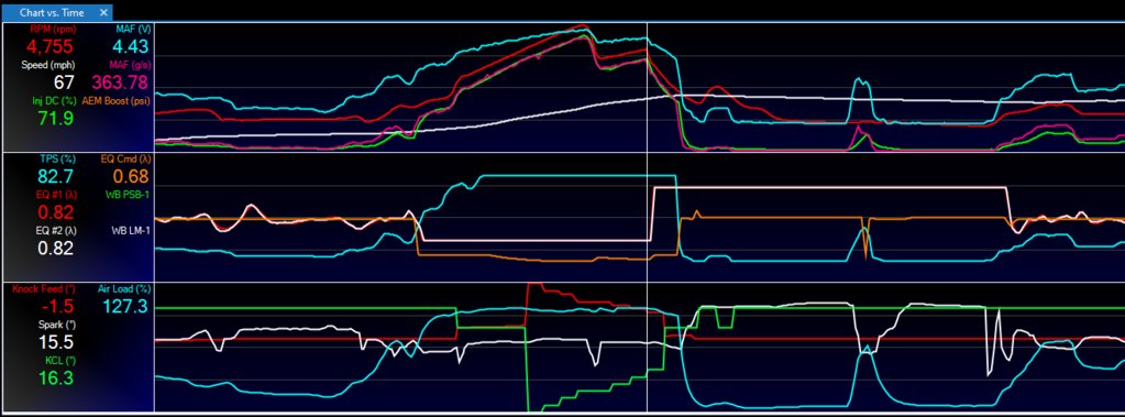

    I think it is fuel pressure! Still very preliminary, but the guy somehow got it to log today, said he hit repoll a dozen times and all of a sudden everything was reading.
    This seems to be the moment it cuts out, accelerator pedal, TPS, timing, MAF, injectors, etc. all look normal but shortly after the rpms drop the AFR spikes full lean, and we can see he gives it some gas after and everything except AFR responds, and then a second attempt later and then AFR goes normal and rpm raises.
    His truck is a FFV, not sure what difference that would make, but somewhere it appears to be losing fuel pressure. Gonna have him try to recreate it again and see if the same thing and logic repeats, and see if he can get a video of fuel pressure when it happens. If that all confirms it then onto troubleshooting root cause.

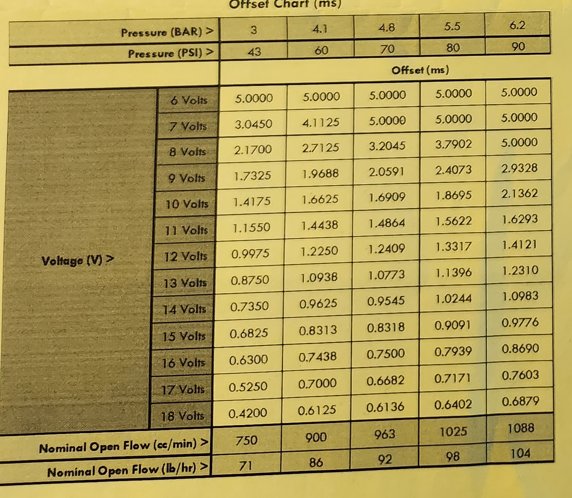

    Is he running in the 43 psi low pressure mode? With the switching valve relay closed it jumps it to 58 psi mode from what I remember.

    I believe in the fuel assembly it caps at 43 psi and 58 or so psi at the rail regulator. The pressure switch valve activated removes the 43 psi restriction, thus allowing the 58psi to take over and limit.......now it's been a while but that how I was able to overcome my fuel issues.

    Can't got also cut the bevel-restrictor off the rail to get to 60psi+?

    I'm over 60 using an adjustible FPR & having removed all the Flex junk/jumping the relay per FiremanDan.

    Didn't you say it was running close to 70? I wonder if that's why your IDC is so low? Because it's at a higher pressure, different injector constants would be needed. Below example of different injector voltages depending on base pressure...or maybe your tune was changed for that pressure?
