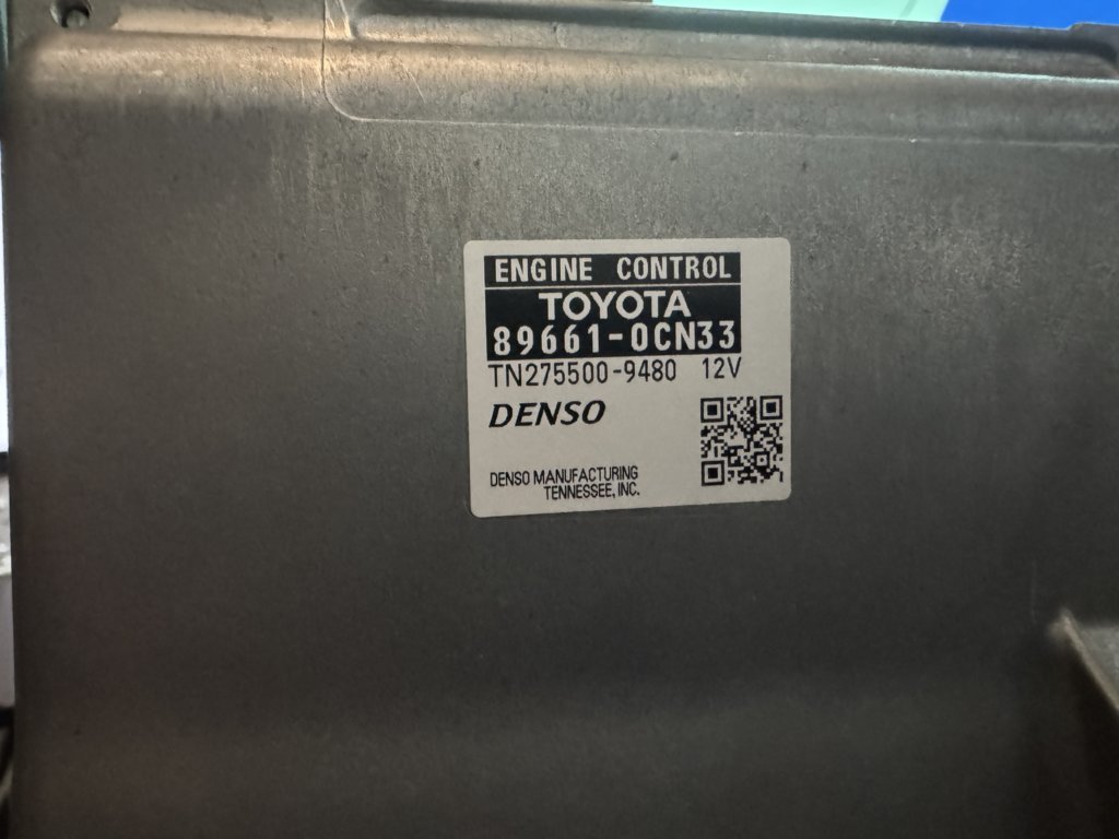

  9. Feb 18, 2025 at 9:51 AM
    e30cabrio
    Oct 20, 2017
    #10410
    6,531
    West Valley, Phoenix, Az.
    Boosted 2013 Sequoia TRD FAUX

  11. Feb 18, 2025 at 10:52 AM
    e30cabrio
    Oct 20, 2017
    #10410
    6,531
    They responded asking for files, they asked me to generate an info log, all that blue button does is open a pane. I sent the previous & new tune & the debug.dat file.
    Mdl likes this.
  12. Feb 18, 2025 at 11:04 AM
    e30cabrio
    Oct 20, 2017
    #10410
    6,531
    Yes, & the solution to not getting anything from info was expand the screen & make that box full screen. Like I knew that. :p
    Mdl[QUOTED] likes this.

    Your Cal ID is 30ck14?

  15. Feb 18, 2025 at 12:34 PM
    e30cabrio
    Oct 20, 2017
    #10410
    6,531
    That's what it says is that bad? They are responding finally, 30 minutes + between responses. I have sent the diag file 2x, reinstalled beta, the program opens to the last file I tried to flash & I can't get it to pen "empty" I'm guessing that is why read goes gray after the dongle is verified & I am able to interact. Waiting for them to respond to that
  16. Feb 18, 2025 at 12:48 PM
    e30cabrio
    Oct 20, 2017
    #10410
    6,531
    That is the last response, I responded with my flex to not story & cc'd Sniv. We'll see what happens
    The file you sent me has a different OS and VIN than the vehicle you are connected to.
    I am seeing the Write tab available when I open the files.
    Pull a read from the vehicle you are connected to then try to write that read file on. If that writes adjust that read file as needed.

    No, just verifying. I see that it’s a 12-13 Sequoia, w/ tow package, 1400 is 2wd and 1401 is 4wd. Was gonna see if I can find your stick file.

    This ecu has been in there for over a year. Hadn't had a problem. I do know I can't get a freaking break. lol

    What happens if you remove all the tune files from the folder and download a fresh one? Have you been copying the tune file to the other computers when testing?

    Why not update your ECU to the TRD cal 3YWL5800 2wd or 5801 if it’s 4wd? Doesn’t that expand the spark maps and VVT maps a bit more?

    I have blown out the folders on all 4 laptops, I don't have a TRD or other tune other than ones for the old motor & the 2 that won't flash from Sniv from last week, the first one is on it now.

    HPT insists the original VIN ECM is in the truck. It's in my hands so idk.

    The shop would have had to do a flash to make the new ecm match the vin. Maybe that’s what they are saying?

    I replaced the ECU in my garage with Techstream. Paired all my keys.
    I had to buy new credits for the new ECU.
    Toyota Denso 992K, 5TDJW5G18DS085249 30CK67, (4)
    Toyota Denso 992K, 5TDZY5G12CS041260 30CK14, (4)
    1260 is what is in the truck now

    He is saying the FLEX ecm is in the truck but I have it here in my hands. Tune 26 is on the truck.
    You would need a tuner to make the changes or you can just open the files next to each other then copy and paste the tables over. We do not provide tunes or any assistance with tuning.
