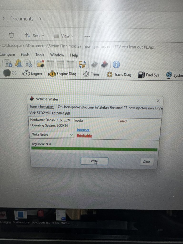

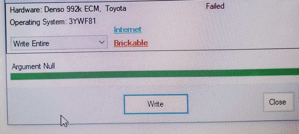

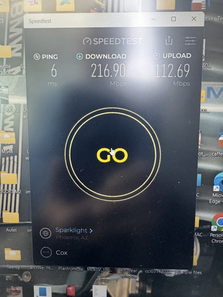

    Can't be my connectivity. Ran an RJ45:
    Same thing : :(

    Try backing up your files, uninstalling, deleting folder, reinstalling
  10. Feb 17, 2025 at 8:06 AM
    e30cabrio
    Oct 20, 2017
    #10410
    6,534
    West Valley, Phoenix, Az.
    Boosted 2013 Sequoia TRD FAUX
    It's happening in 3 computers, I'll give it a try on the one with beta.

    Uninstalled & reinstalled the 3 machines, did a fresh install on a 4th machine. Same damn thing.

    Think you can say it’s not on your side.

    I have a guy in CA that's having issues trying to load a tune. Keeps hanging up and it's frustrating.
    What's interesting months ago I could search argument null and get a few posts on the forum about it. Now nothing.

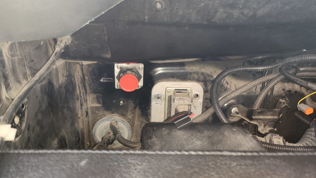

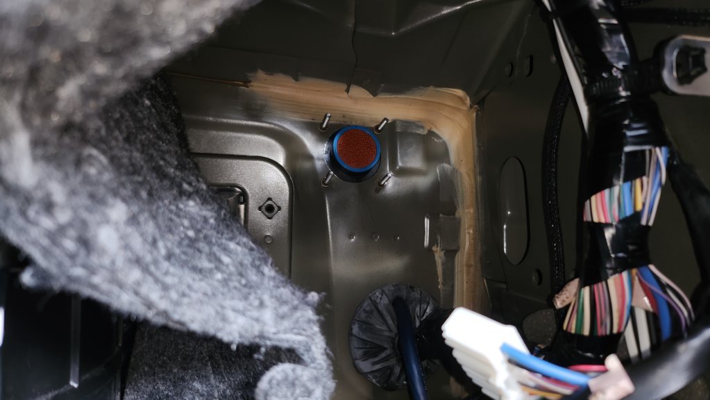

    Finished getting my bulkhead panel mounted, now I have a target for my gauge wiring. I'm also going to move my fuse blocks, relay and ground bar into the cab, as well as the D2A controller. Tons of room to mount stuff to the right side under the dash.
    I made an aluminum panel for the pass-through and used the panel as a guide for the hole saw.
    Panel with fitting and dust cover installed.
    Inside the cab

    Is the blower motor going to be in the way?
    HulkSmurf14 likes this.
  20. Feb 17, 2025 at 2:52 PM
    armyoffoo
    armyoffoo Member
    Jun 4, 2018
    #15876
    1,477
    Cypress, TX
    2018 Black TRD Sport CrewMax
    Supercharged with all the trimmings
    Nah, it's down and to the left of the hole. This comes through right behind the glove box.

    It's HPT servers...

    Forum seems pretty dead, first response to my thread was 22 minutes ago, suggested I try another file (I did yesterday, current tune had the same error)

    What about flashing the stock file? I would do the read download and try to flash that. Course you could get stuck with a N/A tune, but it'd weed out the flashing issue theoretically.
