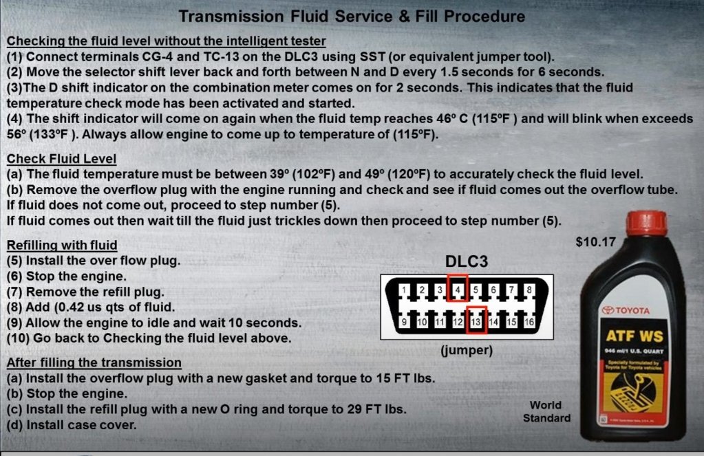

    No codes this morning, it shifts well, shifts into 4LO/HI/ 2WD. I'm afraid they didn't fill the transmission properly. What is the best way to verify the ATF fluid level?

    This is the official procedure, although you can skip the check mode and verify temp with a scan tool, after procedure add 1 qt.

    Level ground. Pin thermostat, start, run through all gears, at 100 deg pull check and look for a light stream not a dribble. If nothing add a 1/2 to quart, cool down and repeat.

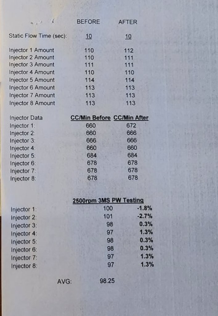

    I just had a customer send me his injector info for the PS 750s and they were measured at like 690cc lmao. Prospeed REALLY rounding up on their claims. Hell even injector clinic or whoever they get their shit from says 725cc and that's already rounded up from every spec sheet flow test I've seen.

    This is what Army sent me on the injectors I got.

    FYI, Those cleaning before/after numbers are at 43.5PSI, and the paperwork that came with the injectors had deadtime settings for FID700's. PS claims they are 750cc, but they only flow that much if they have 60PSI of pressure.

    That’s crazy, so really they don’t have much capacity advantage to DW 650s which are rated at 43.5 psi?
    @TurboKits are your 880cc injectors rated that at 43.5psi?

    Their site only list the offset and not flow. One thing I like about the 5-0 750's is they flow that at 43.5 psi on up to 880cc at 60psi. But they are tempermental.

    Coincidence that the TurboKit injectors and the 5-0 are both rated at 880cc? Seems like an oddly specific number to get repeated across manufacturers.

    But the turbokits 880's could be rated higher at as fuel psi increases. I'm sure he'll post the data. I guess with my recent purchases I could of picked up a set of 880's instead but decided to deal with occasional extended starts with the five-O's.

    My PS “750” injectors are about 726 average. It’s like when you’re 6’2 but in the WWE you’re 6’5!
