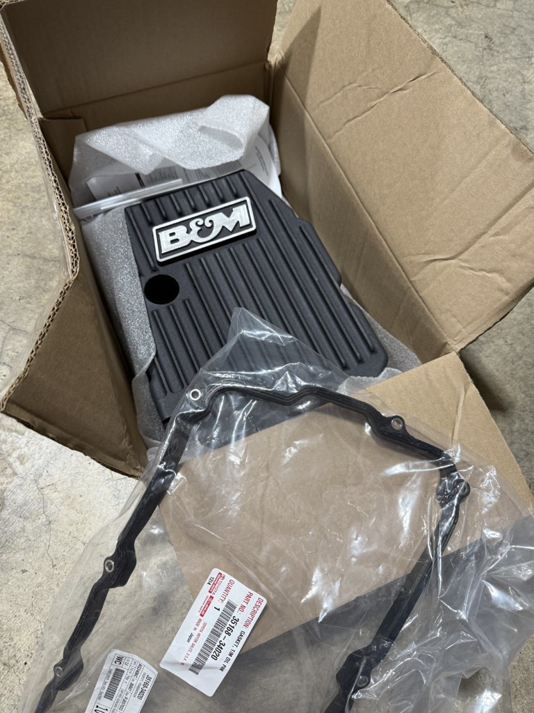

    Do we know if these deep pans fit under skid plates or cat-guards? They're boasting 1.77" more depth than OE...Asking for a friend :anonymous:

    B&M unit does fit under the RCI skids
  23. Feb 4, 2025 at 12:17 PM
    HulkSmurf14

    Do it. I went with this unit since it utilizes the factory gasket.

    That is a plus. I've only replaced my oem pan gasket once in 14 years of owning it. That was only for my new transmission. $30 for PML cork or just use fipg...decisions!
