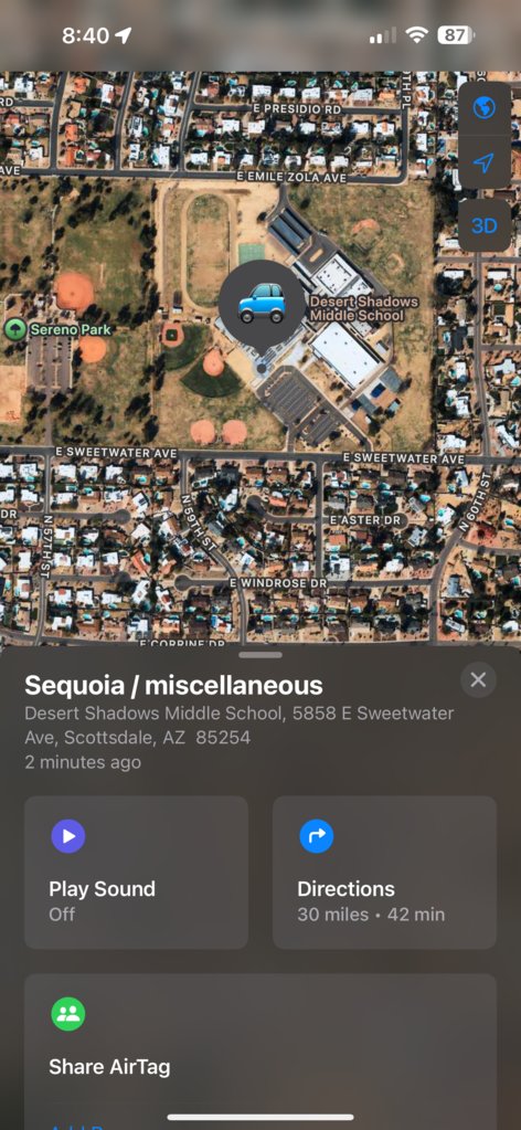

    It's actually 20 miles:D

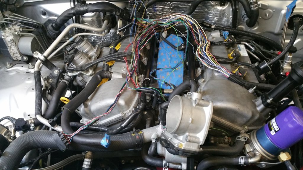

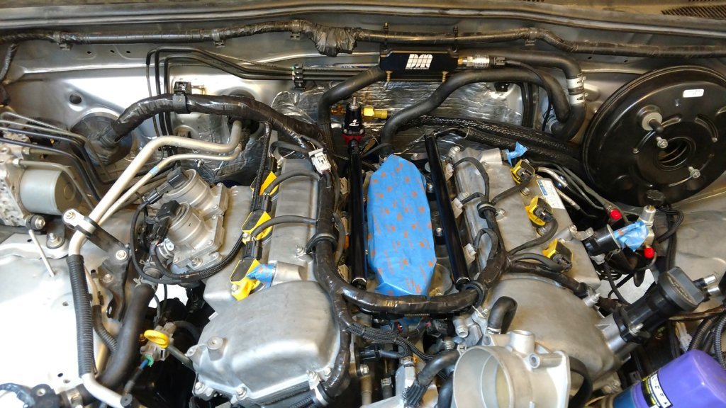

    Unwrap the electrical tape from the harness on the passenger valve cover, take the convoluted tubing off the wiring bundle and visually inspect the wires. When you are taking the tubing off, use electrical tape or zip ties to keep the bundle in it's original shape.
    When inspecting the wiring look for any creases or stretch marks on the sheathing, as well as looking for torn sheathing and exposed copper. There are probably combined grounds in the bundle as well that could have been damaged/disconnected.
    If you find a damaged wire, cut out the damaged portion and replace with same gauge wiring using crimps and heat shrink. Rinse and repeat until you don't have any damage left. Then test before putting the tubing back on, and wrap it back up in electrical tape.
    Take it one wire at a time, and you can do anything! Below is where I re-routed half of my engine harness on my Tacoma just so I would have room to mount the FPR on the rail. Shortened, lengthened, soldered, all wrapped up in self-vulcanizing tape and water-tight. BTW, I'm no wiring expert, everything I know is because I decided I'd see if I could do it, most of the time I was right...
